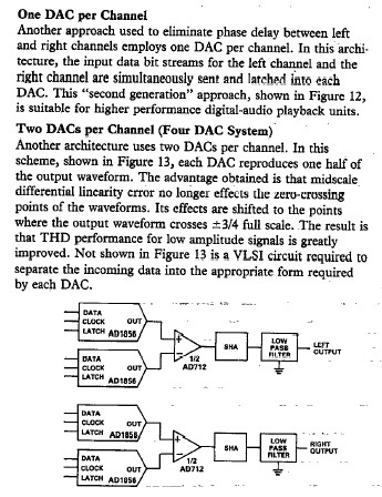

rfbrw said:
When using separate DAC for each halfwave you can get rid of the crossover distortion. The technique is used in PCM1702 and PCM1704.
The low level distortion will be less because of the better crossover behaviour.
So theoretically there is a god reason using 1 DAC for each half wave.
BTW
This is only the case when using multibit DAC's.
Most of the new multibit DAC's also have a technique to minimize crossover distortion, for these DAC's it should be unnecessary to use 1 DAC for each halfwave

Thank you lgrau, but I have been aware of BB's colinear process and the problem it is meant to solve for a few years now.
If you look at the binary 2's complementary digital code that corresponds to +/- FSV, you will see that all the codes increment or decrement in steps of 1 lsb except for the code between highest negative value and bipolar zero where it goes from all 1's to all 0's. This sudden discontinuity contributes to the non-linearity of the device, especially at lower levels where the signal is continuously transitioning around bipolar zero and any non-linearity is a larger component of the signal compared to the higher levels.
Interesting, but to a large extent it solves a problem that has already been solved.
bricolo said:
what's this crossover distortion
Bernhard said:Here it is, from AD1856 datasheet.

rfbrw said:Interesting, but to a large extent it solves a problem that has already been solved.
Not really.
A few people still use some old TDA1541 chips which could make good fortune from that 😉
For the ones that don't know colinear and other techniques mentioned this is a nice read:
http://www.web-ee.com/primers/files/DesignSem5.pdf
