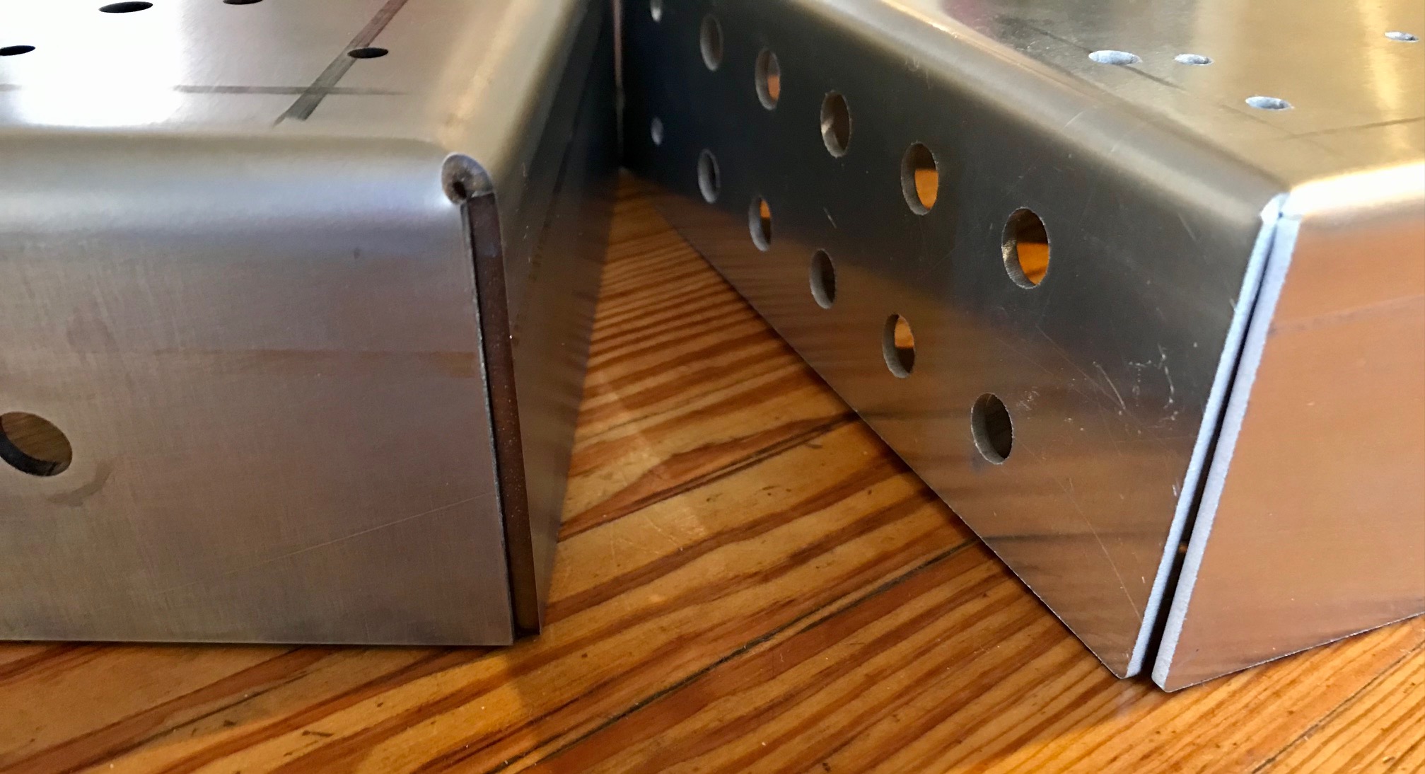

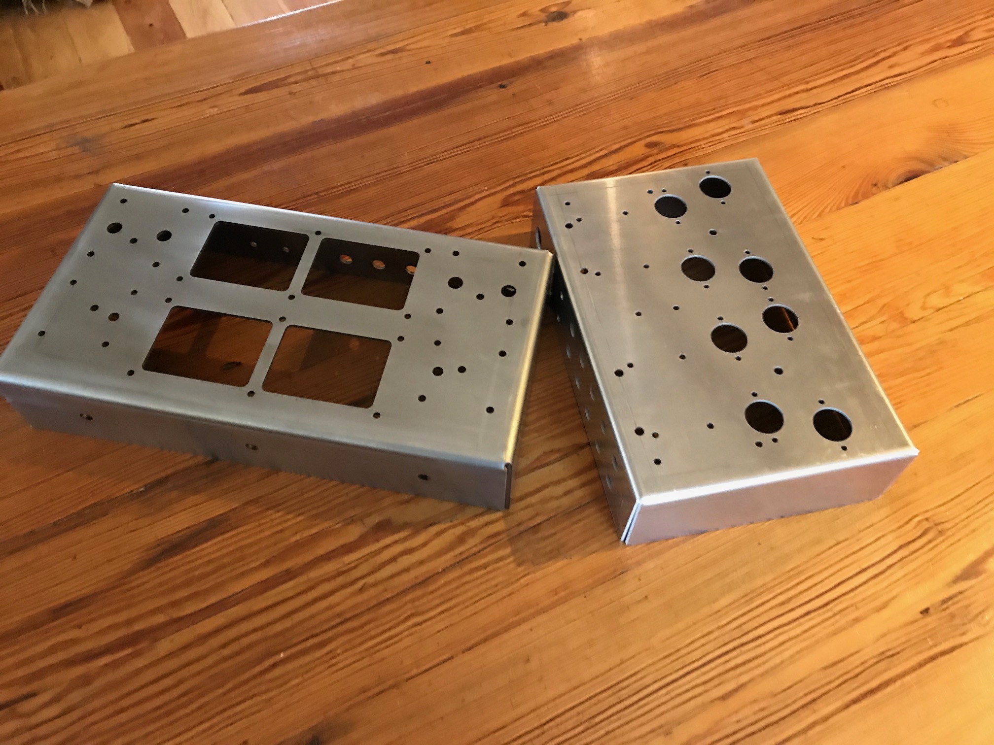

Here are some folded box from SendCutSend. Cheaper and quicker than I would think. Easy to get estimates of the material and thickness of choice. These photos are as I received them. One on left is steel (CRS 0.135"), the one on right aluminum (5052 0.1").

I ordered a pair of the aluminum so that was less than two one-offs. For two it was $98. And $80 for the steel box. If you have a *.dxf file of what you want getting a price quote off the website is easy. So its only a few clicks to change material and thickness to get another quote. Folding adds about $29 for the first piece and comes down quickly if you do two or more.

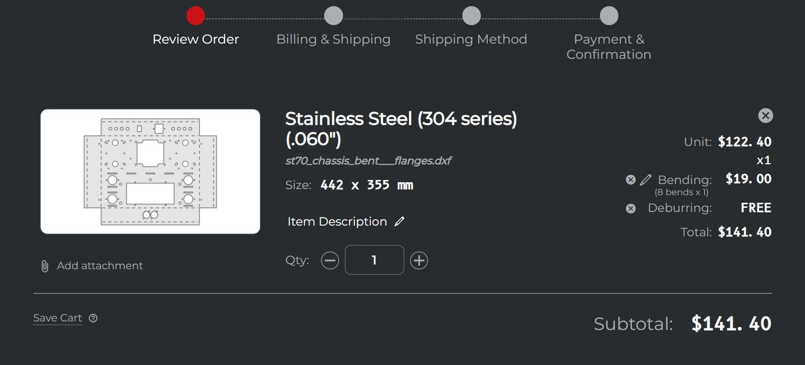

Just what I was looking for! Here is a quote for a dynaco ST70-ish size box. I have not optimized it yet with regards to their bending guidelines and reliefs at the corners of the bends.
Did you find using their guidance on these issues that the box came out the size you were hoping?
