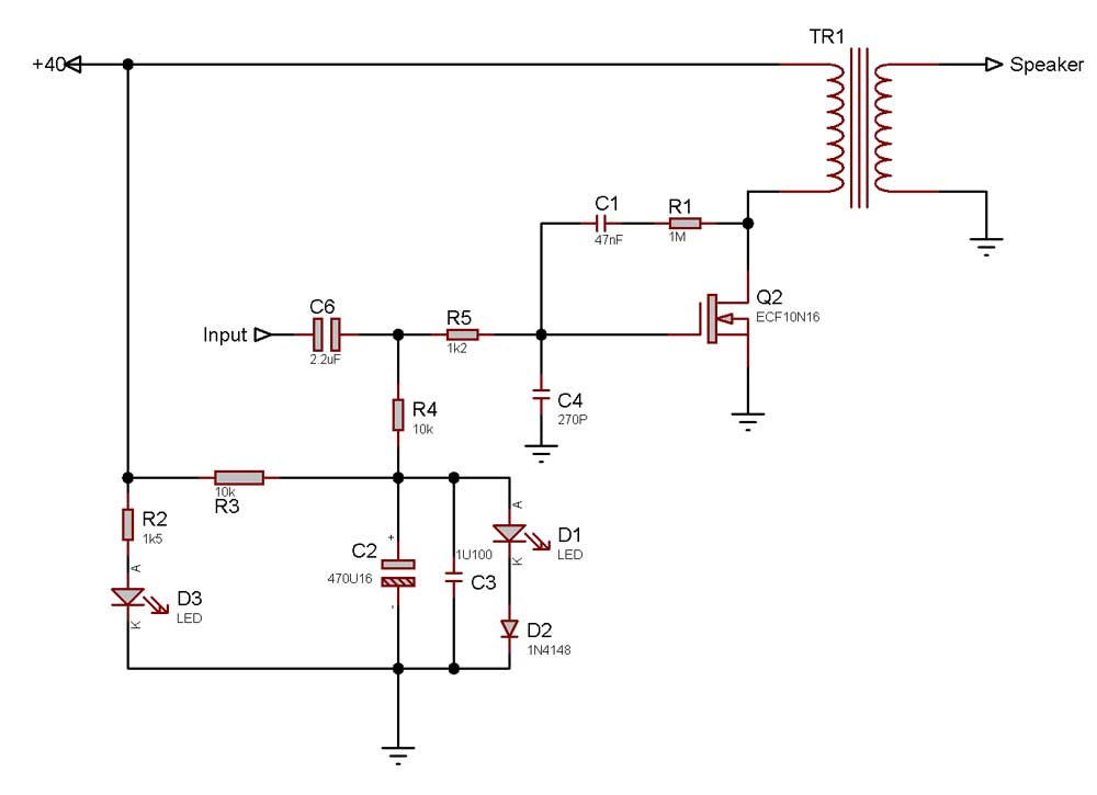

Interesting design. What does that little circuit below R4 do?

bias , what else - just look at BOZ schmtc

Just got over the flu with a fever and my brain isn't all there--confused mosfet with jfet symbol. Sure, that schematic makes all kinds of sense when one get's their symbols correct.
2nd thought being: would we need the bias circuit with a power jfet? The choke load should bias up the transistor.

I was talking this morning with my friend about his own Nemesis project.
He stopped it! It was not possible for him to stopp oscillations in the mhz area.
He said it is difficult to get the right OTP. Looking at the prices for tube OTP, I I will search for other projects:)
all he need is right gate stopper with or without ferrite bead ditto on gate pin , along with adequate cap/resistor combo across primary ;
