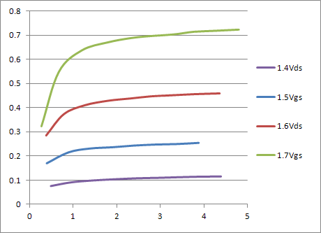

Well, I got a little data today between this and that. Pretty dangerous methodology doing it that way but it took me all morning to get close? That's government, top secret, I can't talk about it stuff. Anyway, I gotta walk up to the equipment, make sure all the FuncGen stuff and voltage stuff is right, etc. and do a few manual triggers on the FuncGen, use the cursor on the scope and get some measurements. Write 'em down. Tweak the amplitude and offset of the FuncGen, reset the sweep on the scope and trigger again etc. Had to refine the test set-up a little... Maybe a little more will still be necessary... The graph I produced needs a few more data points but, between 1Vds to 4Vds I got a promising looking curve. Mabe a little like an LU device 😀 Wasn't actually a curve but I'm gettin there...

Keep plugging away. You should be my beta tester for my next analysis article, which uses software every DIYer will have, but requires quality feedstock data. I've been thinking during long showers how to encourage DIYer's to create feedstock data without using a high dollar curve tracer or letting Zen's gray smoke out. I think you're on to something. 🙂
Unless you plan to use it in F3 like circuit, what is helpful in looking at such a low Vds area. Isn't capacitance non-linearity nasty in this area?

The LU has an "input Cap"(Ciss) of 1150pF. The R100 data sheet calls typical Ciss 670pF!
Although... The LU parameter is spec'ed at some 10V D-S, something like the voltage we might use it at, (although the F3 might be 2.5Vds) whereas the R100 is spec'ed at 100V D-S where us Solid State guy's would probably not 😉
The best I can say is, yes it will be an issue. But, I can't say how much or how much cascode will aliviate the issue. It likely depends on how we attempt any cascode modulation

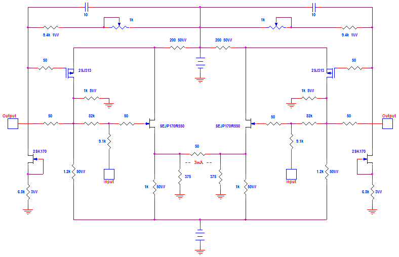

OK buzz, if you don't want to deal with the C of these parts, check out this balanced pre I was workin on some time ago. I avoid the capacitance issue by operating at + and - 80V 😀
It will drive both sides of an F4!

This was basically my attempt at the X1000 -X600 type "UGS" circuit. Just add an F4/ch.
Or maybe a "Balanced Zen Line Stage" with a twist from the 899 patent 😎
Oh yea, what am I sayin. This is my take on the ("zen") cover image of the 899 patent

I recorded enough data points to see that I might have chosen a random sample that has a higher than the typical Vgs value from the data sheet. So, I find from the graph below that we do not see that triode-like curve, as I thought I was seeing yesterday. Hmmmm :apathic:
Sorry about some of the details. X = Vds (V), Y = Ids (A).
