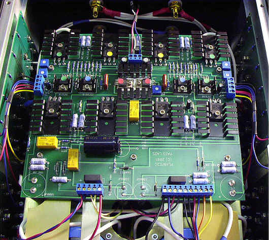

Hey ZM, maybe you could explain what's the difference between my "supersymetry" pre idea and "Ultrasymetry".
You better not tell me to go read the XS lit!
A picture is worth a thousand words 😀
I can go home and find an X-600 pic that looks like my "Supersymetry" 😛😛😛
big mouth as I am , it's tempting ....... but no , no this time - I'll continue embarassing my self in public - with lesser things
if Pa didn't gave details in public - what's that Ultrasecret thing called Ultrasymmetry , I can't give my regular spiegazione de paesano
They look the same don't they?Hey ZM, maybe you could explain what's the difference between my "supersymetry" pre idea and "Ultrasymetry"...
A picture is worth a thousand words 😀 ... 😛😛😛
Ohh, Papa uses an extra pair of nasty gain devices???
Like I said. Tooo compllicated😀
