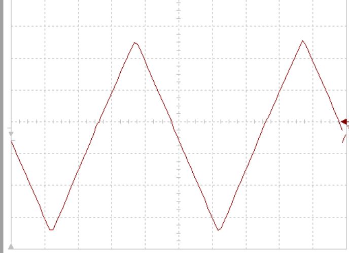

This is output impedance character with 3Ap 10khz triangle injected to the output. You can notice very tiny crossover defect but it is extremely smooth in compared to k1058/j162.
