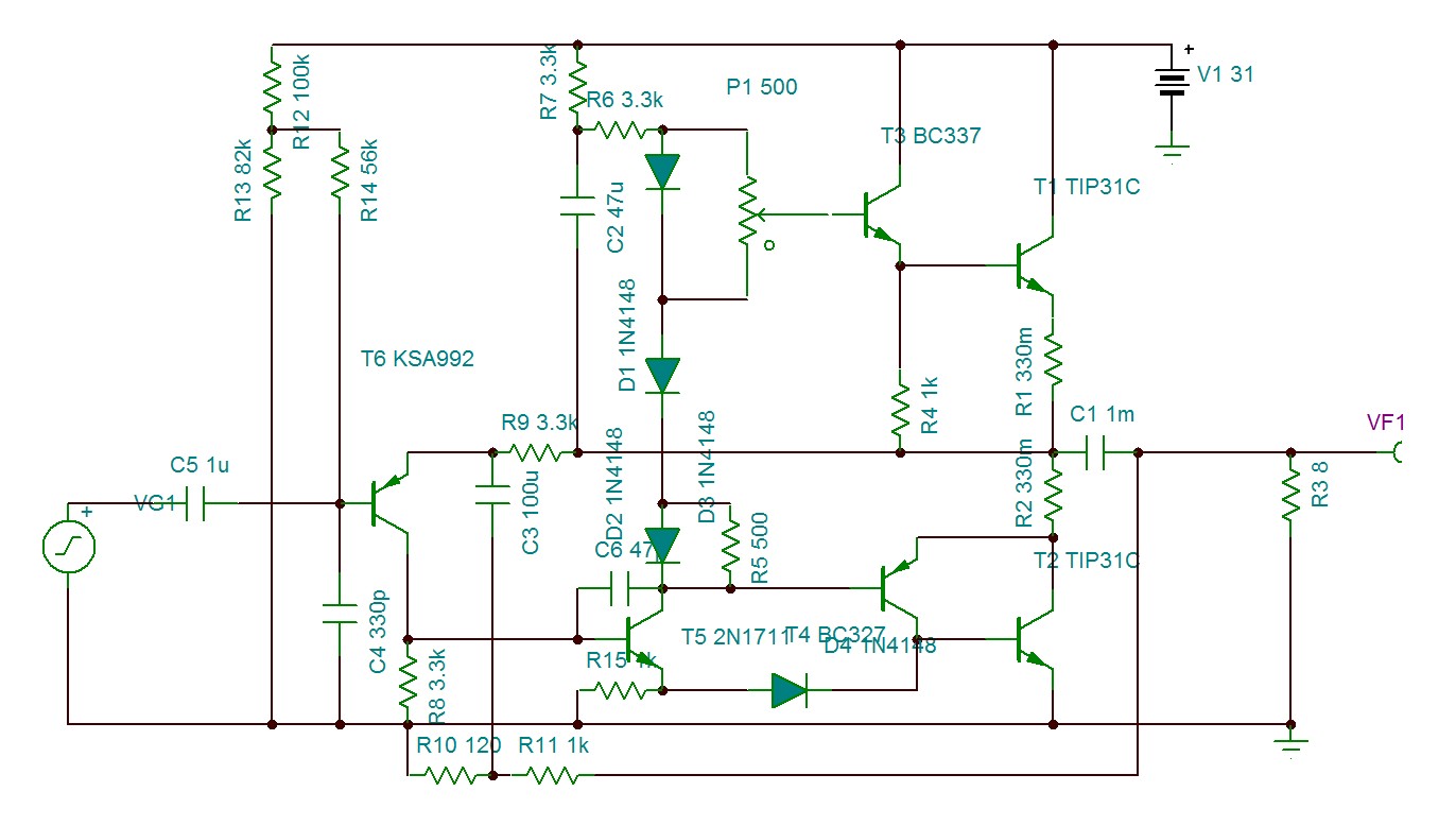

Semi Non-Switching Output Stage of LM3886 Clone

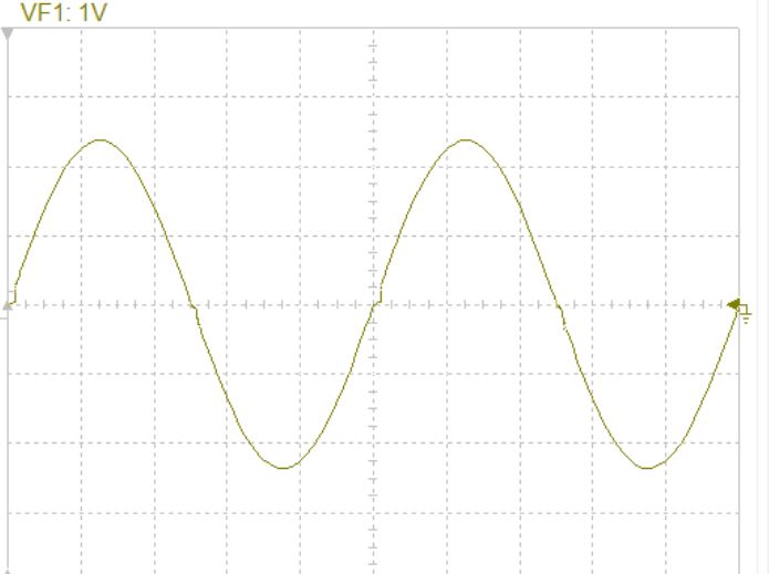

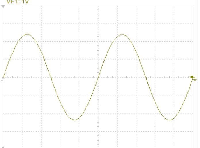

This is output impedance character with 3Ap 10khz triangle injected to the output. You can notice very tiny crossover defect but it is extremely smooth in compared to k1058/j162.
