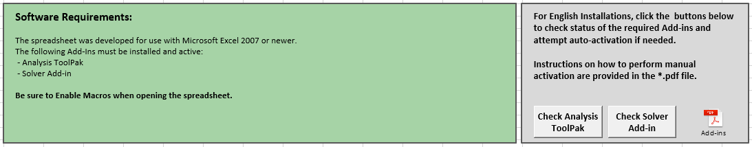

I managed to get the V2 spreadsheet to work in excel 2010 but only after running the V1 spreadsheet. Before that I got an error that the reset solver macro could not be found. Very strange! this happened on two different computers.
Hmmm....maybe not as strange as it appeared...I have a theory.
Note the software requirements include having the "Analysis Tool Pak" and "Solver" add-ins installed and active. Did you do this before running V2? If not, V1 of the spreadsheet checks to see if this is the case, and if not it attempts to activate them for you. Once active in your installation of Excel, they stay active unless you intentionally go and de-select them. V2 of the spreadsheet did not have this auto-activation feature. The reason I removed it was that it only worked if installation language was English. If it wasn't English it would give errors even when the required add-ins were installed and active. So, the spreadsheet was essentially unusable for non-English installations. I was unable to figure out a way around this problem, so removed it. I'm guessing that is what was going on.
V3 which I'm close to posting, will have some additional details on how to install and activate the required add-ins. It will also have a button to click for English installations that will do the activation for you. So, not fully auto-activation, but close for English installations, and will avoid problems with non-English installs. In addition to that, V3 will add FDD(Frequency Dependent Damping) parameters that Hornresp also includes a model for.

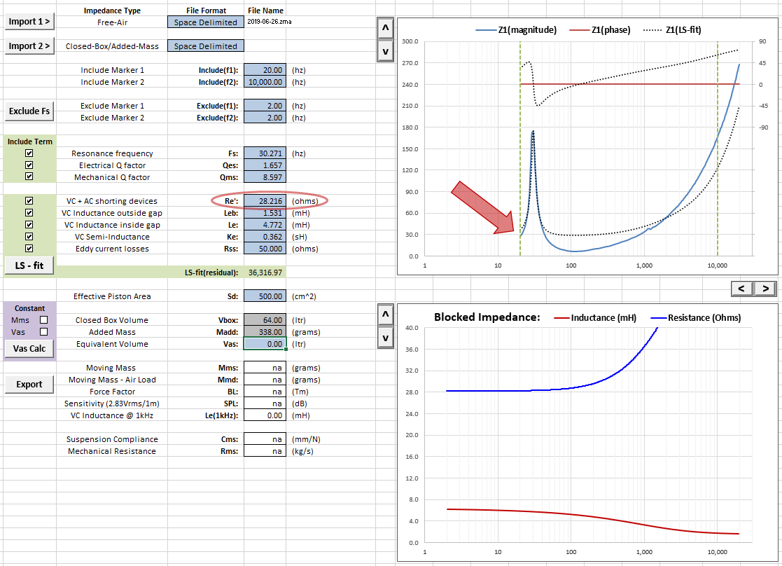

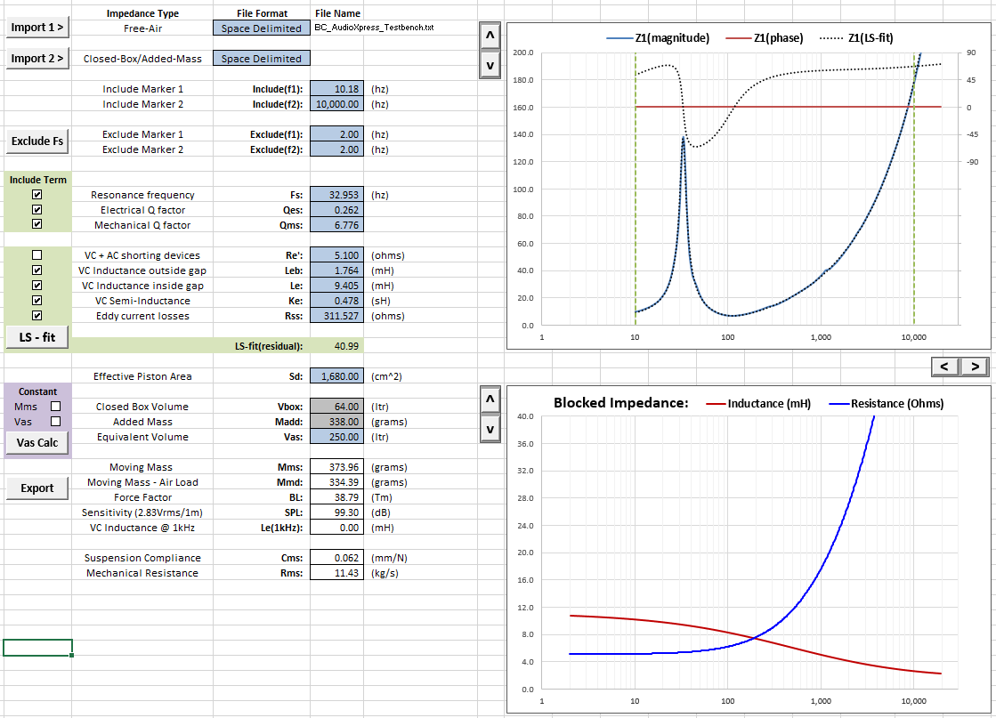

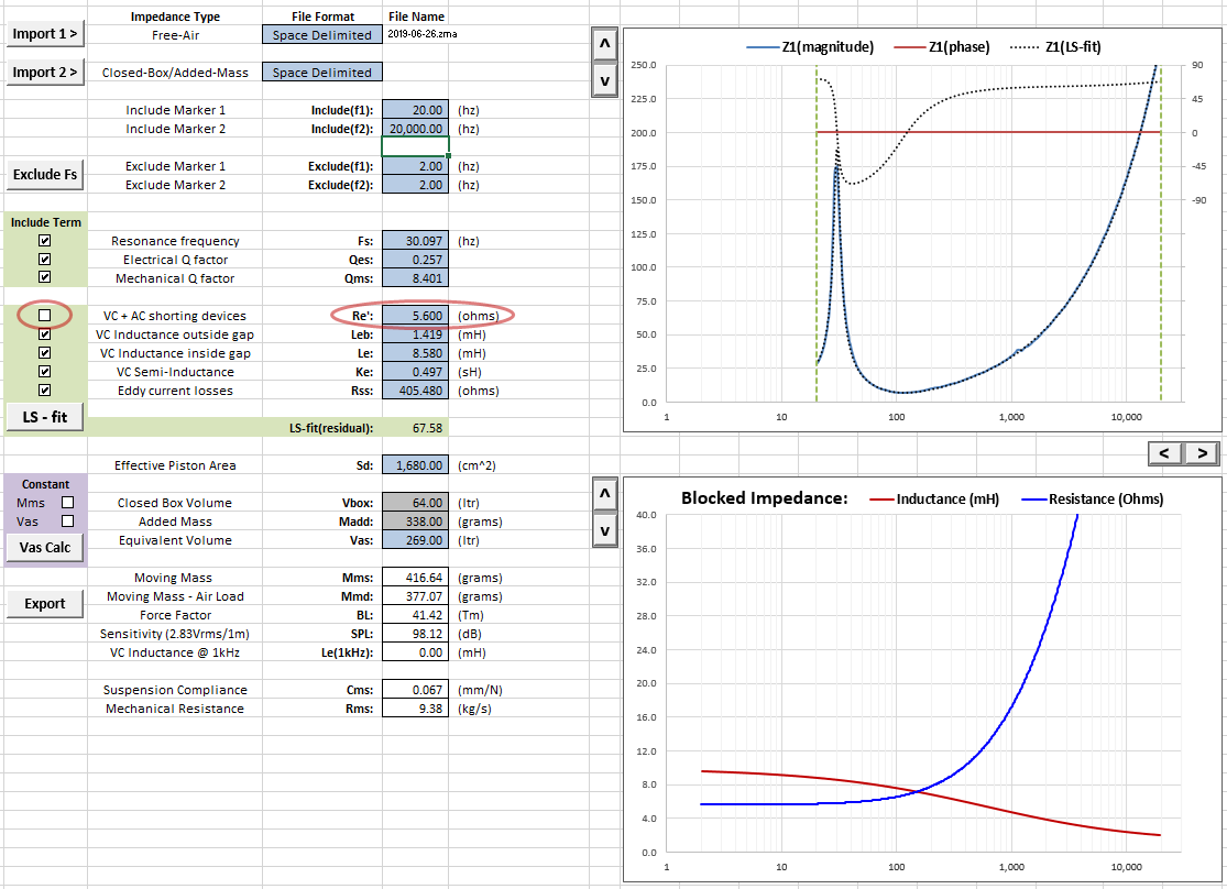

The issue is that there is not enough data below resonance for the curve fitting to converge on a good fit for Re’. I set Re’ = 5.6 (about half-way between DC resistance and minimum impedance above resonance) and then UNchecked the “Include Term” for Re’ so the LS-fit routine wouldn’t change it and achieved a decent fit.
I found another measurement posted online that had a bit more data below resonance and achieved similar results.
Test Bench: B&C Speakers 21DS115 21-Inch Woofer | audioXpress

I will add a check for this issue and have a pop-up window provide suggestion how to work around the problem.
I also noticed that the 1kHz(Le) didn’t populate since the measured data did not include phase. I will add a check for this and use the curve-fit data for populating if measured phase is unavailable.

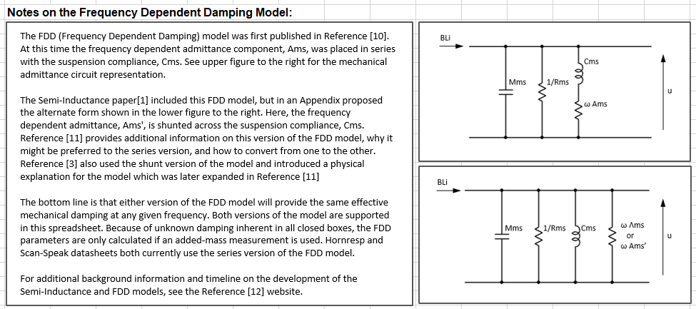

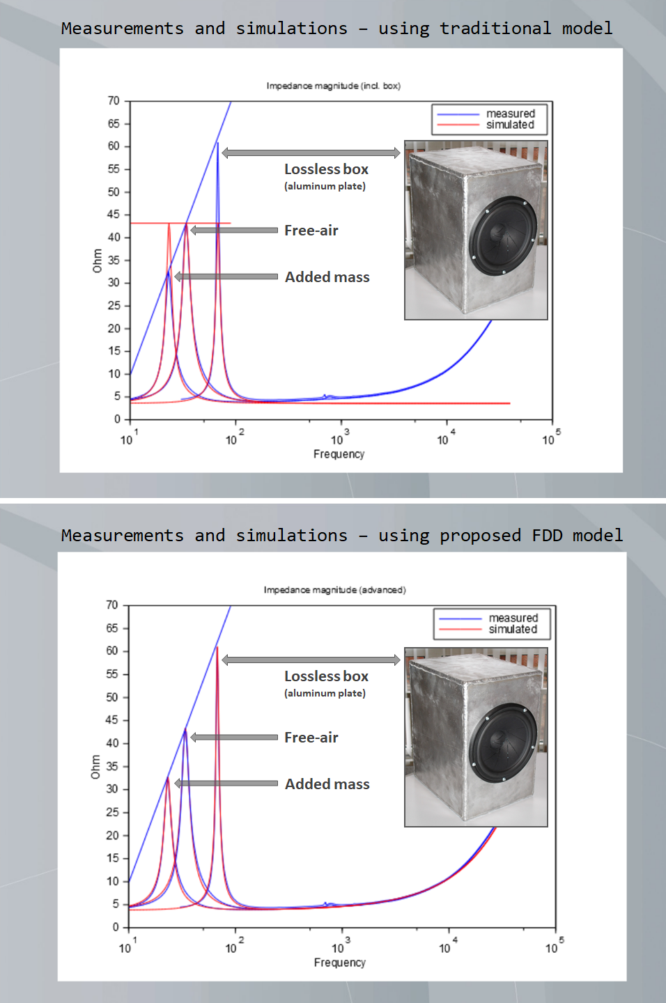

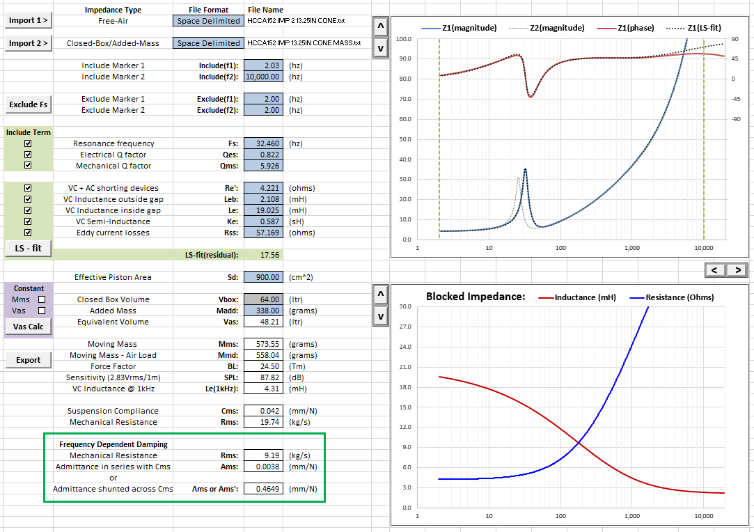

The FDD(Frequency Dependent Damping) models the mechanical damping behavior of the driver(Qms) and how it varies with frequency. Because electrical damping(Qes) provides the majority of damping in modern drivers, including FDD does not significantly change the predicted SPL response. However, the magnitude of the impedance peak(or peaks in higher order enclosures) will significantly change and match better with experimental results. For example, I attached comparisons from an AES presentation on FDD showing 3 impedance curves(free-air, added mass, and extremely rigid aluminum enclosure).
Note that the impedance peak magnitudes for free-air and added mass measurements determine the FDD parameters. If the woofer is not firmly restrained during both measurements, the peak magnitudes will not be properly captured, and will affect the accuracy of the parameters.

Buttons for auto-activating the required Add-ins for English installations were added to the top of the “Directions” TAB along with a *.pdf file with details on manual activation.

cool I had been wondering why my impedance peaks where not matching the models, thanks for the update.
The FDD model does certainly help, especially with the lower impedance peak on vented enclosures which is pretty much always measures lower in magnitude than traditional modeling predicts. But, it is only one piece of the puzzle. The other piece of the puzzle is the damping coming from enclosures that are not ideally stiff. For example, generally when putting a woofer in a well braced wooden box the magnitude of the impedance peak goes down slightly because of the damping from the flexibility of the walls. In the AES example I posted with near lossless aluminum enclosure, the impedance peak is seen to increase in magnitude. Until we figure out how to account for damping from the enclosure(ie not from damping material in the enclosure) the impedance peaks will still not quite match at higher frequencies.

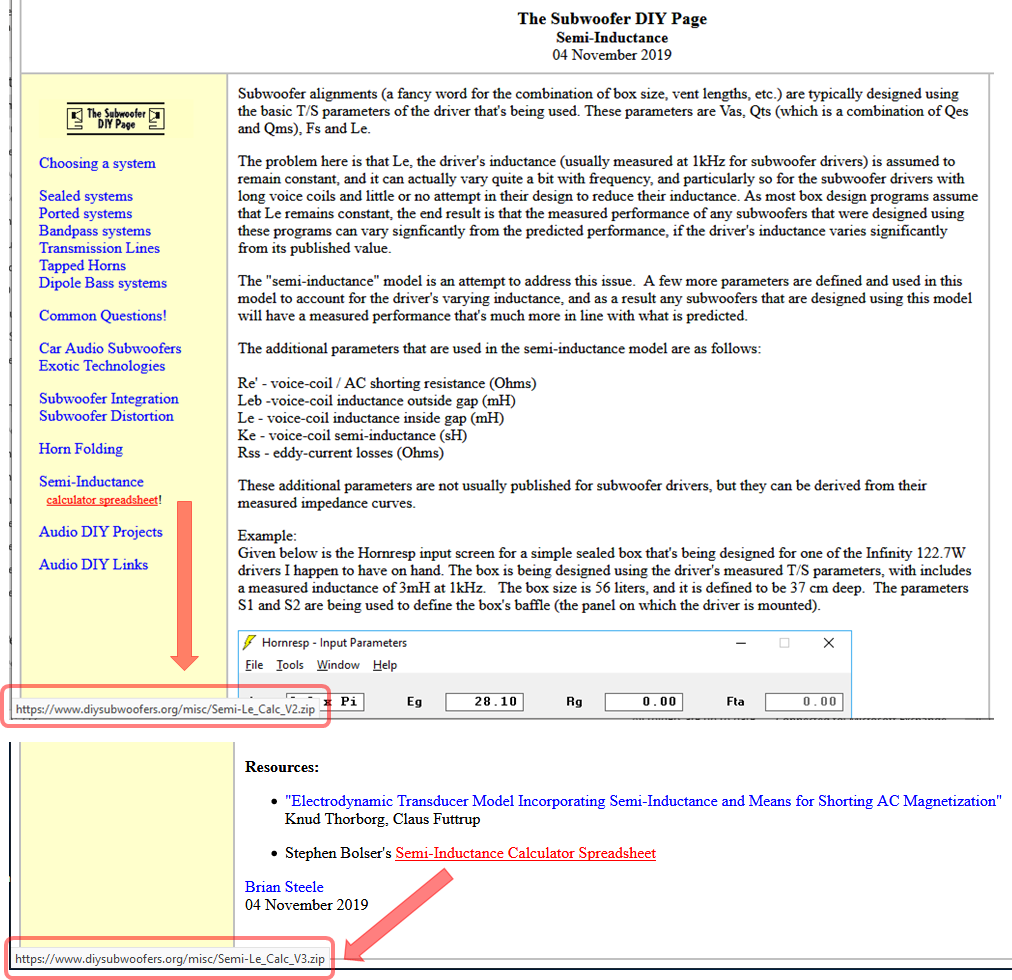

Thanks again for including an alternate home for downloading the Semi-Le spreadsheet on your website. Not sure it it was intentional or not, but just noticed that the link at the bottom of the page points to V3, but the link at the top of the page still points to V2.
