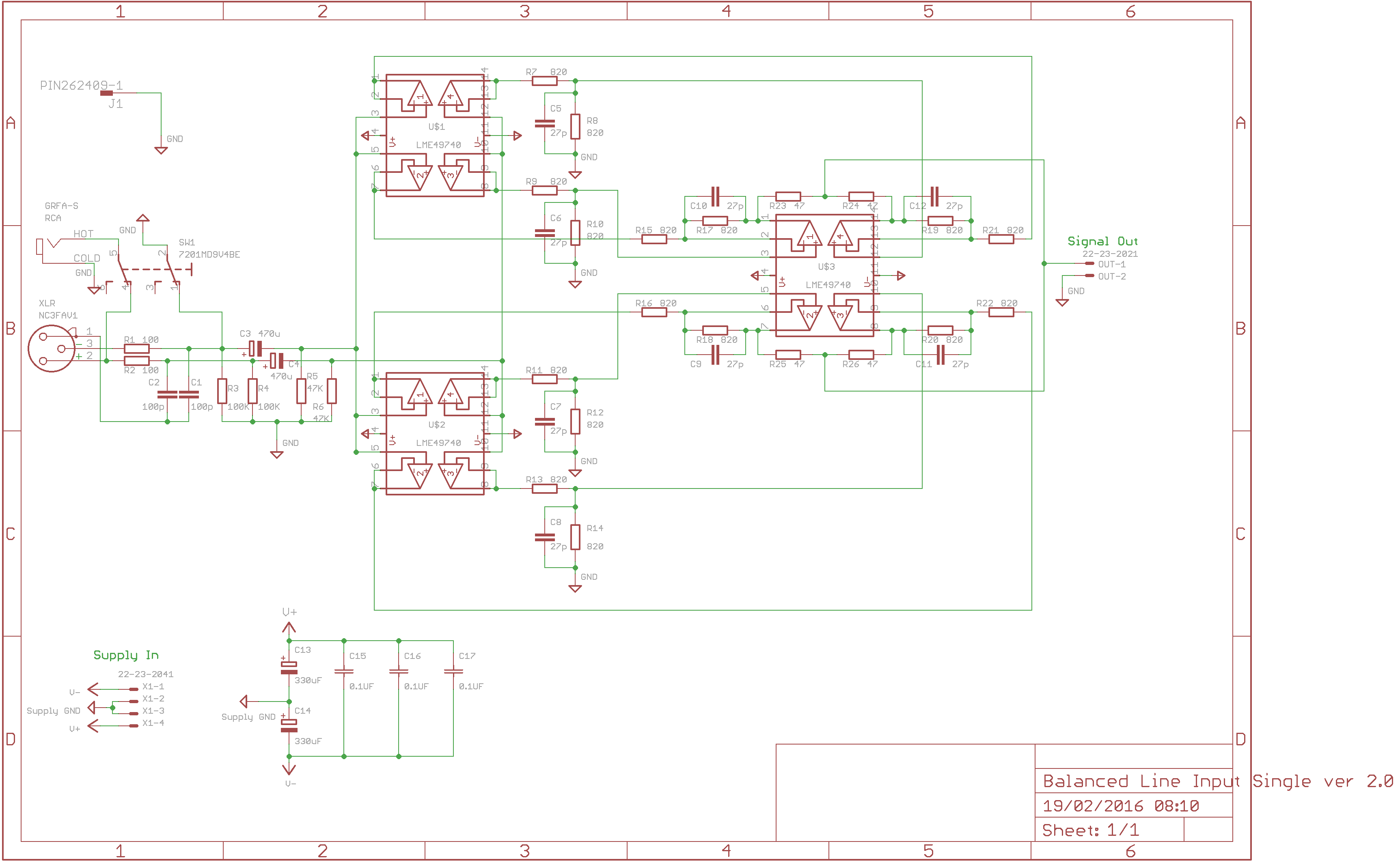

The input socket pin2 is shown connected to ground, twice.....................Signal GND is not tied to PE. The only connection to PE via XLR pin 1 is the initial RF filter, the idea being to not pollute signal ground with any RF noise. (The GND of the supply caps returns to the supply. All other connections are to an isolated Signal Ground.)...............
It's the classic mistake made by nearly everyone that thinks all "grounds" are the same. And then draws the schematic like that.
Pin2 should connect to R2, C3, R5 AND C7
R3 is HBRR/HBRL in D.Joffe's paper. This is ONLY required where one has two (or more) channels inside the same chassis. Monoblocks do not need HBRR/HBRL
The Output needs a voltage reference to the Input, HBRR/HBRL (R3), or a wire/trace link, provides this voltage reference.
There are no chassis/ground/Earth connections to pin2.
Pin 2 is Signal Return and it route needs to be close coupled to the Signal Flow route to minimise LOOP AREA.
Do not take pin2's connection on a journey around the amplifier looking for a ground.

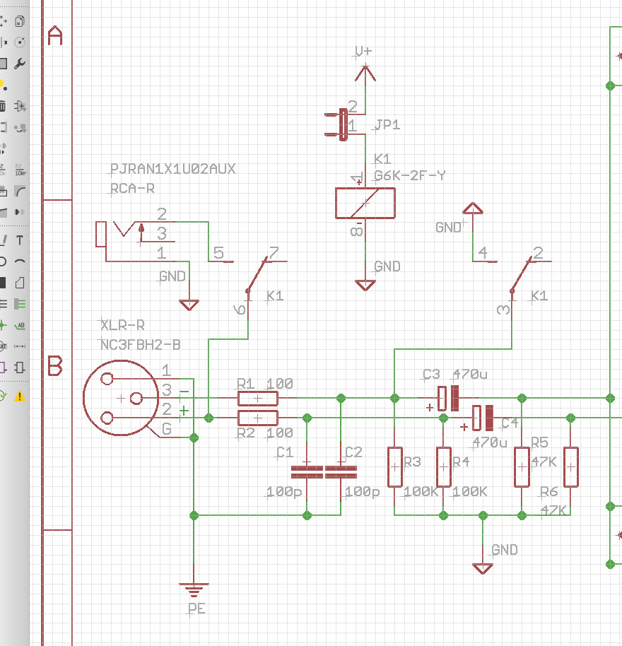

Pin 2 ONLY connects to R2. I don't follow you. Note the question posed in post 1.
Your XLR wiring is not shown in the post56 sch.
You have pin2 of that input socket connected to ground, twice.

What is the purpose of showing the post56 sch.
That is the post that has the pin2 connected to ground twice.
Why did you post that?
am I making a stupid mistake with all this? (Schematic excerpt attached.)

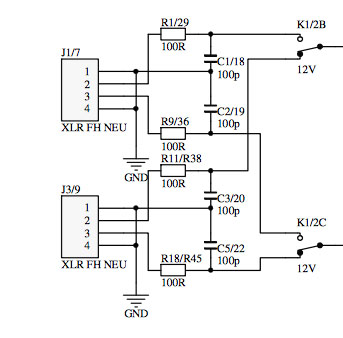

Ah sorry. I replied before you had finished editing your post. The schematic in post 56 is Toni's IPS/VAS. Pin 2 there is signal ground from the output of the input board. Apologies, but I thought it was obvious that I provided an excerpt from Toni's schematic to aid readers thinking about the question I posed about signal current and estimating total current needs of this input board.
Your questions and advice in relation to his schematic are best addressed to Toni.
... and need to know the input impedance of the IPS/VAS that this line receiver is driving. Toni, do you have the latter for your SA2014? Is it basically just the parallel resistance 47k || 8.2k or am I making a stupid mistake with all this? (Schematic excerpt attached.)
Can I take it that you are fine with the connections shown in post 65, the excerpt from my schematic to which this thread relates?
so what do we do with this question?am I making a stupid mistake with all this? (Schematic excerpt attached.)
No. Pin2 is Signal Return. It is NOT ground anything !Pin 2 there is signal ground from the output of the input board.
Ok. My sloppy choice of terminology. Hand smacked. And it connects to pin 2 of my board's output socket which is, in turn connected to the board's plane(s) on the two middle layers. The four differential amplifiers use these as a reference also. Please correct my terminology.

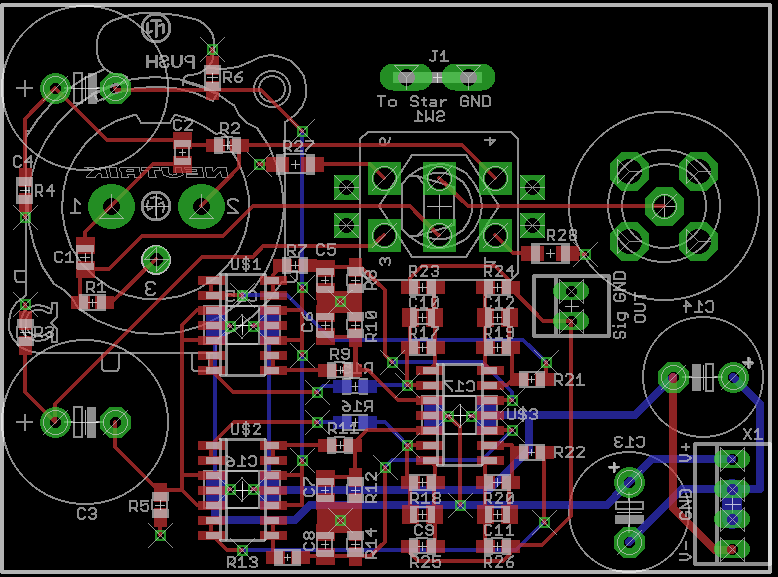

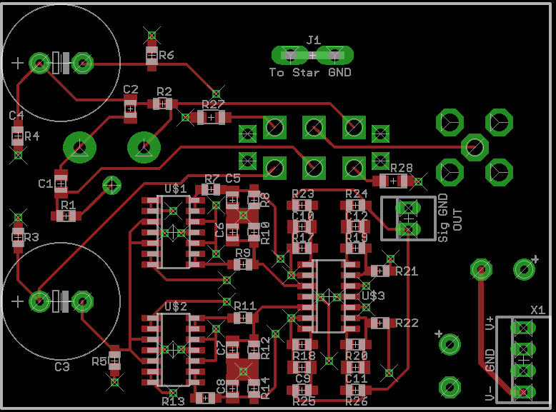

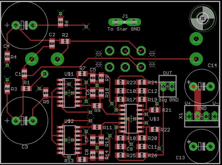

I'm back at this circuit. I changed the layout so that the board fits on the same plane as the connectors (which in turn support the board) and inserted a toggle switch for input selection. I'm just waiting for the PCB footprint of my RCA connector before sending the boards to fab. For now I have added a footprint which would allow soldering solid 1.5mm copper wire connections to a Cardas GRFA-S RCA connector.

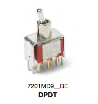

At the moment I have the switch shorting the RCA Hot to signal ground when balanced input is selected. I'm not sure if this is better than leaving it open-circuited. My gut tells me the latter would be preferable as there is then no chance of noise coupling into the GND plane from the RCA connection...
Short it to ground through a 1206 size, 50 ohm resistor. This lets you change your mind later. You can remove the resistor (changing its value to Infinity ohms), you can solder a wire across its terminals (changing its value to Zero ohms), or you can desolder it and replace with any other resistance value you wish, according to the fashion of the times.
Your PCB layout has plenty of room, you could use a socketed thru hole resistor instead, and put on a resistor change-a-thon festival.

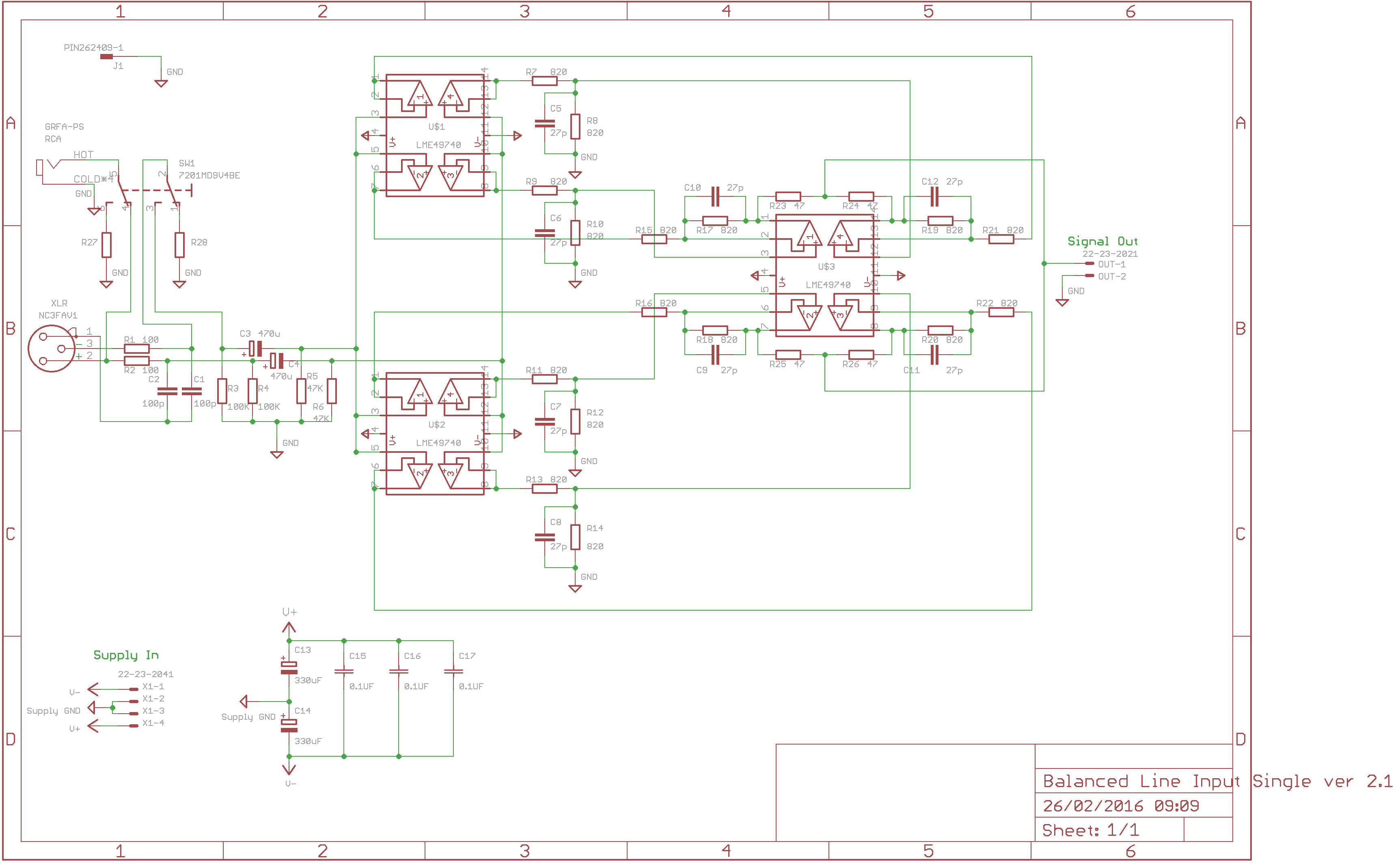

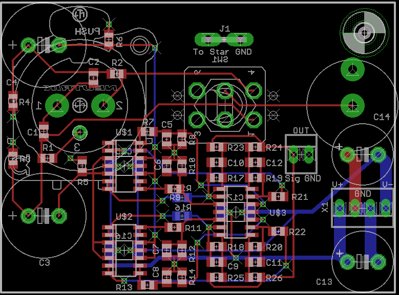

Hopefully this is now ready to go to the board house for fabrication (finally). I made a few changes:
1. I changed the switch routing in relation to XLR pin 3. When the input is switched to single-ended, the input from Pin 3 is now either open circuited or grounded, depending on whether R28 is populated. So it conforms to what I had done with the single-ended input if balanced input was selected. It does, however, make for a longer trace from R1/C1 to the switch and back down to C3 (rather than a more direct connection).
If you guys tell me this is inadvisable I will reverse it. In the first instance I was not planning to populate R27/28 i.e. leaving the unselected input open circuited rather than connected to signal ground.
2. Changed the packages of the 0805 SMD resistors and caps to wave soldering which gives a bit more pad length to make hand soldering that much easier.
3. Finalised the package for the RCA connector to take a Cardas GRFA PS (drawing). This and the XLR connector should support the board nicely.
4. I keep going back and forth regarding solder pads for the frame of the C&K switch versus just holes. (Image attached.) Flicking this switch is the only time the user can place strain on the board's mounting on the XLR and RCA connectors. Initially I was thinking the frame could be removed from the switch altogether but that would seem to require a special tool that can grip the key hole. This draft has solder pads/holes for the frame legs but perhaps I will change them back to just holes as any strain would be mostly lateral.

I would keep pin3 connected, not switchable to open.
Pin2 and Pin3 are the normal balanced impedance input.
When an unbalanced input is required you can still use Pin2 and Pin3. Provided the switch to convert to unbalanced does not open circuit pin3.
Pin2 is always signal Hot.
Pin3 can be signal cold (balanced impedance) or signal return/ground (unbalanced)
If you want RCA in parallel to pins 2 & 3, they don't need to be switched, just left empty. But you do need to ensure that adding the unswitched RCA does not unbalance the impedance, particularly the stray capacitances.
Even the switched RCA must not unbalance the impedances when in balanced impedance mode. Here is where a very small signal relay using the NO pins as the balanced connection minimises the stray capacitance and pay attention to balancing the differences of stray capacitances
Hi Andrew.
Originally all inputs were connected to the signal flow. Jan's suggestion in post 9 was to ground the unused input (the XLR pin 3 path) when single-ended is selected. I added to this the complementary grounding of the single-ended hot input if balanced was selected.
It then occurred to me that rather than grounding unused inputs, which would feed any rubbish coming in from an unused connection into the signal ground plane, it would be better to open circuit them. Mark noted that both options could be worked into the board by adding two resistors. These could be 0R, direct grounding of the particular unused input, grounding via resistance X, or not populated for open-circuiting of unused inputs.
Your suggestion would take me back towards the original position...
Think it through and try to identify the pros and cons.
Then decide which gives the better/best compromise.
This pcb offers all variants so one can decide how to use the RCA input with/without switch ...
Would add some mounting holes and send it to fab.
BR, Toni
BR, Toni

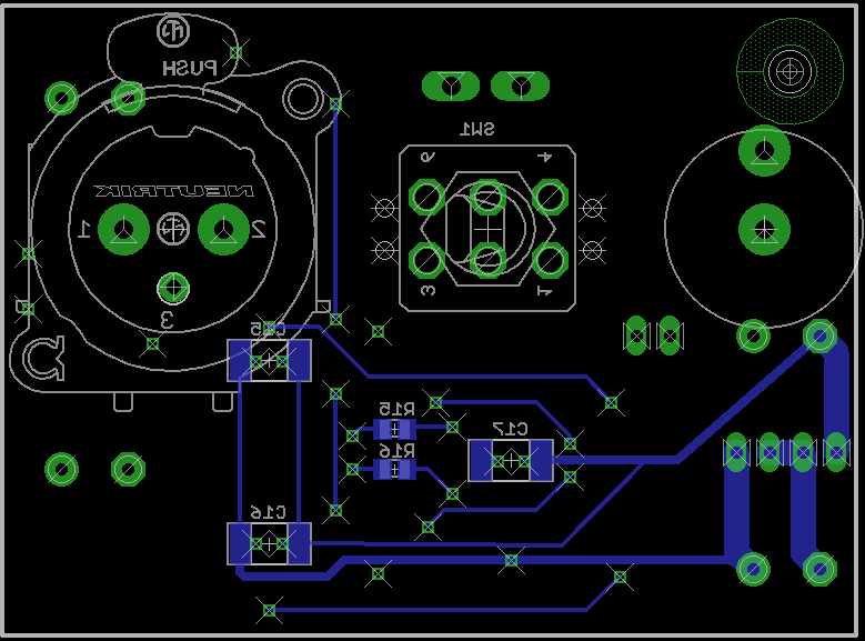

Note the switch is needed/can't be omitted.
I will add some mounting holes top right and bottom left, but the idea is that it doesn't need them. Rather the board is supported by the XLR and RCA connectors.
Thats OK. The mounting holes are for the only case, where one doesn't use the same XLR and RCA connectors ... 😉
