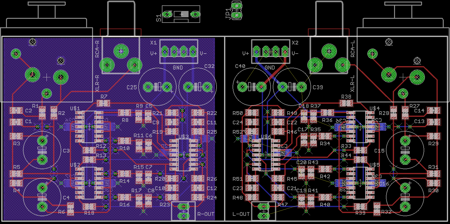

Latest with GND planes drawn for right channel. You can see why I left them off before. There's about 75mil or more gap between components/planes and the v-score mark through the centre of the board. I'll decide at a later point whether to ask the board house to do the v-score (I've never requested this before).
On the grounding of R3-6 (schematic in post 1) I'm inclined to switch them to circuit ground leaving C1 / C2 grounded to the XLR/chassis.

Hi Toni. When I first started the circuit with the quad devices I did as you note above. But then I thought about it some more and decided to split the signals across the two unity gain buffers. If the object of the exercise is to cancel uncorrelated noise then arguably splitting things across the two devices might have some advantages. I suspect this might also be why Self drew Fig 18.28 in such a convoluted way...

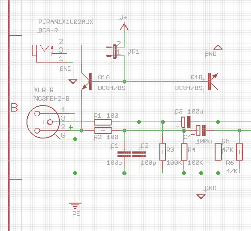

What about this? A simple dual NPN transistor in, say, SOT-363 package coupled with a two pin jumper (through-hole). When the jumper is fitted, both transistors conduct with one connecting SE hot to XLR pin 2 and the other grounding pin 3. Leave the jumper out for balanced operation. If someone wants to replace the jumper with a panel switch the pads are available for the wiring connection. It places a transistor in the SE signal path - does this dictate component choices?

Unfortunately it is not so easy to switch audio signals with such a simple transistor circuit (... and the left transistor would immediately die if the jumper is inserted...).
What I meant is: If SE RCA input is used, the neg. signal pin of XLR input should be shorted to signal ground by a relay. Of course in this case you should not connect any XLR source during SE RCA input mode and vice versa.

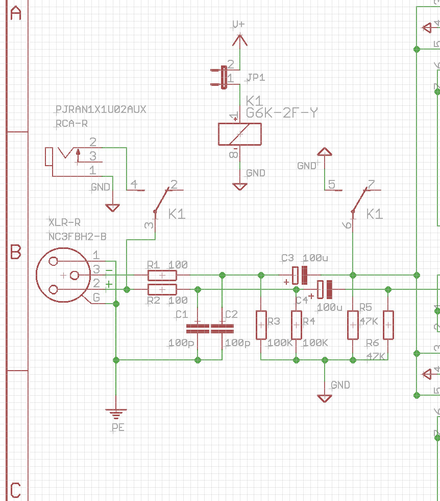

I see my extremely basic error re passing the audio signal from RCA hot. Presumably the right side has the same issue. Before looking for miniature relays I'm hoping Jan gets a response from Mr Self re whether anything at all is required (and whether base stoppers should be added).
Perhaps this little DPDT relay is better suited to the task should switching be necessary
Omron G6K-2F-Y-TR DC12 at Mouser and its data sheet. 10mm x 7.8mm footprint in SMT. Could be mounted on the bottom side of the board.
Jumper in place or closed switch for SE use. Left open for Balanced use. Non latching. Draws about 100mW.

This Variant with relay control looks good. Putting Pin 6 of the relay on the left/pos. side of C3 may be better to avoid any output DC offset caused by shorting R5 to signal ground.
