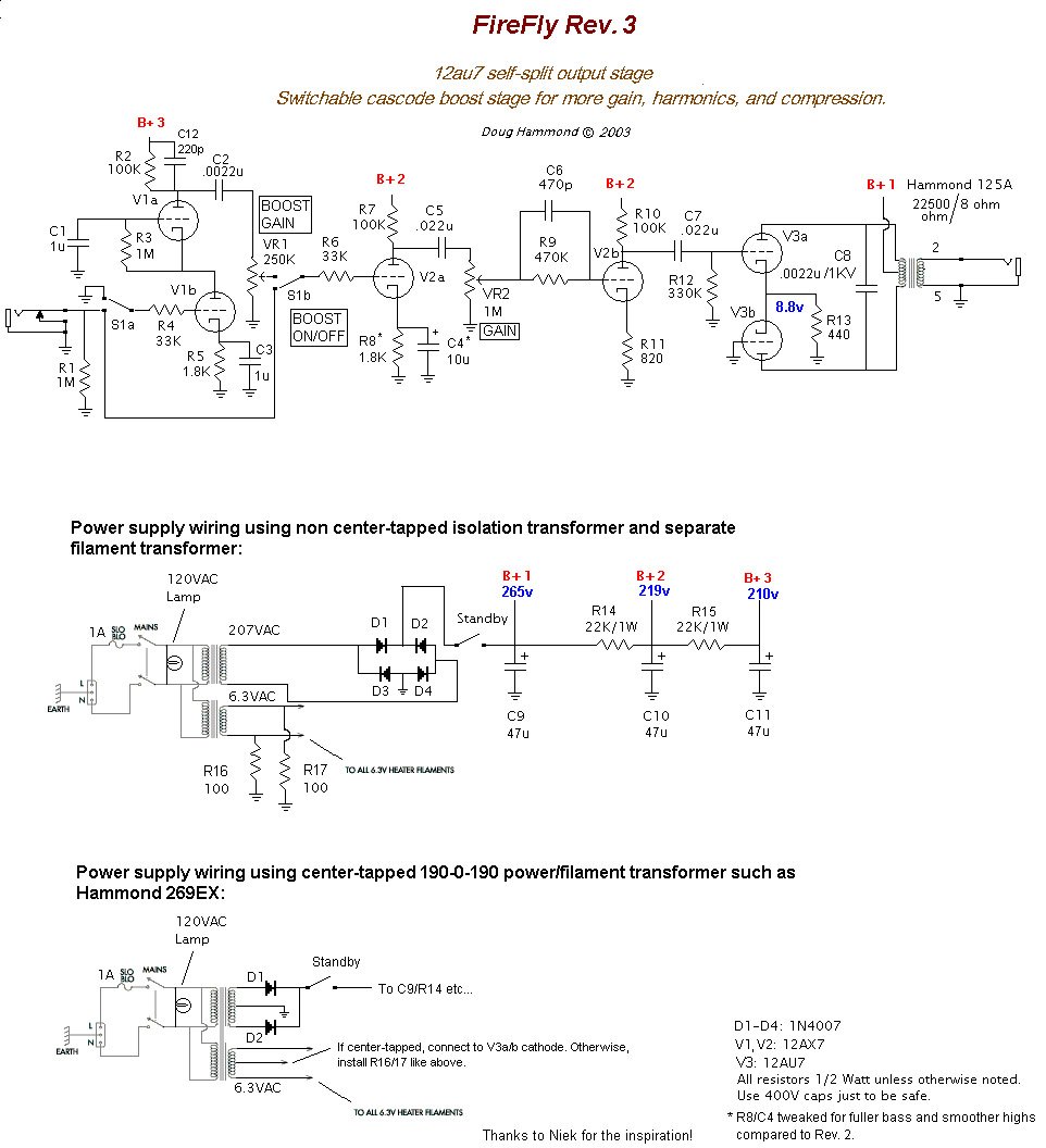

The first time I recall seeing an example of this kind of circuit was thru a rock guitarist friend. It was a simple low powered amp, part of a guitar pedal. There was a sealed box on two leads in the cathode circuit, no phase inverter. After some testing it looked to me that a choke was in that pedal.
Then a circuit showed up on the web, it was a guitar pedal by none other than Doug Hammond himself. A way to sell some Hammond transformers.
Thankyou Jon Snell for your easy to follow description of the self inverting circuit & how it works. Many of those on DIY & the lurkers will find your effort a great help.

Self inverting amplifiers were fairly common in home receivers here in North America during the 40s & 50s for the reasons listed in my note. Maybe not in Europe, but why then the ECLL800 to avoid it?
There have been some amp designs show up where a choke has been used in the power stage cathodes. And perhaps it sounds different, could be the builder simply wanted to try something different.

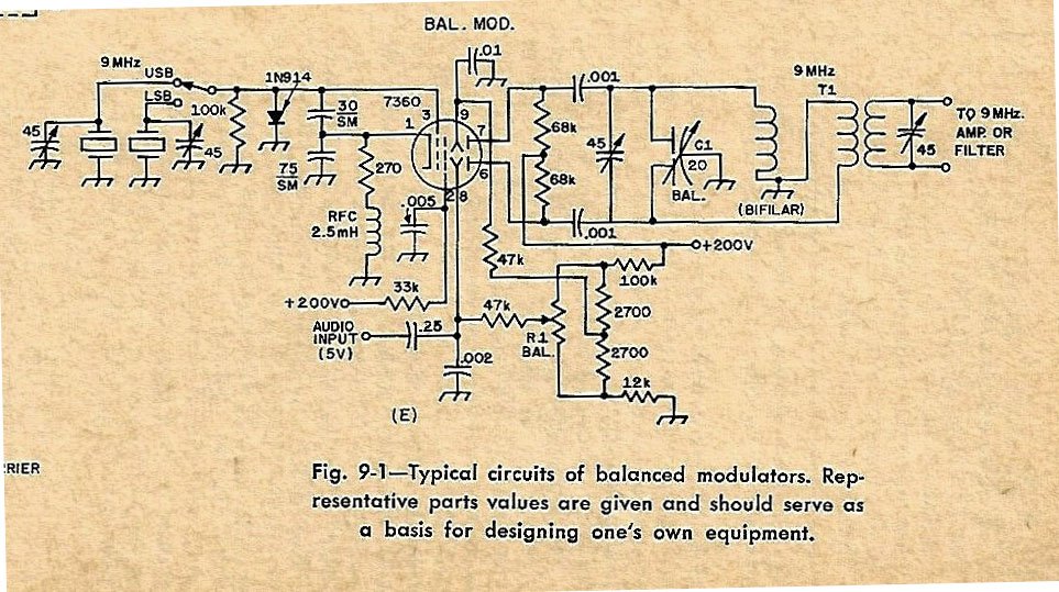

I found the 7360 balanced mixer in the ARRL Handbook of 1971. This one is set for RF of 9 MHz.
Also for George, I think he has an HP 8640, link to HP App Note 171-2, adding the HP 10514A balanced
mixer to get response down to DC. The HP 10514A is a compact balanced mix, four diodes in a ring
& two RF transformers all in a compact package.
https://www.hpmemoryproject.org/an/pdf/an_171-2.pdf
A related product is the HP 10515A, a frequency doubler. Looks like a FW CT rectifier on paper.
Sometines called a Push-Push Doubler.
All way off topic on this forum.
Anybody know what the 3rd Order Intercept is??🙂🙂

The ARRL SSB manual had an article or two on using the 6HW8 BDT tube for phasing SSB, and I recall something like 60dB suppression. The 6JH8 has noticeably better curves than the 6HW8, but this all depends on signal level. The 6JH8, 6HW8, 6AR8, 6ME8 BDT tubes use a neg. splitter plate between the plates, which does not absorb any plate current. The 7360 on the other hand has grid like deflectors IN the beam which do absorb electrons. The 6JH8, 6HW8, 6AR8, 6ME8 BDT tubes should be much quieter than the 7360 tube.
