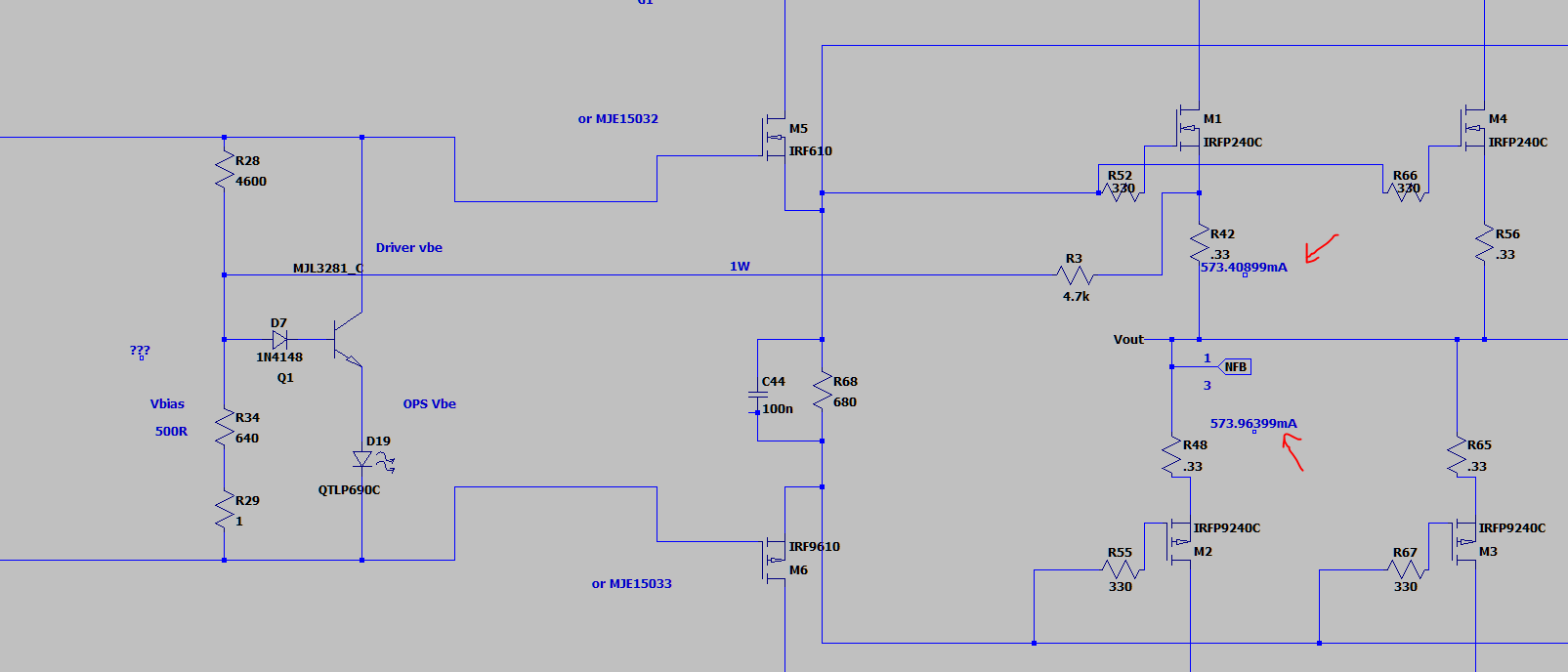

Self Biased steady Class A output stage without Vbe multiplier
the actual problem is that when the room temperature shifts down the idle current fluctuates sometimes goes very low at times. Just need a solid standard fixed value based on the trim pot used. Since want to try various frontends would like to have a OPS with steady class A bias possibility.

Thank you andrew what I am looking at is the bias to be rock solid even for wide room temperature variation.
I guess pass uses more of resistor controlled fixed bias without tracking the output transistor/mosfet idle current through emitter resistor. But I also see him using NTCs in his design to stabilize when temperature is going up and in F5 he is also using Diodes from the rails to conduct when idle current goes beyond certain value.
only thing is that the transistor what you are using is BC550 package TO 92 which again needs clamps instead one can use ksc3503 as we can use a screw mount directly? anything to be varied in values?
If used with mosfet OPS do we require 220uF cap?

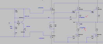

I have tried the above ckt that you have recommended but it seems oscillating even after the resistor values and capacitor values varied. Hence thought why not use a diode as is in the conventional vbe multiplier with the resistor from the output source resistor. It seems working but is there anything to be changed in the ckt attached?

3281 power transistor?
It is mosfet output section

sorry MJ3281 was not used it was either BC550 or Ksc1381 used what is your proposed concept with just diode? especially with mosfets. The challenge here is the bias shouldnt change with ambient room temperature variation. Sometimes it can be 18 deg C and sometimes it can be 33deg C in hot conditions

For a mosfet output stage I’d use Nelson Pass’s opto-coupler method. If you search on that forum or ask the crew over there they can help you. The bias controller I showed is really for bipolar OPS and as you can see from the OPS standing current vs temperature and time, it’s very stable (low single digit % change over temp and time).
The 220uF 6.3 V cap is needed because at LF, when the output swings close to the V+ rail, the bias voltage collapses and distortion goes up. With the cap, you don’t get this.
I’m travelling now but when I get back I’ll see if I can find the NP bias circuit. Basically, you place the emitter diode of the opto across the source degeneration resistors (with appropriate current limiting resistor for the diode) and then use the coupler transistor to directly control the bias voltage to the mosfet gates. You will have to experiment a bit to get the right diode current limiting resistors and you can pre-bias the opto from the rails as well to alter the control slope.

so connecting the resistor from the OPS source resistor and connect via diode seems working why isnt it recommended for Mosfets?

I saw one of your links which speaks about the vbe multiplier
Now my question of taking the connection from the emitter resistor to the base of the vbe multiplier transistor seems quite interesting for me for the stability as it feels like a feedback..
Now how tight is the temp variation
consider if bias is set at room temp of 27degC then it reaches consider 42degC in one hour with idle current of about 0.5Amp per mosfet in consider 4 mosfets per rail.
Then, if the room temp drops to consider 16degC or reach to 40degC the idle current in the OPS shouldnt drop. Will the above sch of taking the connection from the OPS emitter / source resistor and then plugging back to the base of the Vbe multiplier would be very stable with consider even 0.05Amp of variation across 0.5ohm or 0.33ohm emitter resistor.
I see some amps loose the bias after temperature drops is that can be avoided by the above way of tieing the ops resistor to vbe multiplier?
