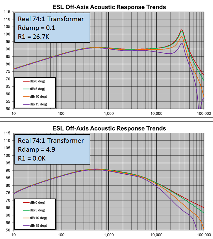

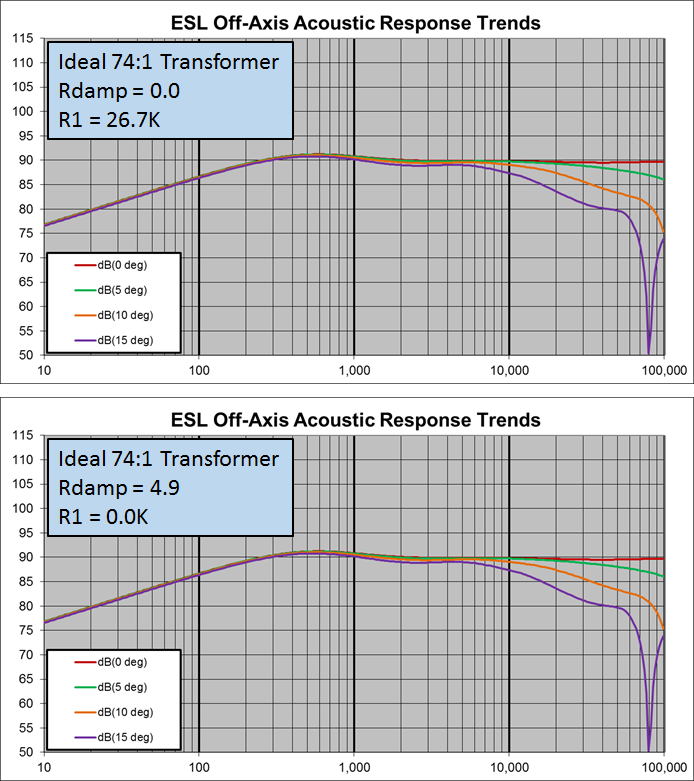

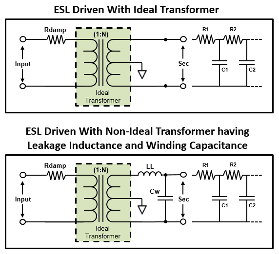

The main difference between ideal and real transformers that affects the high frequency response of ESLs is the presence of leakage inductance and winding capacitance. These non-ideal effects in real transformers result in limitations on the high frequency bandwidth as well as peaking in the response before roll-off.
Attachment #1: Comparison of Ideal and Real transformers driving a segmented ESL. Note the location of the leakage inductance and winding capacitance components in the Real transformer circuit.
Attachment #2: Modeled response of your ESL with Ideal transformers. Comparison of configurations with R1 on the secondary side and when it is moved to the primary side by setting R1=0 and Rdamp = 4.9. You can see the responses are the same.
Attachment #3: Modeled response of your ESL with Real Antek transformers. Comparison of configurations with R1 on the secondary side and when it is moved to the primary side…much different than the ideal case. Note the peaking in the upper figure from resonance between the LL and Cw. When Rdamp is increased to 4.9 ohm in the lower figure you now get HF roll off because you have moved the R1 resistance upstream of Cw which is around 1200pF.

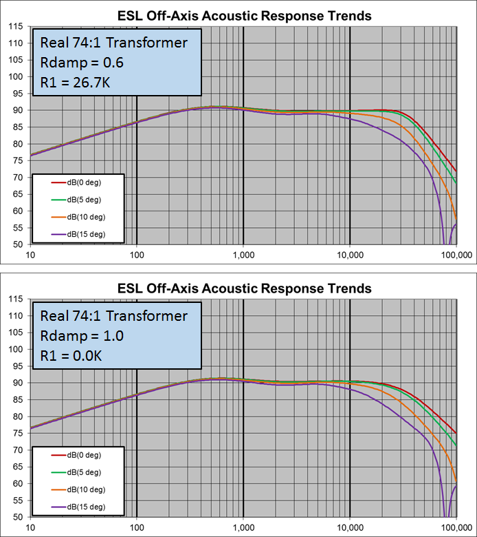

Attachment #4: Modeled response of your ESL with Real Antek transformers. Upper figure shows that if Rdamp is increased to 0.6 ohm the peaking is damped to a response essentially the same as the ideal case below 30kHz. The lower figure shows what happens if you removed the R1 resistance…a rising response in the top 2 octaves.

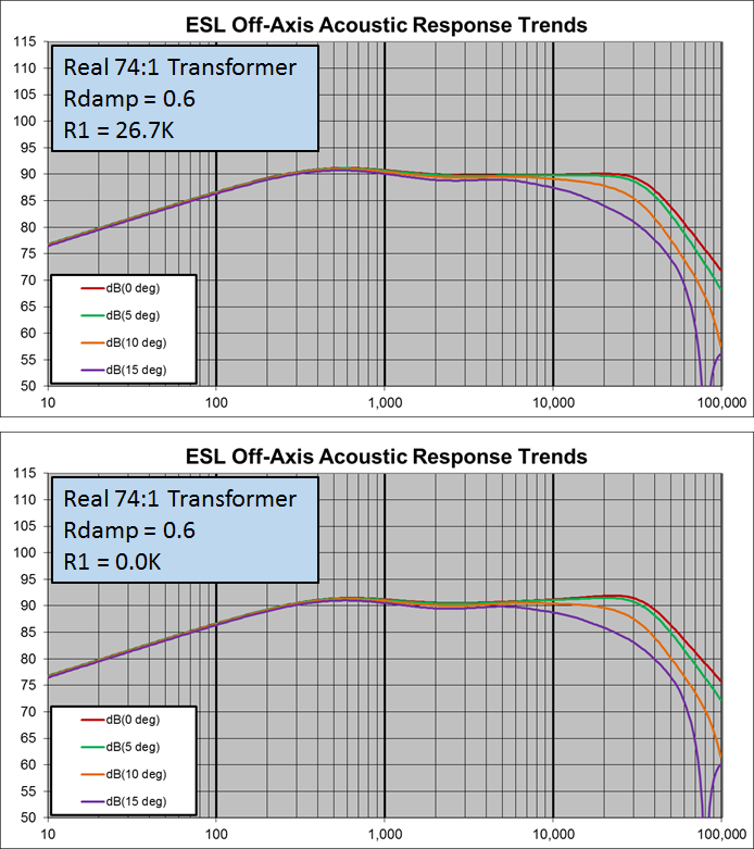

Attachment #4: Modeled response of your ESL with Real Antek transformers. Upper figure is a repeat of from Attachment #3. The lower figure shows that if Rdamp is increased slightly to 1.0 ohm the rising response from removing the R1 resistance is compensated for; this is no where near the 4.9 ohm needed in the ideal transformer case. Note also that HF roll-off starts a little lower now. Again, this is the result of moving some resistance upstream of Cw.
The general guidance for segmented ESLs is that R1 can be removed and Rdamp increased slightly to compensate and flatten the response.

- Leakage inductance results from imperfect coupling between the primary and secondary windings.
The effect can be modeled by adding an inductance in series with the output of the secondary from an ideal transformer.
- Winding Capacitance results from the separate layers of the secondary acting like plates of a capacitor.
The effect can be modeled by adding a capacitor across the output of the secondary downstream from the leakage inductance.
