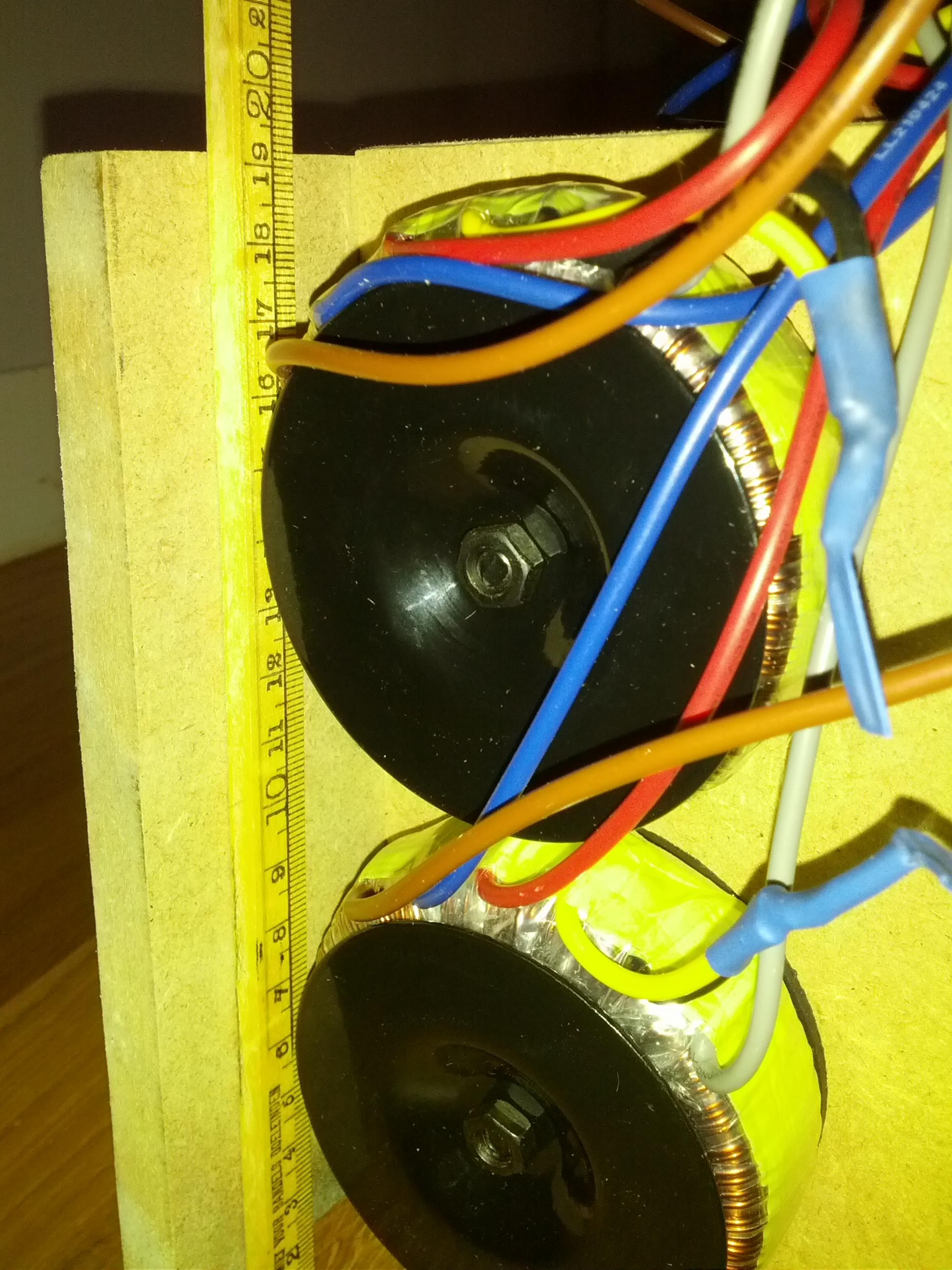

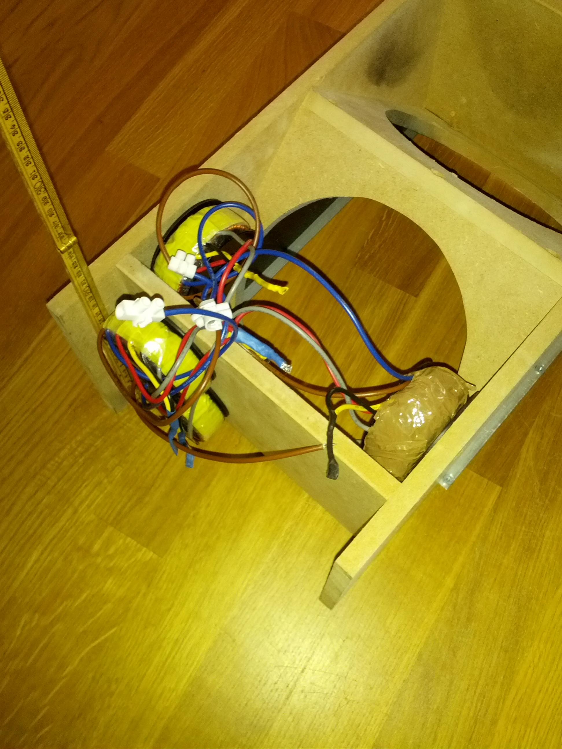

Thanks for your extensive reply. I realize the thickness of the mylar I used has disadvantages and I might have chosen otherwise. Anyway, this type of mylar was freely available and also had an aluminium layer damped onto it, so I didn't have to fiddle around with membrane coating. Everything is a first in this building project so I tried to minimize the difficulties.
I understand now that I won't be able to get the most out of my project without measuring frequency response when it's finished. I don't have any experience in doing that also and was hoping to avoid it 😀
I think I'll keep the 1 ohm resistor in series with the primary in place and see what it does. I have 4x 230v - 6v toroidial transformers per ESL for a total step up of 1:150. I have no exact core dimensions etc. but here are some pictures of the transformers currently attached to the subwoofer cabinet of one of the ESL's.

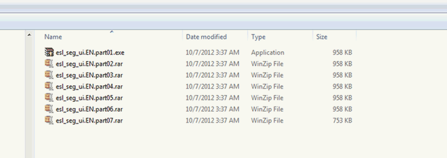

I downloaded and unzipped all files, the exe. file (no. 1), followed the prompts to install the files individually, and when the install was done; NOTHING... no spread sheet in the folder or on the desktop or anywhere I look. What did I do wrong?
I downloaded both files into a folder and ran the exe. file; which created another folder with a bunch of subfiles but I can't find or open anything that looks like a spreadsheet calculator. Any suggestions?
The file to run the calculator is a Matlab *.exe file, not a spreadsheet.

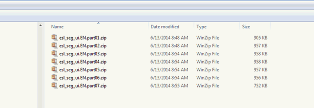

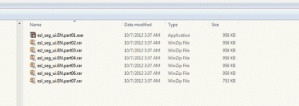

I'll grab some step-by-step screenshots during setup of the English version Bazukaz provided in post #39.
Attachment #1: Shows the 7 *.zip files downloaded to a local directory on your computer.
Attachment #2: Shows the result of unzipping the 7 files; 1 *.exe file and 6 *.rar files.

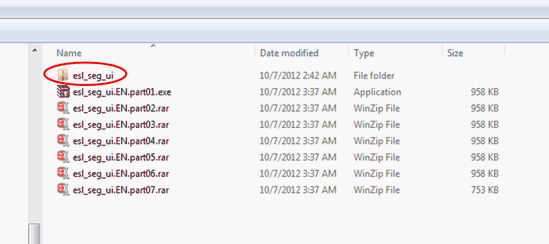

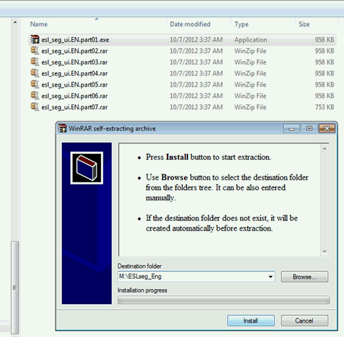

Attachment #3: Double click on the *.exe file to run the extractor. The default directory for the extraction is the current directory.
Attachment #4: After the extractor runs, double click on the "esl_seg_ui" directory

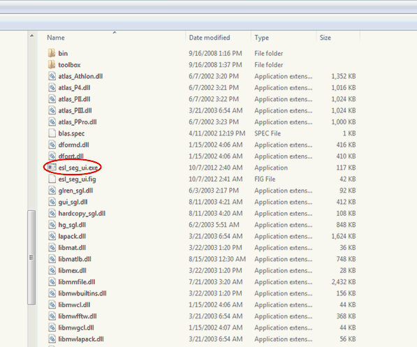

Attachment #5: Locate the "esl_seg_ui.exe" Matlab executable

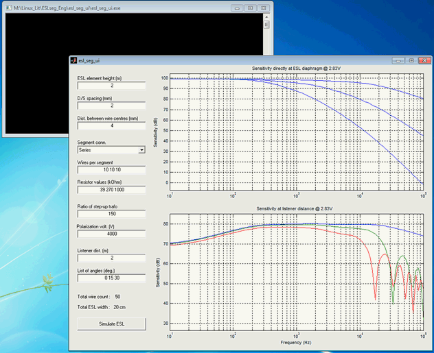

Attachment #6: After the GUI loads, click the [Simulate ESL] button to calculate response.

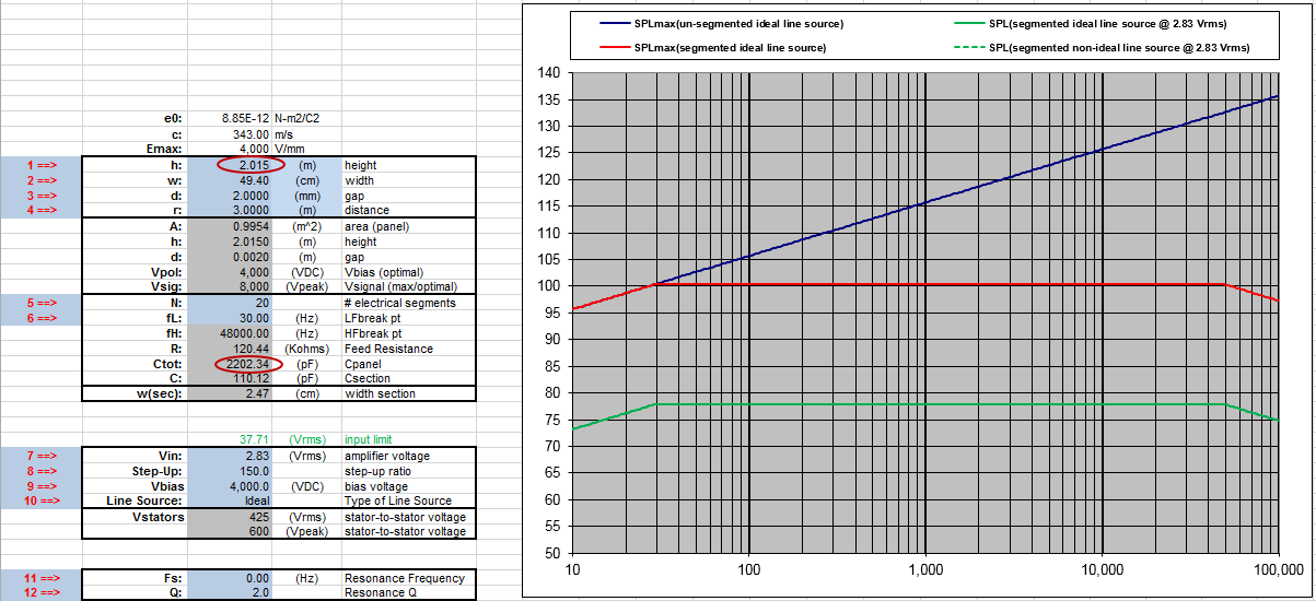

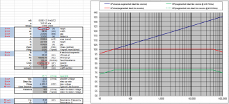

Hi everyone,
I'm in the process of building a rather large (wide) esl and I made this simulation. I am wondering if wire diameter matters? Or is it only segment surface that matters for simulation? (calculation of total capacity) I'm asking myself this because I use a smaller diameter wire than normally used by DIY-ers (1,1 mm)
Also the wires are extending about 10 cm on both ends of the segment so this would increase the segment capacity a little. I'm wondering if one should measure (check) capacitances of the segments or can I just rely on the calculations of this program?
… I am wondering if wire diameter matters? Or is it only segment surface that matters for simulation? (calculation of total capacity)
It is only the capacitance that matters for segmentation response. The capacitance is calculated using flat plate formula. The spacing between the plates is 2x the D/S spacing. For wire stators D/S = distance from diaphragm to the outer diameter of the wire insulation.
More details on D/S spacing for wire stators here: http://www.diyaudio.com/forums/planars-exotics/281348-sanity-check-wire-stator.html#post4492349
More details on calculating capacitance between stators here: http://www.diyaudio.com/forums/planars-exotics/246846-first-time-esl-builder-12.html#post3881204
This extra extension will increase capacitance of the segments, but will cause only minor changes in response. If you want to try to model with capacitance that more closely represents your actual build, you can do this by adjusting the height to match capacitance. I recommend measuring capacitance of your total panel (ie all segments connected together) rather than individual segments. Then calculate panel height needed to achieve this capacitance for your given stator width and D/S spacing. If you want, you can use the Excel spreadsheet posted here: http://www.diyaudio.com/forums/planars-exotics/48120-experiences-esl-directivity-9.html#post4636649 to do the calculations for you.
Attachment 1: Entering your panel dimensions into the spreadsheet, you can see that total panel capacitance would be 1967pF.
Attachment 2: Suppose you measure your panel capacitance and it is instead 2200pF. By adjusting the panel height to 2.015m you will match the measured capacitance value. Then, use this 2.015m height value in your esl_seg_ui simulation. If the response changes more than you would like, you can adjust your segmentation resistor values to compensate.
Remember that your diaphragm will have a resonance which will boost the low frequencies. So, you may not need to extend the response so low in frequency with segmentation. Moving the LF roll off point up in frequency will boost the overall sensitivity. The downside to doing this is that the high frequency dispersion will not be quite as good(for the same total panel width). This is an inherent tradeoff with segmentation…sensitivity vs high frequency dispersion. You will need to strike a compromise between an ESL that plays usefully loud and one that has good enough dispersion for a nice sized sweet spot and balanced room ambiance. If you want to keep the same high frequency dispersion you have, but move the LF roll off point up in frequency, you do this by reducing the overall width of the panel.
