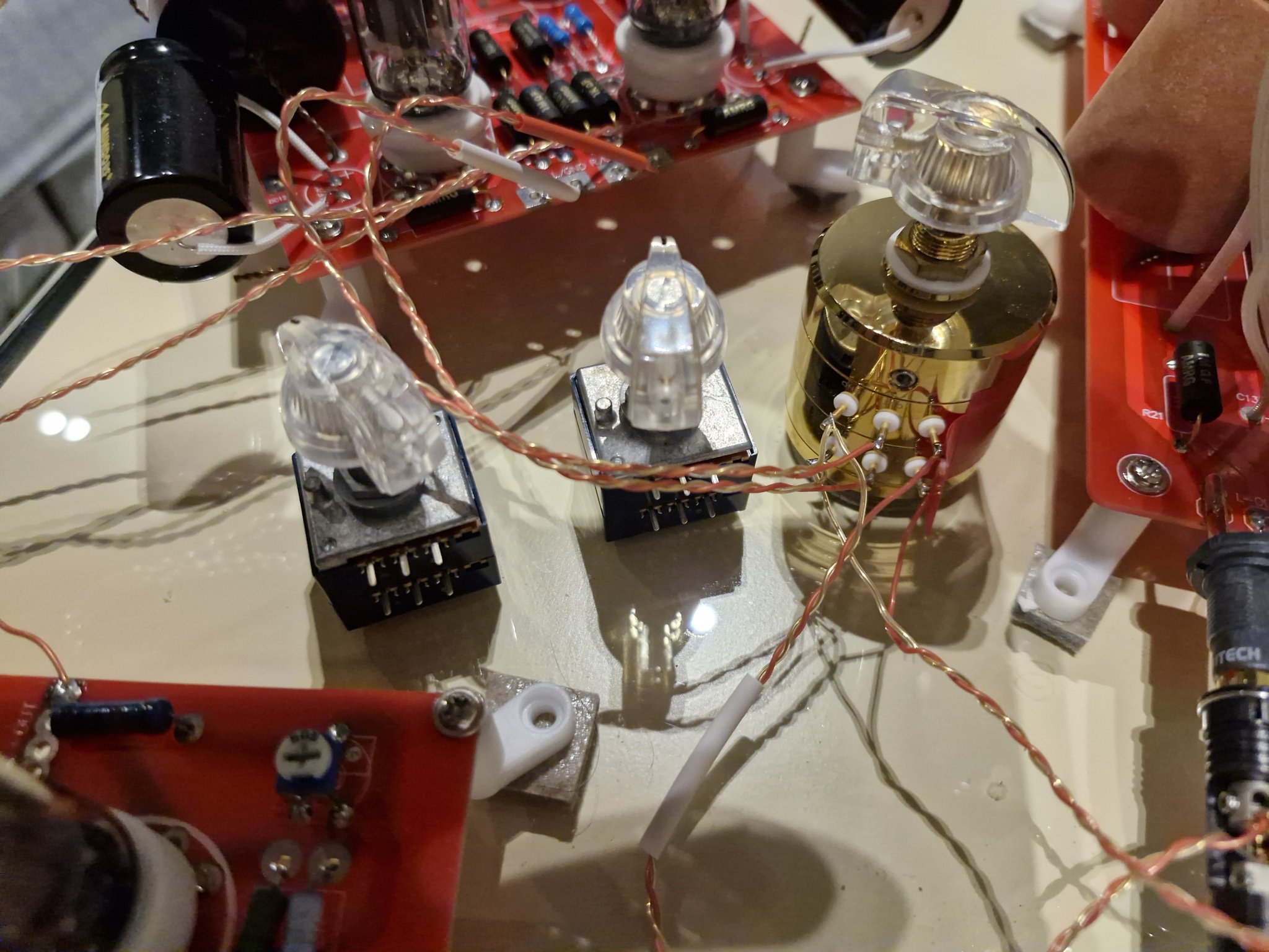

Received the EIZZ attenuator and 6-24 switches from ali.. Really pleased. EIZZ is smooth and high quality with 0.1% tolerance between channels. impressive!
no play in the shaft👍
6-24 switch is pretty fine for the cost!

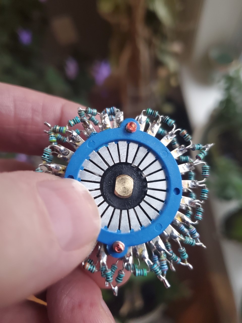

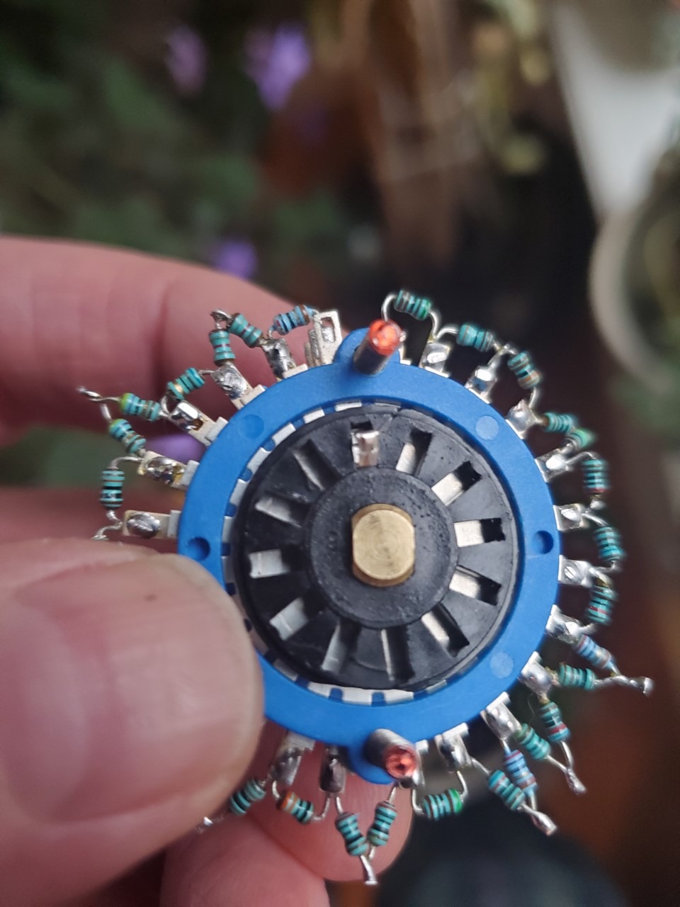

Well, I built one 23 stepped attenuator. Initially I checked the switch function with a meter on the front deck and assumed the rear deck was fine but after full assembly I discovered an issue with the rear deck. I took it apart and compared it to the second unit I purchased. With the switch set to off position the contact was in one space to the right of where it is in the photo. I used the second unit to see exactly how the contact piece is oriented in the slot. Also, some of the fingers were bent upward and straightened those.
Now testing fine with the ohmmeter with less than 0.5% between decks.. Next step install in DCG3!
