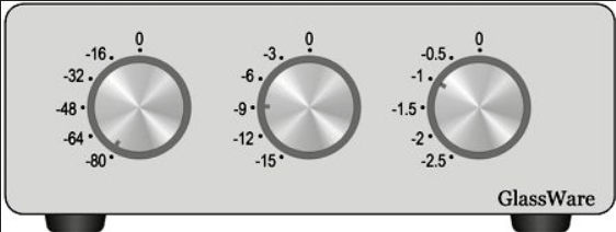

Here is a relay controled example ( sometimes wrongly named R2R), but same principle apply, study schematic and use resistor calculator to define step value ( if you want different attenuation levels (eg -7,5db) it is possible, find an online Lpad calculator) :
https://www.amb.org/audio/delta1/
You are not forced to use a Pic to control relay: either(multiple) on/off switch, either a multi deck stepped rotary could be used.
With on/off switch it is cheap but tedious to operate ( don't expect wife or kids to use them without 'accident').
With multiple rotary switch it's easier to use ( as depicted in a previous post: coarse level (-64/-32/-16/-8/0), fine level ( 0 to -4), nitpicking (-0,1 or -0,5db to -3,9 or -3,5 ).
I use a variant of on/off with buffers ( mandatory in my view but ymmv).
