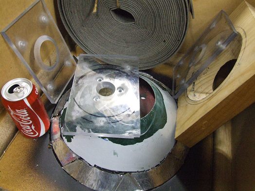

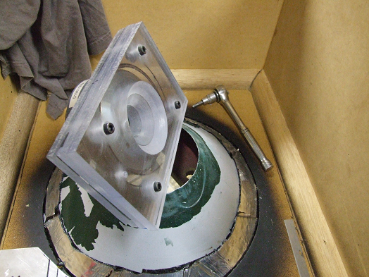

A heavy driver on a small mounting just sounds too weak for my taste.

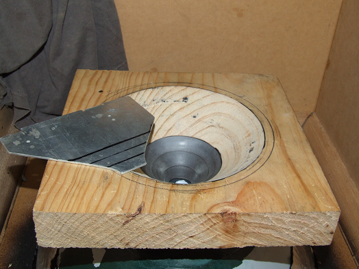

IMO the horn itself would be the weaker link - particularly in my case, if I make a frankenhorn with a wooden mouth and a plastic throat. I should probably add a brace to support the driver, no matter which driver I go with.
If the screw-on attachment was weak, it'd cause lots of failures in pro audio coaxials. The horn driver on mine weighs 2.72kg, and it hasn't fallen off yet :)
I'm not worried about the driver falling off, but the vibration of the driver mass cantilevered on the weak end of a horn. Coaxials don;t have the driver attached to just the horn end, but are mounted to the woofer so my concern doesn't apply.
