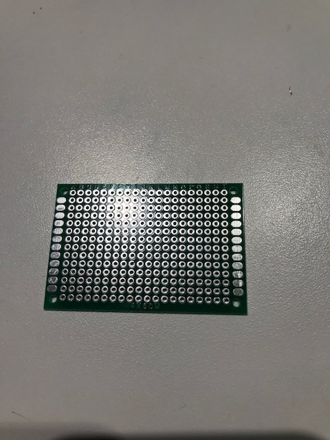

Newer member here trying to learn about circuit building. I Just got my first blank pcb.
In the pic I provided there are some oval dots at the extreme end. Are those like power rails connecting the whole row of eyelets? If not what are they? Is the one row outside of the oval on both ends not linked to those ovals?
Does one work from a horizontal landscape or portrait?
I know these are basic questions. I have tried to find videos but none showing what I am asking for. Any help or references would be helpful and I am here to learn LOL
The dots are just tie points that are not connected to anything. You can use your meter to verify that.
That is a "pad per hole" board, with no interconnections between any of the pads.

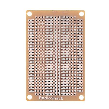

Some boards do have some interconnections, which you can see.
The oval pads are not usually connected to anything.
They are usually used for interconnecting boards, connecting wires for external circuits or sensors. They are also usually conveniently spaced to allow connection for headers such as screw terminals.
You can solder a line across them if you wanted to use them as a power bus for example.
Portrait or landscape depends on your layout - whatever fits best the application. Also a driver is often how the board fits best in the final enclosure.
And welcome!
AHH, so the connection is made by using solder or a wire? The orientation is subjective to the artist?
The ovals are used interconnect or add other things needing a bigger footprint?
oh and what do you mean by a "driver"?
