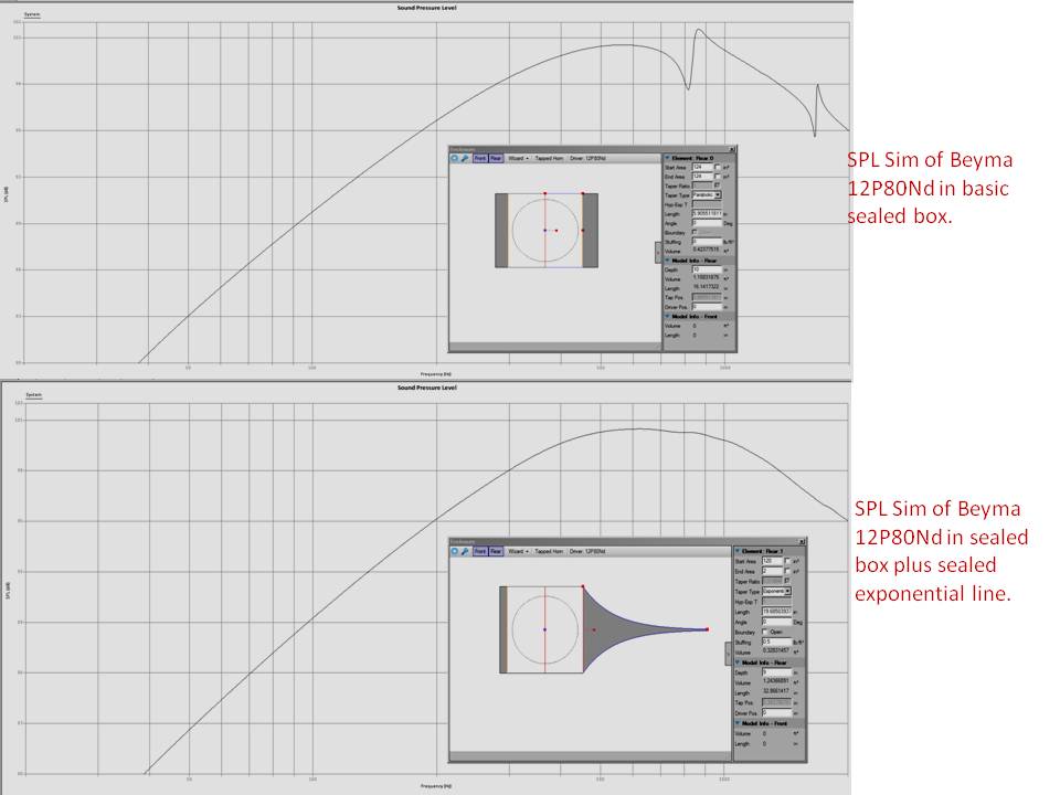

Experiment: Add loose stuffing in the rear 1/3 of the midrange triangle box (wool, fiberglass, cotton, poly-fill). Most speakers put sound absorption material in the rear midrange cabinet volume to absorb highs.The Tweeter and Mid Closed box, not filled, just foam around the walls
