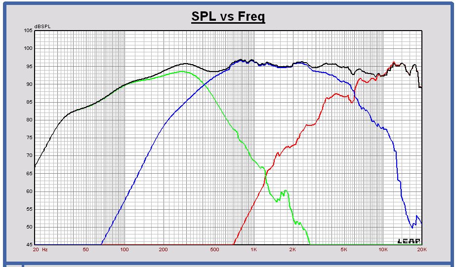

I have simulated the TFS1 in Leap. Afterwards more details about the simulation results. Here is the SPL of the filtered drivers in their cabinet.
This is the free field response at 1m and 2.83Vrms.
You can see that this system has a SPL fall off below 200Hz and is about 12dB down at 50Hz. Maybe this explains your listening experiences, some missing of low frequency power.
It can be explained very simple. The Beyma woofer has an efficiency of about 93.5 dB on infinite baffle at 1m and 2.83Vrms for low frequencies around 100Hz. Due to the bafflestep of the enclosure you loose 6dB for low frequencies in free field. This means that, to design a system which is flat up to low frequencies in free field, the overall efficiency of your system can only be about 87dB at 1m and 2.83Vrms. Now it is 95dB and so you have too much low frequency fall off.
It is up to you now to decide how you will progress.
You can do some active equalization of the SPL.
Or the crossover filter can be redesigned for a more flat response up to low frequencies. I can do that if you want.
Do you have the equipment to measure some responses? Impedance, SPL?
If yes you maybe can do some control measurements. If no I have to take the responses of my actual simulation. The simulation is based now on the supplier specification of the drivers. There can be some deviation of your drivers w.r.t. that specification. But we can try it out.
Are you playing with a tube amplifier? I see one on the picture of your room that you posted :). In that case we have to take into account the output impedance of that amplifier in the case it is not low impedant out.

With the actual crossover filter the free field SPL is about 95dB for the mid and high frequencies and 84dB at 50Hz (1m and 2.83Vrms).
To realize a F3 at about 50Hz the SPL should be designed to be 87dB for the mid and high frequencies. In that way you make a system that is flat down to much lower frequencies.
For a higher SPL you have to choose a more powerful woofer(s).

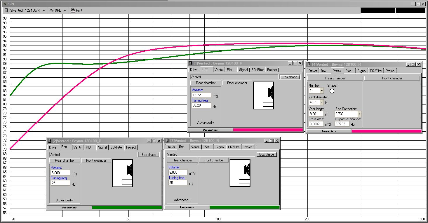

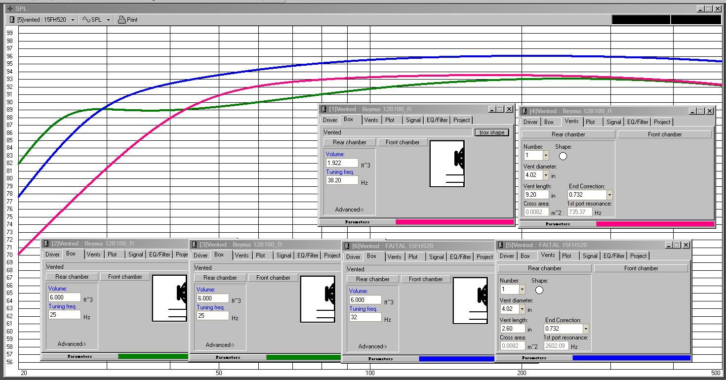

Attached sim comparing 15" Faital 15FH520 with 12" Beyma 12B100/R in a ported 6cuft volume cabinet. In this sim, the 15FH520 generates a 95db sensitivity at 400Hz similar to the midrange sims. Larger Box. Larger woofer. Just add a little room gain.
Attached sim of 12B100 in 6cuft ported bass shelf alignment to illustrated potential bass extension if speaker is placed up against the walls. Even in a 6cuft box, the 12B100 still has 3db lower SPL at the 400Hz Xover than the midrange or the 15FH520 example.
You could build a larger (6cuft) ported cabinet and experiment with your 12B100 before you purchase a 15" or 18" higher efficiency woofer for that box. Just route a larger hole and change port length.
I'm sure you will get other suggestions for suitable 15" high efficiency woofers. Higher price 18Sound and BMS models can be sim'ed and compared.

@ LineSource
Your simulation SPL values are values on infinite baffle. Placing the box in free field, 6dB will be lost for low frequencies, below about 200Hz for the TFS1 enclosure.
For my designs I prefer a flat SPL design in free field down to low frequencies. For the Beyma 12B100 in 70 litres and tuned at 38Hz (TFS1 values), a F3=38Hz can be realized. In this way it is about a ported B4 alignment. To realize an overall flat SPL in free field, you have to limit the midrange SPL to about 87dB.
Dependent on the room acoustics and the position of the speaker in the room, some low frequency equalization can be performed if needed.
Larger volume and lower tuning frequency will lower the F3. It will become more a QB3 alignment, but the system Q values will become higher too. I prefer the B4 alignments for basreflex systems.

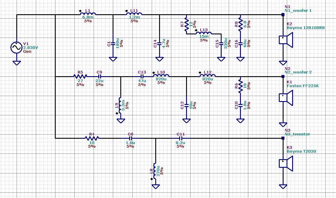

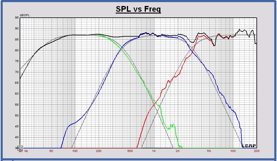

Jogas,
Just to show you what could be possible by designing another X-over filter for your actual TFS1 system.
I have designed a LR4 filter with X-over fequencies at 400 and 3000Hz.
It is just an example.
The new X-over schematic

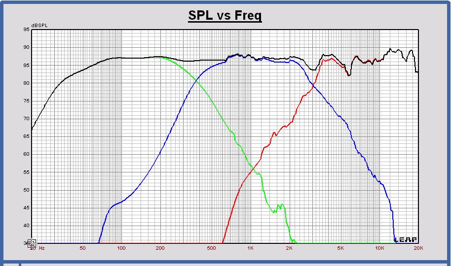

The SPL response at 1m and 2.83Vrms in free field
The SPL response and the LR4 targets added in grey color
You see that the SPL is flat now down to low frequences, -3dB point at 50Hz.
But the overall SPL at 1m, 2.83Vrms is decreased to 87dB.
This TFS1 system doesn't have the good combination of drivers to make a flat SPL system. The midrange and tweeter have to be attenuated too much.
To get more SPL out of your system with more low frequency power, you have to choose a woofer system with more SPL like other collegues are mentioning too.
Suppose you like to modify your current crossover and keep your driver set, I can design also more simple X-overs like a LR2 or a B3. Making some modifications in your actual filter to make the SPL more flat is also an option.

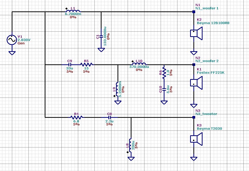

Jogas

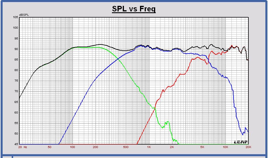

I have made a simple redesign of your current X-over to make the SPL more flat.
You have to modify only 4 components.
Schematic
In the woofer filter:
Change the coil of 5.5mH/0.5E to 6.7m/0.8E by placing a coil of 1.2mH/0.3E in series.
Change capacitor of 100uF to 133uF by placing 33uF parallel.
In the midrange filter:
Change resistor of 4.7E to 15E
In the tweeter filter:
Change resistor of 2.2E to 6.8E
SPL with modified filter
It is a simple test that can be done to get an impression of a more flat SPL.
I take some risk by using all specification parameters for the drivers.
Maybe the ones you have are different, but let us hope it is not that big difference.
