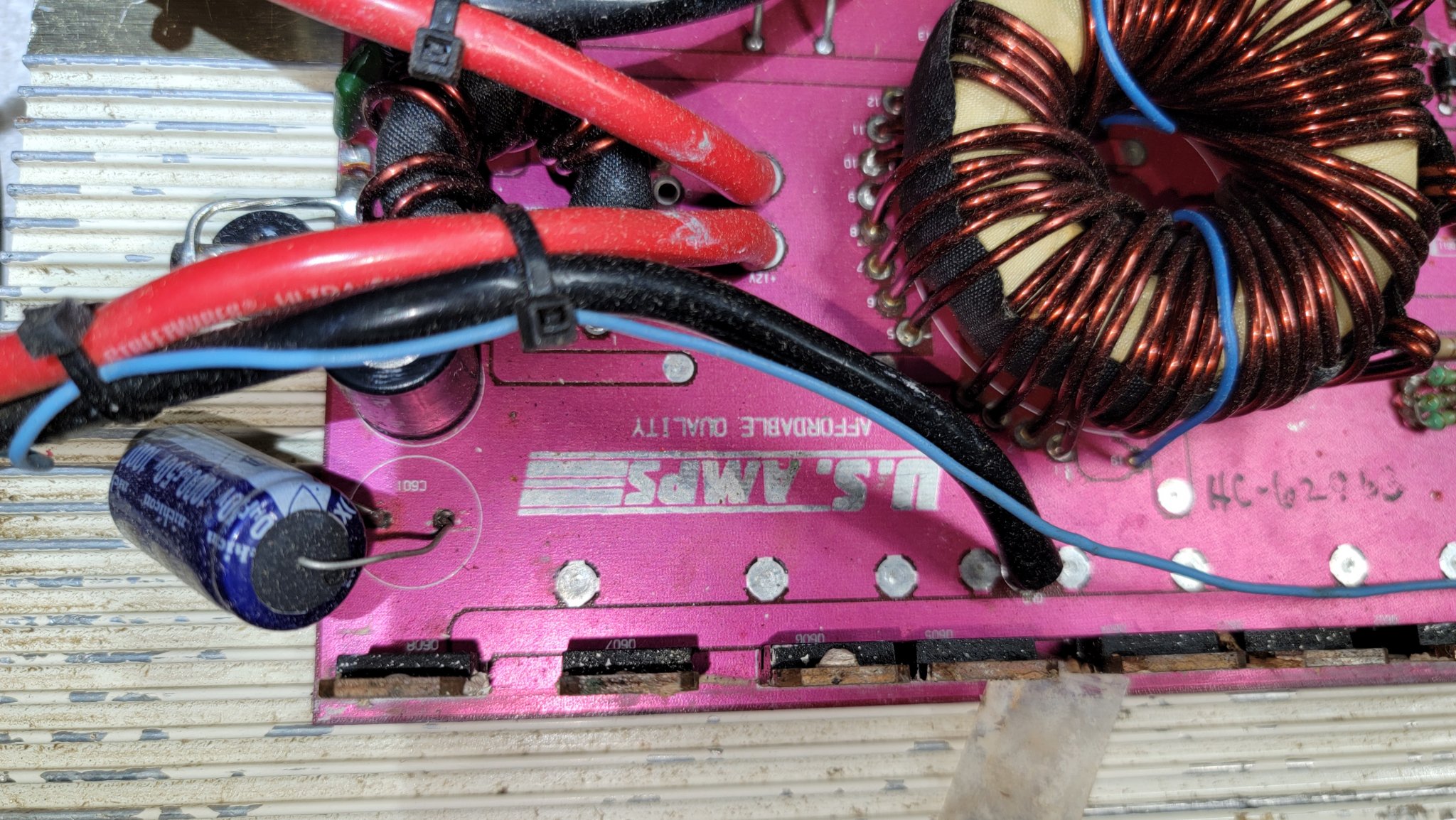

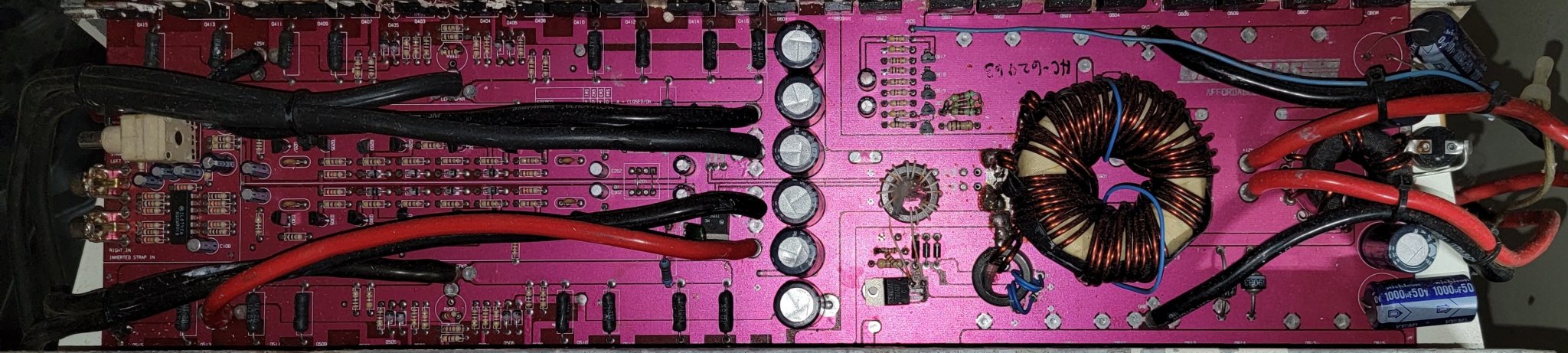

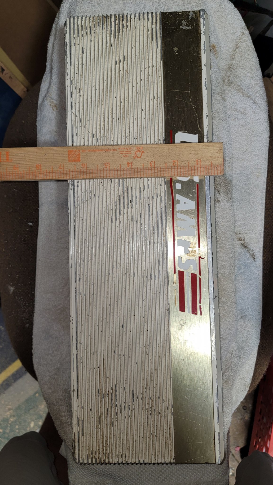

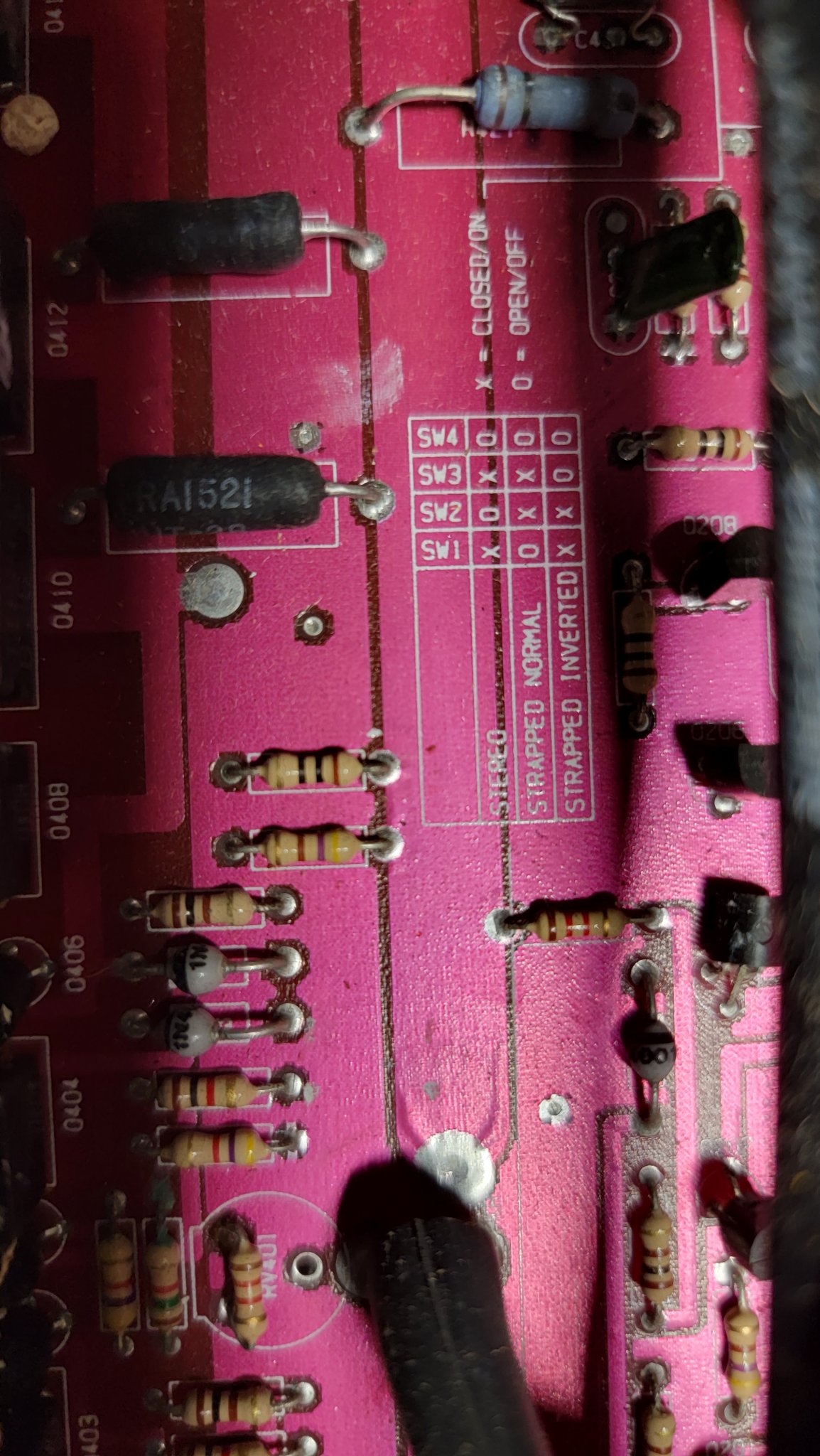

I recently acquired a U.S. AMPS amplifier model KA100HC rev.1. It's nothing like I've ever seen. Information on the web brings up very little and what does come up doesn't match either the name, model, or description. I'd like to find the true specs and if it's worth resto, bring it to working order. In not saying it doesn't work though because I've hooked it to a 12-volt source and the red light did come on, but that's as far as I was comfortable with going. I have a bunch of pics and am available to take more and to try to answer any questions you may have.

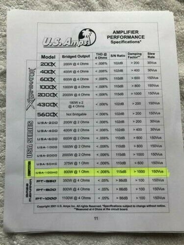

This all came from different forums:
Specs per 92 catalog/ USA-100HC
4ohm-50x2
2ohm-100x2
1ohm-200x2
.5ohm-400x2
Bridged@1ohm=800
2x8awg powerwire input
THD <.009%
IMD <.03
Signal to noise ratio 115db
Frequency response 5hz-50khz
Slew rate 150Vus
Input sensitivity 250mv/10V
Vari-loud/NO
Preamp outputs/NO
Active crossover/NO
FUSE/100A
DIMENSIONS 7.7x2.3x20 inches
Damping factor 1000

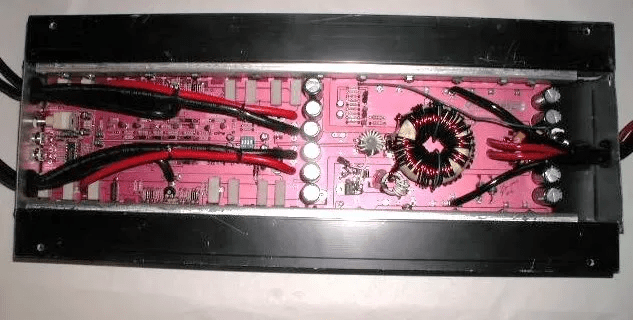

IMO absolutely worth bringing it to working order if it is not already.
It appears from what I can find you have the early version of the 100HC.
The manual below shows some more info on the 100HC on pg 15.
