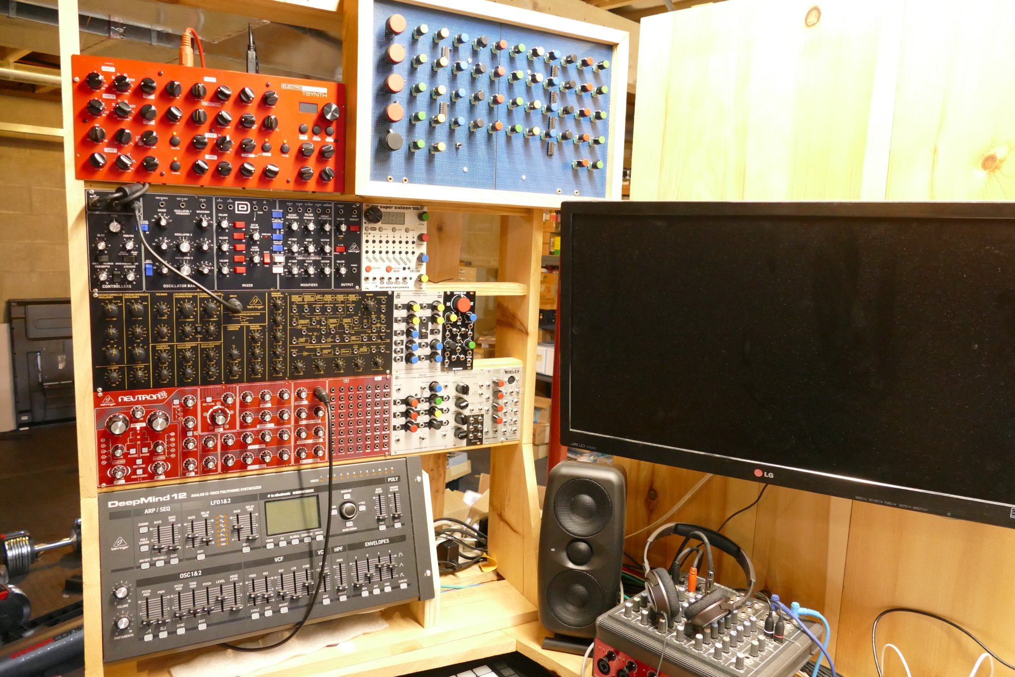

I got a Mackie SR32*4 VLZ Pro mixer for $100 at a hamfest several years ago. After the basement rebuild is done, it will feed the 4 non - preamped channels of the Focusrite.

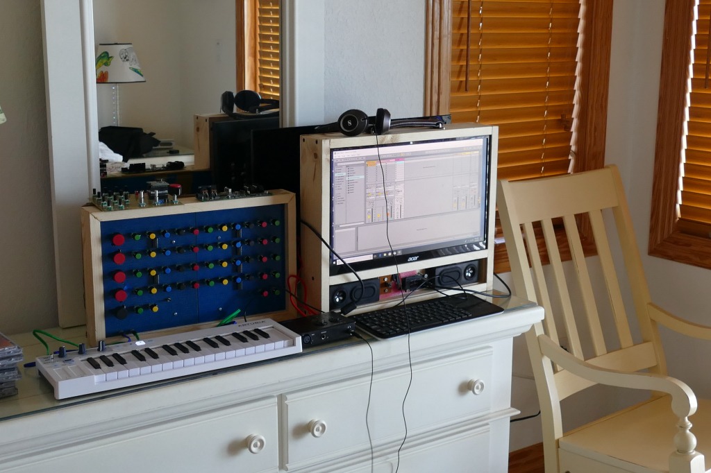

The "music making box" is a DIY device that I have been working on sporadically for over two years. It has several music synthesizers of my own design, a sequencer, a guitar preamp, 19 knobs, 16 faders and a small touch screen. Most of the hardware is working, but the software still needs more work. A lot more work.
The guitar amp that runs Windows is now in its third generation. Ther first gen was too big needed wall outlet power and had small crappy speakers that self destructed the first time I plugged a bass guitar in and cranked it up full. It was an attempt at "one box does everything" including a DAW. It did have a stingy Core i7-7700T chip, so it could be used without a power outlet. you just had to lug a 1KVA UPS around to run it. It would power my "Blue" synthesizer, a DIY digital synth, and had an internal 10 WPC audio amp which got plenty loud on external speakers, but eventually got ripped apart to make Gen 2 which never worked right. Gen 3 runs a Ryzen 7 5700G chip and uses a 13 inch touch screen instead of the 19 inch unit in Gen 1. I have not built a case for it yet, but all of the pieces play well together. It uses 14 X 18650's for power.
