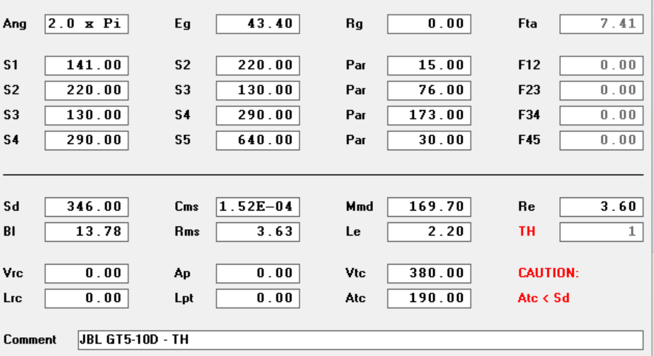

Seeking a better understanding of the physics behind selecting ideal T/S parameters for a small TH
To start, if you're aware of other threads/links on this subject please feel free to reference.
Backstory: Since joining this forum years ago and learning hornresp, I've played around with hundreds of combinations of subwoofer designs and speakers in hornresp and it has become one of my favorite ways to burn time. It's not uncommon for me to see a driver, lookup the T/S parameters, plug into hornresp and see if I can make a box with the flattest response curve between 40-100hz.

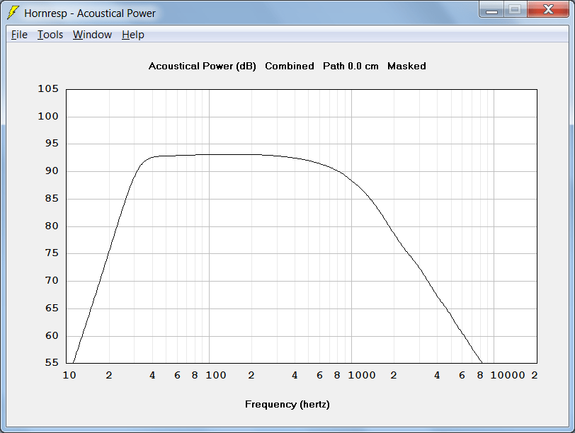

Example: Eminence Legend BP 102 in a ported box vs TH smoothed with a 2mh inductor in series

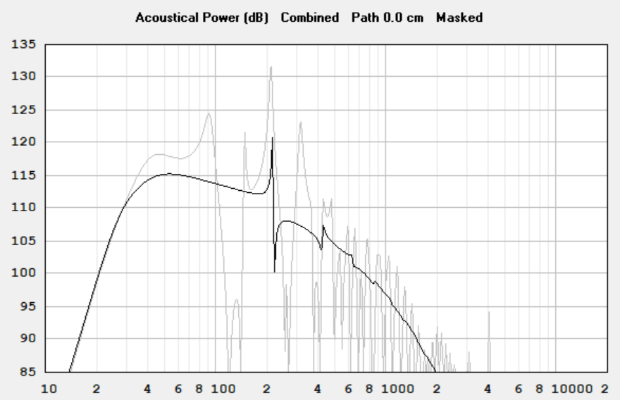

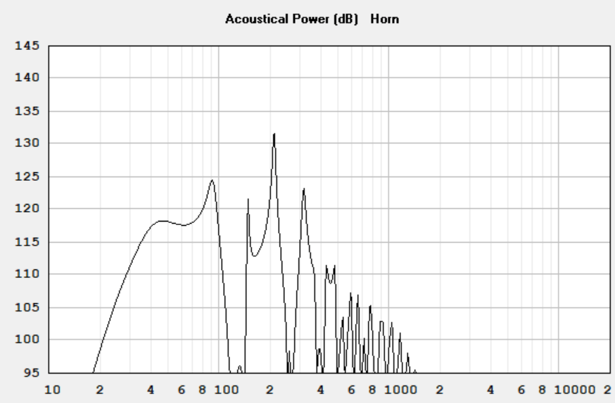

When I swap out the Eminence Legend driver with a JBL GT5-10D, everything goes crazy:
There doesn't seem to be much I can do with the TH dimensions in the GT5-10D to flatten it out. Therefore it seems this driver just isn't suitable for a TH unless I'm really doing something wrong here (I do want to know).
If this is not a mistake on my part, I'd really like to understand why this is happening.
I'd also like to hear any opinions on using the Legend BP 102 in a TH. These dimensions seem very reasonable and easy to build, especially if I build a TH with only one turn. I'm not concerned with maximum power (I see it will reach xmax with ~50 watts), just something with good response that is not too big and easy to build.

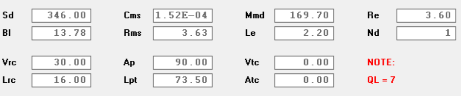

Settings for the Legend BP 102TH:

Settings for JBL GT5-10D TH:

The T/S-parameters of the JBL and Eminence are quite different, so it only makes sense that they need different TH parameters as well. A bass guitar driver vs a typical car audio driver (just look at the Qts and vas).
The JBL will benefit from a higher compression ratio or smaller S1 + S2 + S3, it will also smoothen out using Vtc/ Atc (something near Vas probably).

Thank you. I understand the drivers are very different and I have spent time looking at what the different t/s parameters mean. My question came from the observation that the Emenence speaker can make a good TH and a bass reflex. If I put the JBL in the bass reflex cabinet, it's still a suitable response. Sure it's not the same but it still works. That's specifically what I'm trying to understand, why the JBL has so much trouble in that TH cabinet but does just fine in the reflex cabinet. I'll check out those links before following up.
change the shape of the ‘tapped horn/pipe‘ from an Expanding path to tapering or straight? Kind of like a long skinny bass reflex/TL
tune it below Fs so it doesnt spike/underdamp/bulge around Fb??
the driver ‘damping’ and the resonator shape ‘damping’ seem to require different shapes and Fb @, or below, Fs to avoid the freq responses that spike/underdamp(I think)?
in car audio drivers with more and more super tight Suspensions this is increasingly frustrating😥. Everything goes nuts at resonance and nothing else .. yuck

Man. I have to admit I'm exhausted trying to find ways for this to make sense. I got my degree in physical science so I'm trying to conceptually understand what is happening at a more fundamental level.
This GT5-10D just can't seem to be tamed in a TH. The below abomination is the closest I can get to anything resembling a decent response, it seems ok until it gets close to 100hz. Nothing I do gets rid of that second spike:

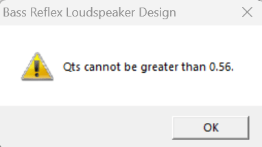

The reflex designer won't work with the GT5-10D because the QTS is greater than .56
Although I did the best I could and if I run them both to xmax the reflex box still seems to be the only reasonable choice.
Then a few minutes before writing this post I started thinking there may be some issues with the driver specs. This thing is supposed to have dual 4 ohm voice coils so it can be run in either 2 or 8ohm mode, but the Re is listed as 1.8ohms and the Le as 1.1mH. I doubled these values assuming it was citing 1 coil and I needed to put them in series. But if they are citing both coils in parallel then I'd have to quadruple both of these values, right? And if I do that, both boxes go completely bonkers.
I thought I'd cross reference the GT5 specs with some other similar JBL drivers (Club 1024) but this only confused me more, it's showing the 4ohm version as having a substantially lower inductance. So now I'm questioning whether all this work was wasted because not I'm not even sure what values I should be working with. A lot of the reason I picked JBL and Eminence was because I thought I could trust their measurements.

I'm sorry but I don't have the background to consume the information in the latest posts. I feel if I knew enough to understand these responses you're providing, I wouldn't need to ask the question in the first place.
Would it be possible to try and remember back before you guys obtained the knowledge you have now? And try to speak to yourself back then? What would you say in that situation?
If nothing else, may I request assistance in verifying I'm inputting the Le and Re correctly for this driver if I use it in 8ohm mode?

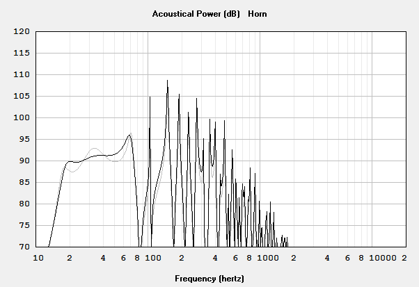

1st approximation for a GT5-10D tapped alignment (faded is with Le, thermal power distortion).
Would this be considered an acceptable response? 20-70hz seems to be a weird goal. No production subwoofers I've found have this type of range. I'm usually expecting a subwoofer to become efficient at 40hz and maintain a relatively even pressure up to 100hz at least. Since this would be for a small system, like a home theater, the tops usually can't go much lower than 100hz. I see a lot of people design boxes to be efficient down to 20hz but I don't understand why you'd want to do that if it means you're sacrificing efficiency up in the audible range.
Anyway, aside from that, I think I'm understanding you're showing me the math that would give me an ideal response without using hornresp. I do appreciate that, but the reason for my post is to better understand what about this specific driver makes it go crazy in a TH. I see you guys are taking my Le and Re values but I really don't think it's possible for these to be correct. 3.6 ohms for an 8 ohm speaker just doesn't seem right. And if that's not right, then none of this math is going to help.

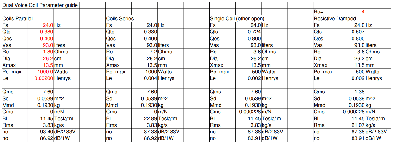

Ok I just noticed they are saying the coils are in parallel. So 1 coil by itself is 3.6 ohms and 2.2mH, correct? Then if we put the coils in series it should work out to be 7.2 ohms and 4.4mH? This gives us a vastly different response.
So if nothing else, I've learned that if you build a box for a driver with dual voice coils, you need to re-engineer the box if you want to change it from series to parallel and vice versa. And it also shows all our previous sims are invalid.

In series = 7.2 ohms, Le = 2.2 mH (see chart)......... yeah, I'm always in a hurry and/or seriously sleep deprived nowadays and wasn't paying attention beyond noticing that the driver specs from a similar JBL DVC sim had the wrong Eg (s/b 2.83 V). Kind of surprised BW didn't catch this.....
Anyway, changing to 7.2 ohms, BL doubles to 19.4 Bl, but all this does is drop eff. 3 dB, doesn't otherwise change the sim(s)........
For the original title: flat frequency response is not that strictly best choice anymore. I would dig deeper into the problematics to se what's up. Peaks in frequency response can mean issues, but it also means efficiency. You can sometimes just knock down the power input at that frequency by using DSP, and you are fine. It depends on what happens there.
Looking at the two drivers, I see similar fs and motor strength but the JBL has over 4x the moving mass as well as a corresponding stiffer suspension to keep the fs up.
The following is my intuitive understanding, mostly based on playing with FLH models, and which may be incomplete/wrong:
At the impedance minima where the cone is nearly immobilized by the horn tuning, the output of either driver is similar and suspension/mass doesn't have a big effect. But further away from the impedance minima where the cone really gets moving, the motor isn't strong enough to move heavy cone + suspension + air column and you therefore lose output.
For these reasons I understood that a good horn driver needs a lighter cone or correspondingly stronger motor.
