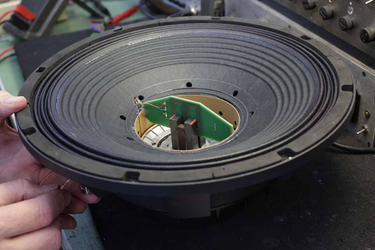

Here you can see how the sonsor coil is mounted on a Backes and Müller woofer (sorry not my picture, therefore only a link):
https://www.fidelity-online.de/wp-content/uploads/2019/01/BM-Fertigung-17.jpg
The magnets of the sensor are glued to the pole-piece. The magnetic field of the sensor is perpendicular to the ones emanating from the motor.

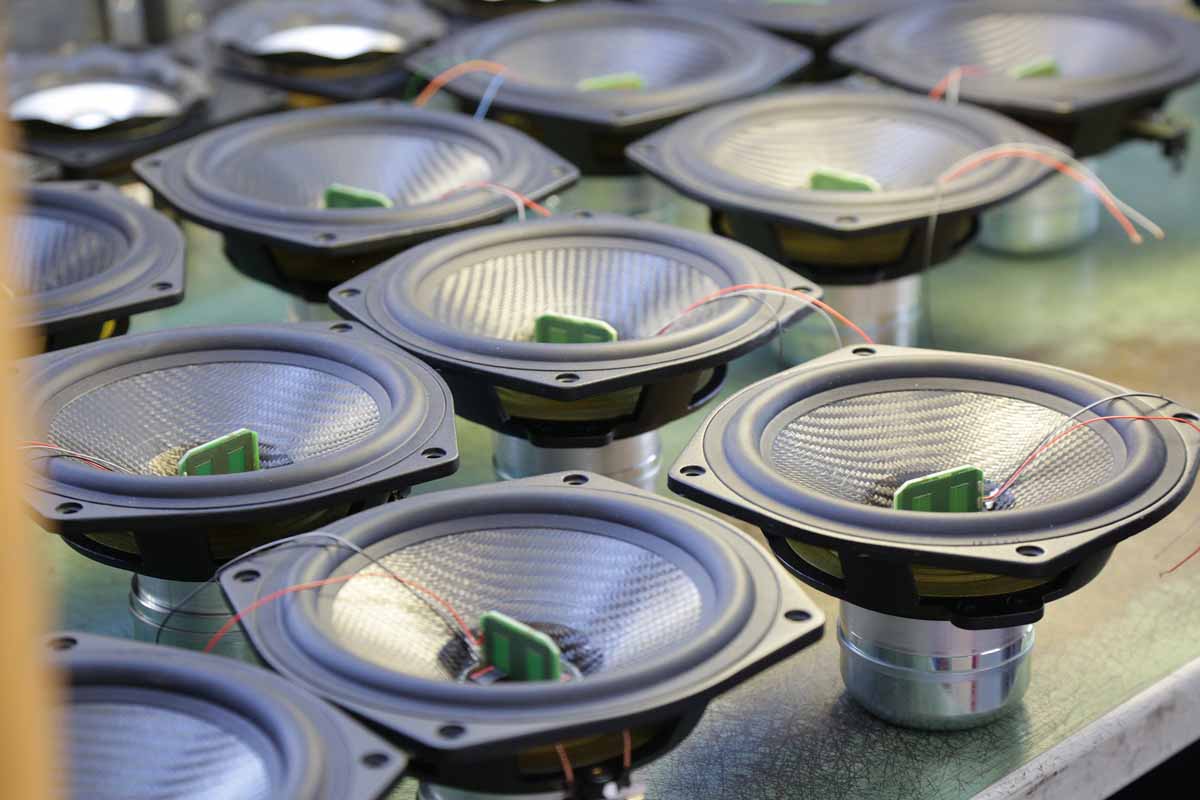

Here you can see the same for smaller drivers (quite fiddly for those who have to mount the sensor I would say):
https://www.fidelity-online.de/wp-content/uploads/2019/01/BM-Fertigung-47.jpg

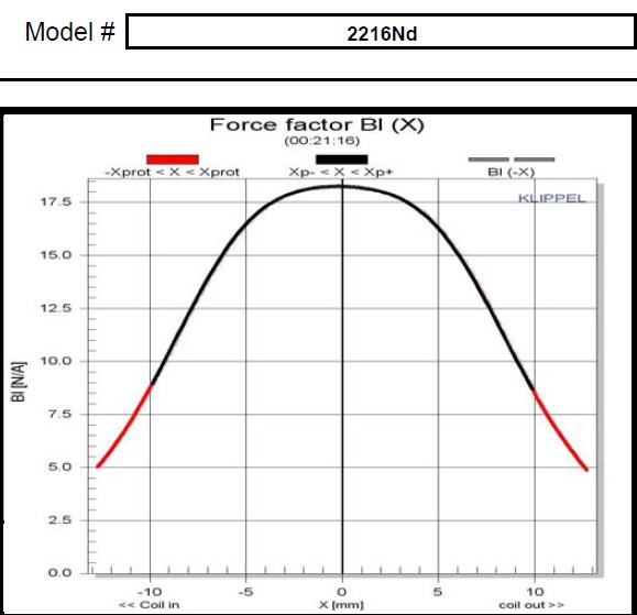

yes, but mfb is usually applied in order to linearize the woofer, not to protect it.
Yes, motional feedback using acceleration as the control variable must result in more linearity than current feedback, as the latter assumes the BL product (the constant of proportionality relating current and force) to be actually constant which is not often true, even when the woofer is nowhere near Xmax. Let's just take a 15 " woofer from a very expensive high-end studio monitor (the JBL M2) as an example (attached).
