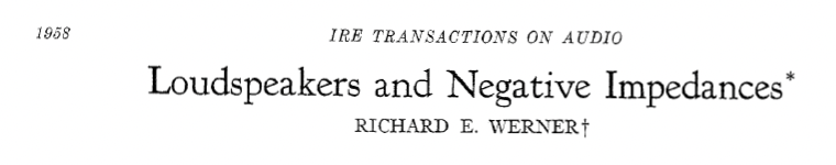

The Wheatstone Bridge design is an upgrade of current sensing. If you read the paper shown below, you will know just about everything you need to know about motional feedback, mysterious negative output impedance, and the Wheatstone Bridge method. OK to skip math at the beginning. Sad how little has changed since 1958.do you have an implementation (scheme) to show me?
Current sensing is simply when you use a resistor (say, .5 Ohm) in the ground return of the driver. Current sensing works great too because it testifies to back-EMF from from voice coil which reflects cone motion quite well.

this ? :The Wheatstone Bridge design is an upgrade of current sensing. If you read the paper shown below, you will know just about everything you need to know about motional feedback, mysterious negative output impedance, and the Wheatstone Bridge method. OK to skip math at the beginning. Sad how little has changed since 1958.

https://www.pearl-hifi.com/06_Lit_A...tive Z Driving LSs/Negative Z Driving LSs.pdf
Thanks for link. Yes, seems to be Werner's paper.
He was at the once-great RCA lab (when Olson was there) and published more or less the same paper three times (counting this one too).
There are modern academic studies. But still hard to beat this simple demo with clear test results presented.
While the Wheatstone Bridge is an enhancement of the current sensor method, I couldn't say how much it helps.
