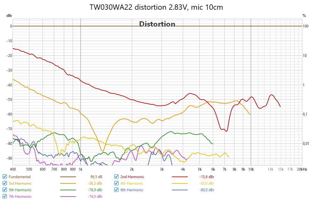

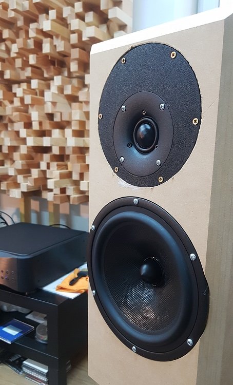

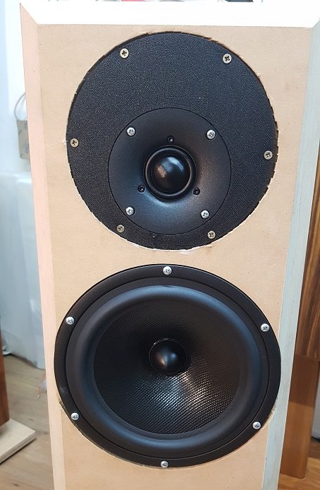

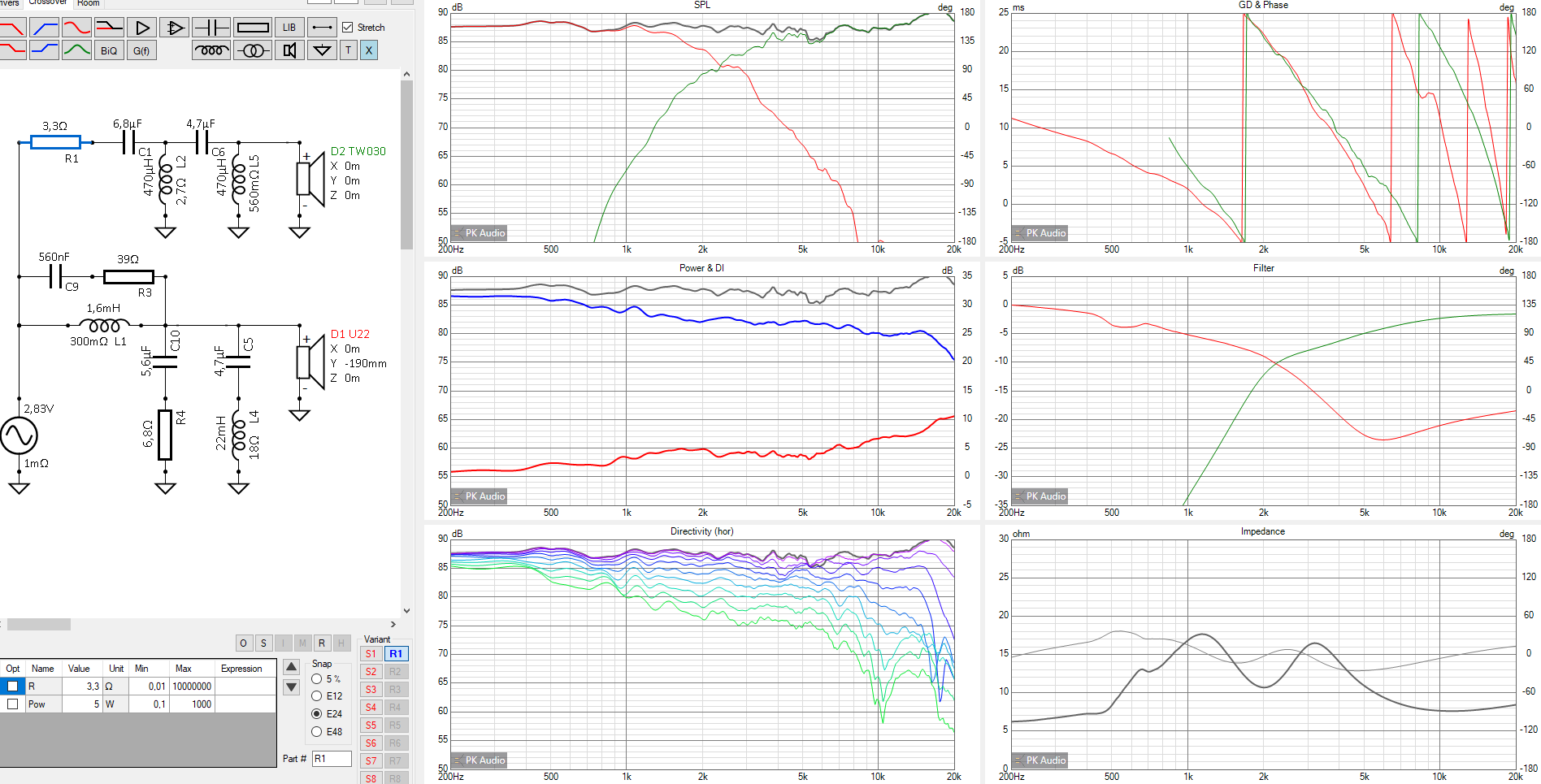

Another tweeter I wanted to try was TW030WA22 Tetoron, new addition to Wavecor tweeters portfolio.
I did the measurements yesterday, crossover modelling as well, and today I could connect it and start listening.
For now I am pleased with how it sounds, though some fine tuning is still ongoing.

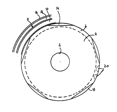

In case it was not clear enough, here's a picture of a Vifa pentacone from their patent:
The simply cut off sections of the perimeter in an area that will be covered by the surround. This means the reflection from the edge occurs at different times, smearing the resonance out over frequency. Glueing little absorbing strips at the positions were Vifa would make their cuts might have the same effect.

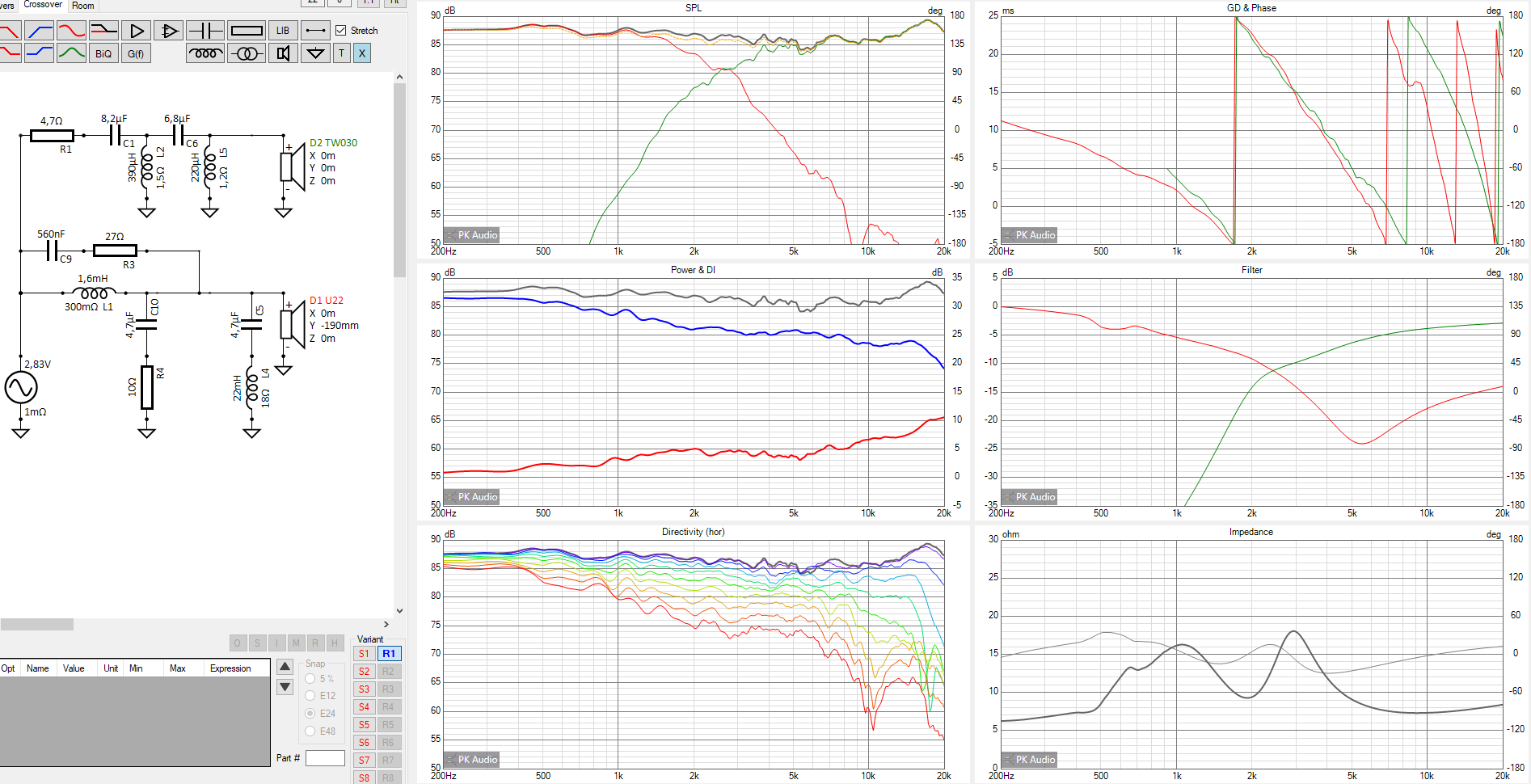

Crossover fine tuning and listening sessions were fruitful, it sounds excellent and I start liking TW030WA22 a lot. I appreciate it does not sound, yet it sounds quite smooth and cymbals etc. actually sound metal, there is certain sense of the speed I know from hard dome tweeters. This Wavecor seems to hit the right balance. This is my first experience withWavecor tweeters and I have to say I like it, especially considering its price.
