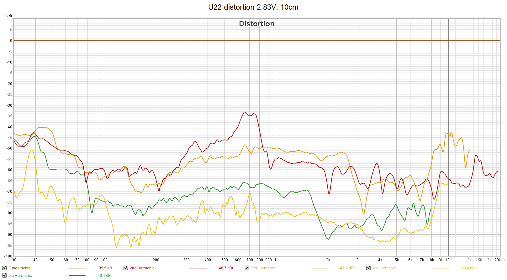

@PKAudio The 700 hz bump in HD is a resonance caused by a radial breakup mode at the cone/surround junction. It can be reduced by applying a viscoelastic dampening compound at the surround cone junction.

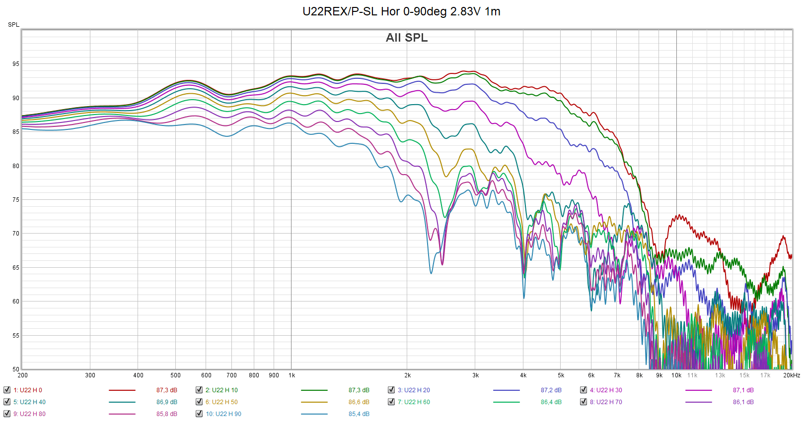

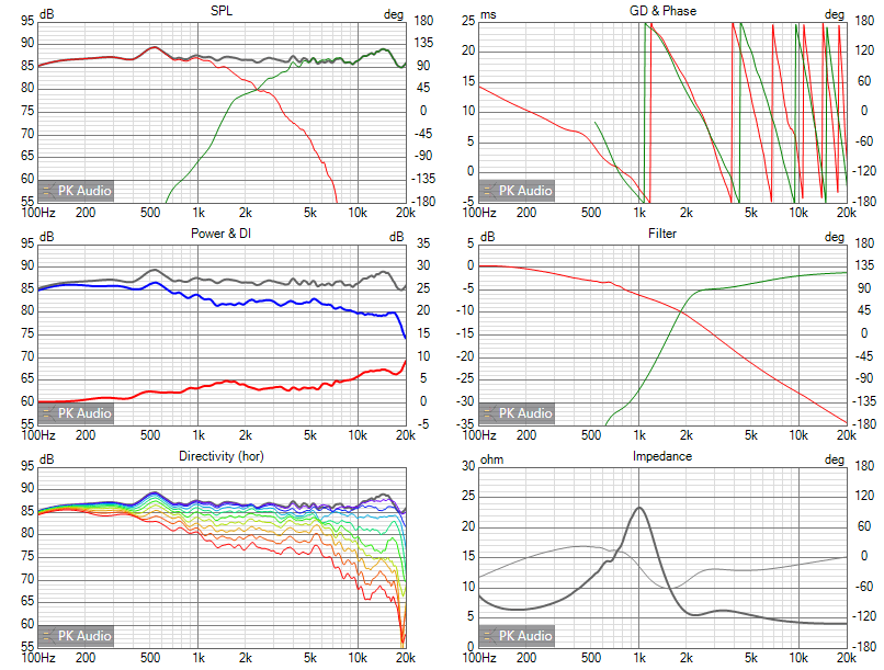

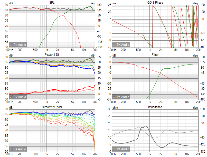

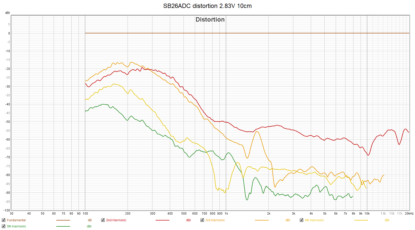

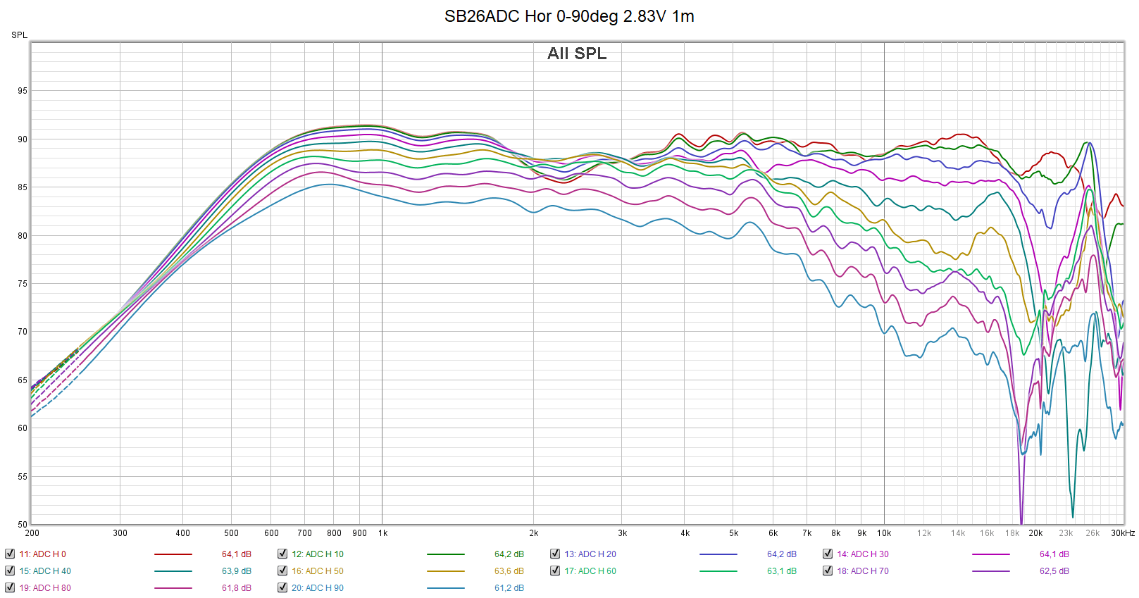

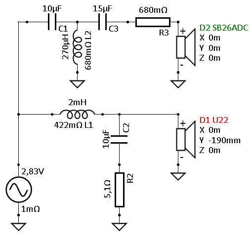

So I took a measurements of U22 and SB26ADC today. Just an experimentas I had Sb26 already at home. Cabinets was properly filled with damping material and port shortened to 11cm to achieve desired tuning ~40Hz. Quick crossover modelling in Vituix shows quite good results, actually not bad for 8"+1" 2way without WG.
Good thing is that bass crossover requires 2mH inductor, the same value I ordered for U18 2way project. Inductors should arrive early next week so soon I will do listening tests of this U22 experiment.

That bump around 550 Hz looks very familiar to what Troels saw with the U16RCY/P. Here's how he dealt with it: http://www.troelsgravesen.dk/SEAS-CURV.htm
Oddly enough, I had a similar FR peak with most 8" woofers in such a compact enclosure. I came to the conclusion it was caused by the cabinet height interaction with the port. There was also a 3rd order HD peak at the same frequency. I tamed the peak with a small pillow made from sheeps wool wrapped loosly by a single layer of grille cloth, placed horizontally in the middle of cabinet and stapled by the corners to the front and back walls. This lowers the high pressure zone of the standing wave and reduces the H3 peak.

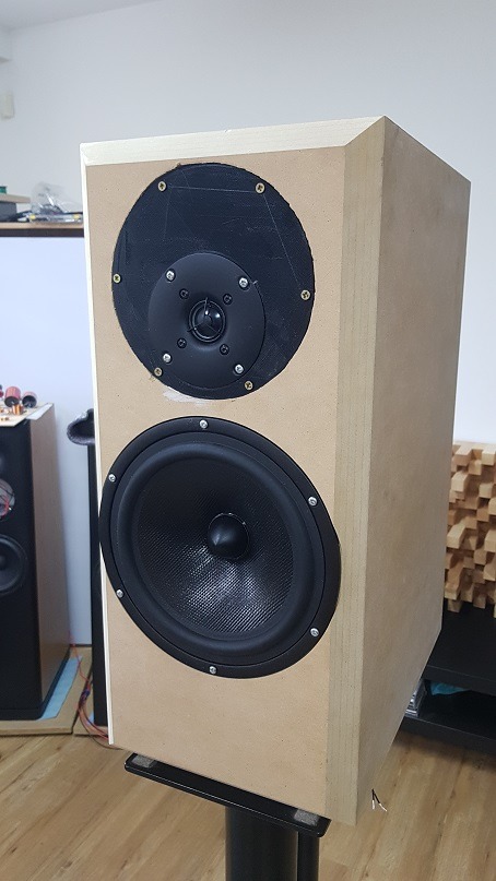

This weekend I connected U22 prototype and had two listening sessions. Both U22 and SB26ADC sound great.
Overall sound of this 2way is fine, I do not detect any directivity issues.
U22 is the biggest surprise, it has vivid sound, very neutral, firm and detailed, snap is there, and bottom end extension is sufficient, better then majority of 6", and it liked higher listening levels.
SB26ADC sounds very good, though I miss the top level details of Be tweeter, but is is just to put the things in the context. For 50eur tweeter I do not have any complaints.
Now my plans for U22 + ?? tweeter + WG are even more feasible.
