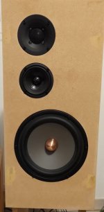

I use the seas mu10rb + 27dxt with a W22NX (800Hz/3.6kHz) and the result is awesome ! Very hard to make a good crossover.
Would like replace the W22 by the U22.

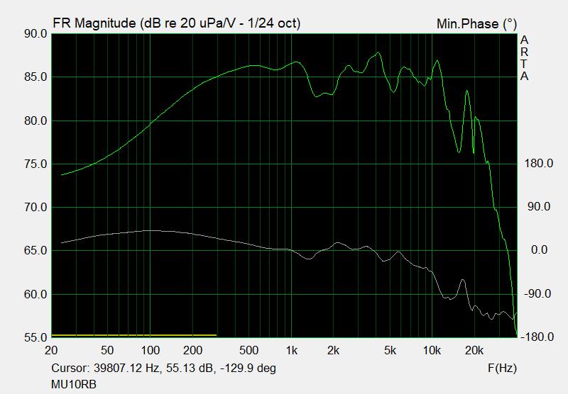

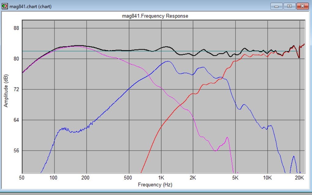

I enclose the mu10RB response on a baffle and the final response of the speaker with the crossover, +-1.5dB in the band 300-10KHz.jerome69: yes, xmas is 4mm only, it reminds me Audax HM series 8" woofers. This is different kind of the driver, I do not expect the low end authority like from 21W/8555, WF223 etc for example, but I expect better low midrange and midrange clarity.

The rubber resonance at 1500Hz is like the SB MW13P one. The measurement of the MU10RB in not on axis but at tweeter axis.

jerome69: thank you for the measurements. How did you like MU10 subjectively? I am asking, because I have experience with Scan Speak 10F/8414, and was not entirely happy with the sound. I may give it another try as I still have them, but I would like to know more about MU10.

Subjectively I like a lot the MU10RB, very transparent, very detailled, very neutral sound, a good match with the W22NX. The sound is transparent to my ears. The MU10RB does the job well. My fear was a mismatch with the W22 which is a beast in term of neutrality and transparency and dynamic. Believe me the W22NX is very hard to marry because of its transparency. I have a very good holographic, precise sound in the space nearly as good as my open baffle in term of stereo image. This is why I would like to test a larger woven polypropylene cone 🙂jerome69: thank you for the measurements. How did you like MU10 subjectively? I am asking, because I have experience with Scan Speak 10F/8414, and was not entirely happy with the sound. I may give it another try as I still have them, but I would like to know more about MU10.
I find some 4" are difficult to work with, I can't explain why. The tuning of the crossover was a little hard, my first attempt was not very conclusive. My goal was to keep the filtered response of the MU10RB as natural as possible, keep the filtered curve as similar as the original curve, if you observe the curve of the speaker you find all imperfections of the curve of the non filtered MU10RB. The harder work was on the tweeter, with two corrections on the response curve but an other story. The crossover of the speaker is not perfect but the flaws are minimized.
About the 10F8414, perhaps it was be a path to explore, I notice with my 22W8534 discovery in a two ways, the crossover was tricky because I have a forward projection of the sound, I don't know if it is the cone material or the large diameter and the beaming of the cone. I also suppose you have a cross effect of the passive crossover on the cone, I tried to suppress the resonance of the cone (4kHz) with a RLC but the sound was not good at all, I left the the response as is with the resonance peak and all things sounded OK to my ears. Manage to fluently the marriage of drivers can be complicated.
Hope I have been clear on my explanations based on my observations about cone behavior. Perhaps the subject is the linearity of the speaker phase but i didn't explore enough this parameter to confirm that.
You should give an other chance to the 10F8414, more difficult is the challenge, more the satisfaction is high 🙂
