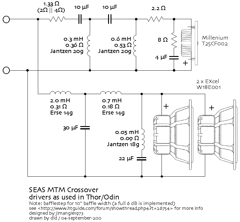

There's a revised filter in the main Thor thread here which many consider to be an improvement over the original. I believe this is the redesign, as drawn up by Dave. Not sure if there have been any further changes since then, but if so they're unlikely to be vast.
Planet 10 has made a pdf where different cabinets and crossovers are shown (Thor-Revisited.pdf). Based on the cabinet dimensions you seem to have the "SMALL THOR ML-TL". However, the paper does not include Jimangie's latest crossover from 2015 (see attachment 2).
Years ago I heard a pair that sounded good…I think the owner brought the crossover frequency down to about 1800hz with a larger first woofer inductor and removing the resistor from peak/break-up attenuation leg(?). Reminds me of the crossover Jeff Bagby used on his Parts Express “TANGO” kit.
