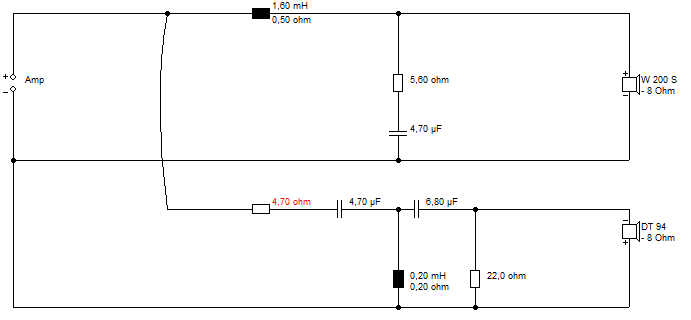

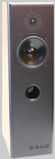

This is an old SEAS kit, called SEAS Njord. I think it's nice. Should have a solid bass foundation. It's not wildly different in concept to the SEAS A26 kit:
http://www.seas.no/index.php?option=com_content&view=article&id=475:seas-a26-kit&catid=66:seas-diy-kits&Itemid=365
You could use the modern H1288-08 CA22RNX and almost any 25mm SEAS tweeter you fancy. TWEETERS
I'd do a more sophisticated 2nd order bass/3rd order tweeter 3kHz crossover, but you won't go far wrong with the basic idea. I think you could do a smaller cabinet too.

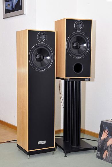

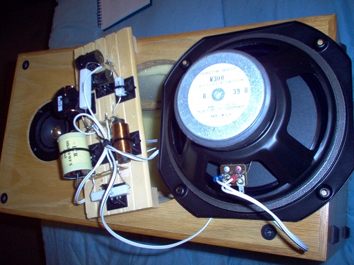

Let's have a look at a variant of the SEAS Njord idea, the WLM La Scala.
6moons audio reviews: WLM La Scala
You might think the big box on the left is a good idea. But, TBH, only if you have a room the size of an aircraft hanger. Otherwise the smaller box will work better, because a small closed room makes the bass boomy. It's called room gain.
If I am honest, a three way works much better at every level with the same SEAS CA22RNX bass :
SEAS-3-Way-Classic
But since this our lovely hobby, I encourage relative noobs to have a go. You will get good sounds if you have a good idea. I still enjoy reducing the bass coil, and increasing the bass shunt capacitor proportionately. Part of my hobby. 😎
