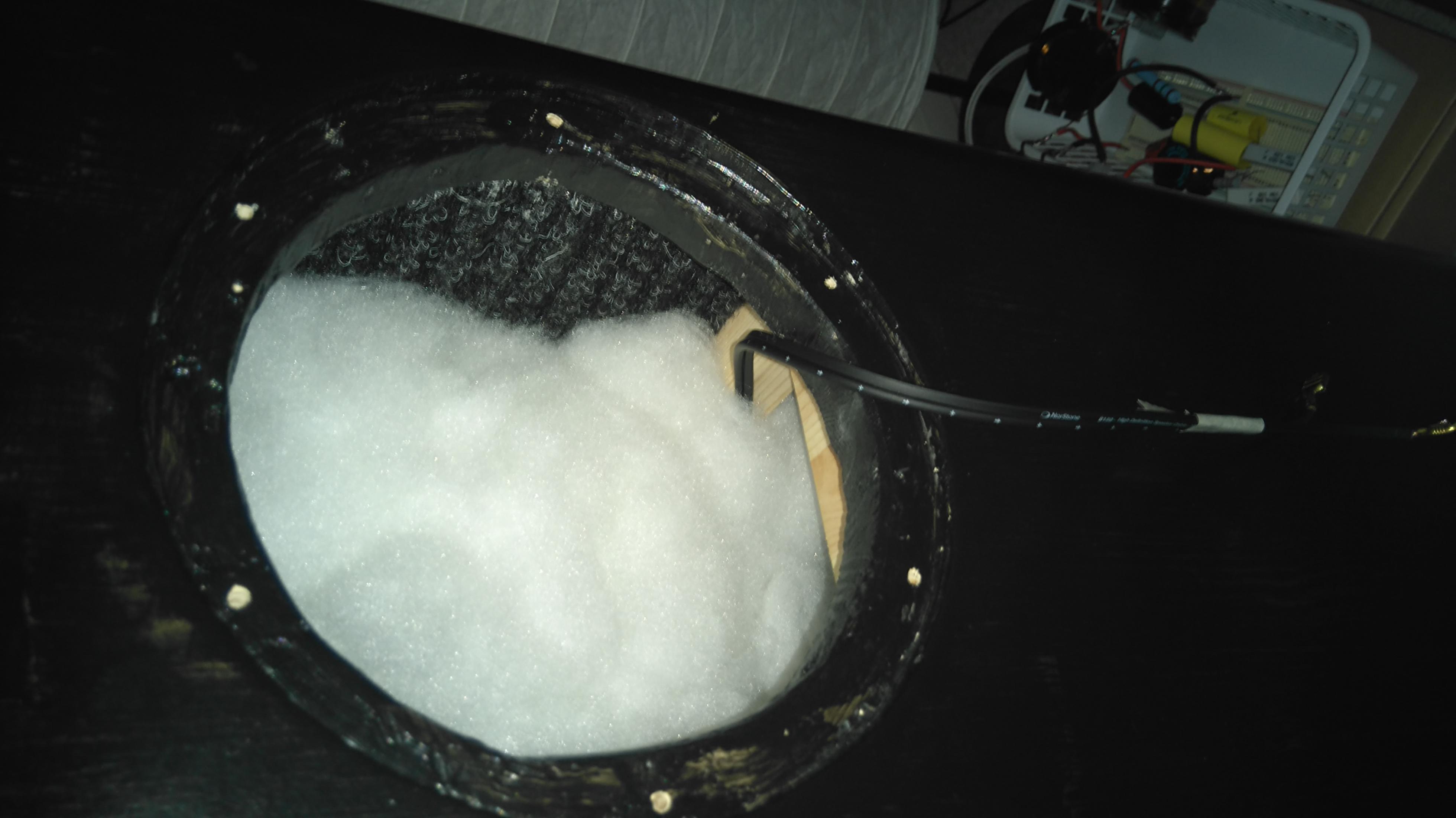

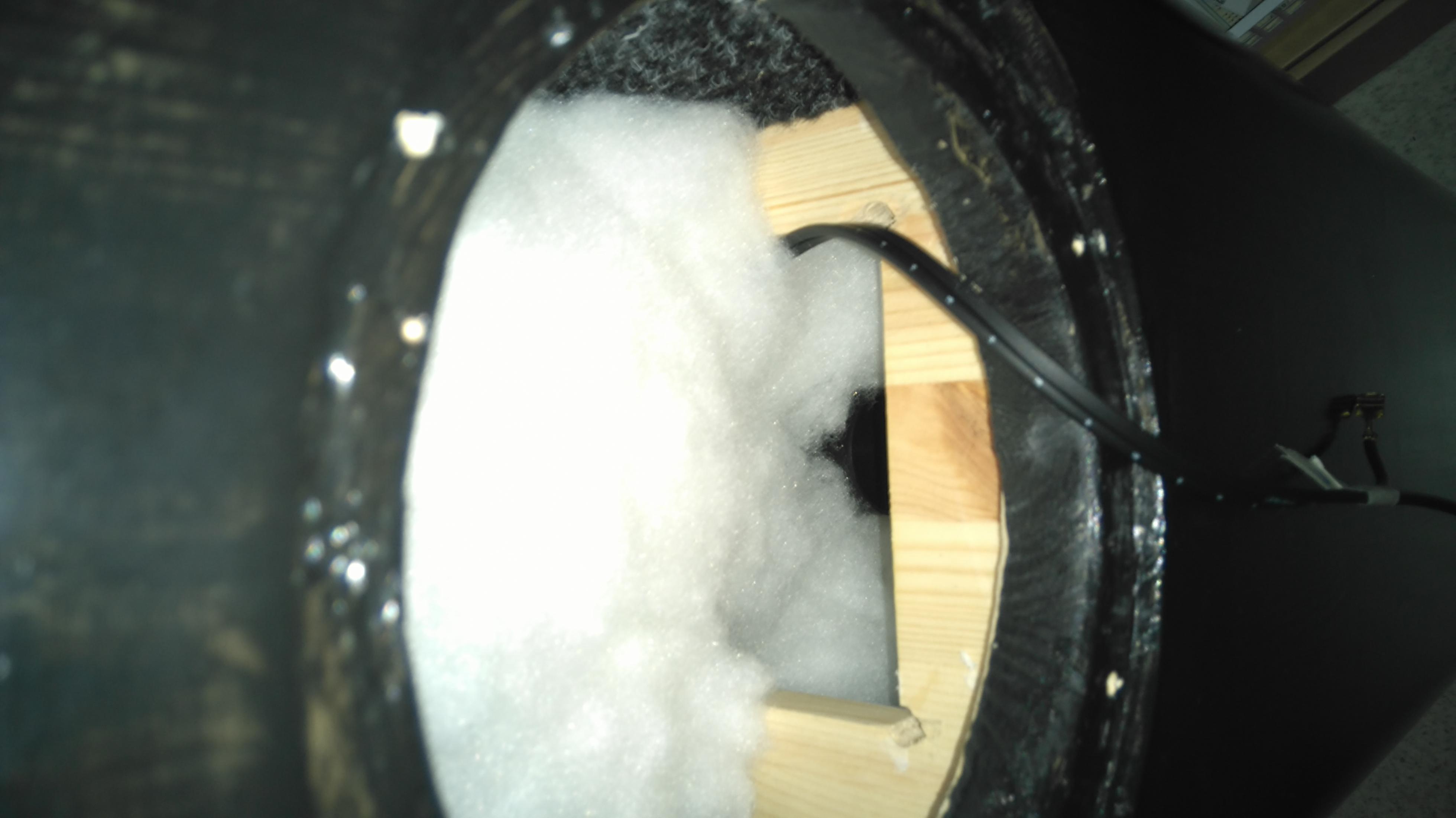

The both speakers are assembled now, drivers connected with abikos so I can adjust the amount of filling, length of ports etc. The cabinets are about half filled with polyester wadding, 500 g each approx 40 liter cabinet, so the filling as in the original Idunn. There's clearance from woofers to reflex ports, no filling between them.

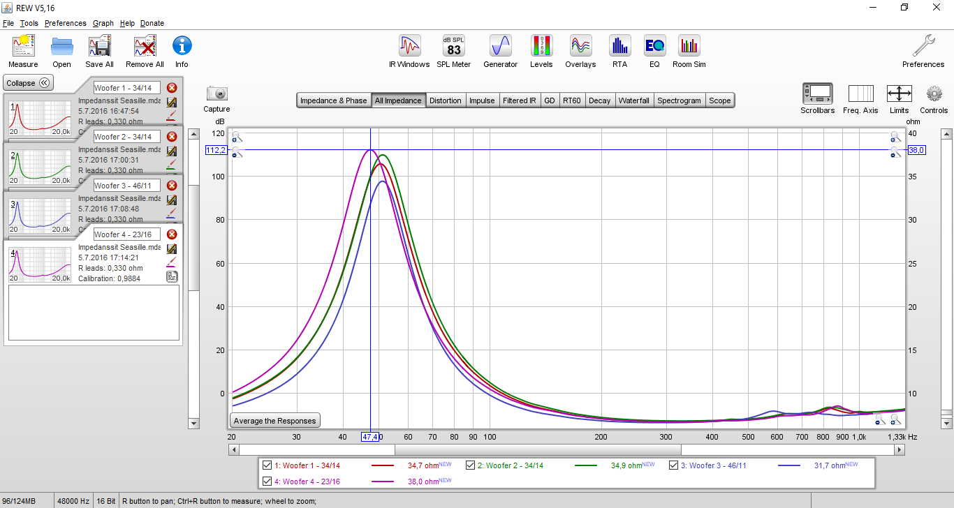

The newest U18RNX/P, straight from Seas factory, measured at clearly lower Fs than the other woofers, 47.9 Hz @ 1.6 Vrms, compared to the 51-52 Hz of the others at same voltage. I sent today an inquiry of the Fs discrepancies to Hifitalo and they forwarded it to Seas.

I got a reply from Seas:
"The resonance frequency is accepted within ±10% from the golden reference. The resonance of the golden unit is 49Hz when measured cold. This driver has never been run hot, so that it stays with the same parameters as the drivers that come from the production line. All of these drivers are well within spec. "
Attached: my measurements of the driver impedances.

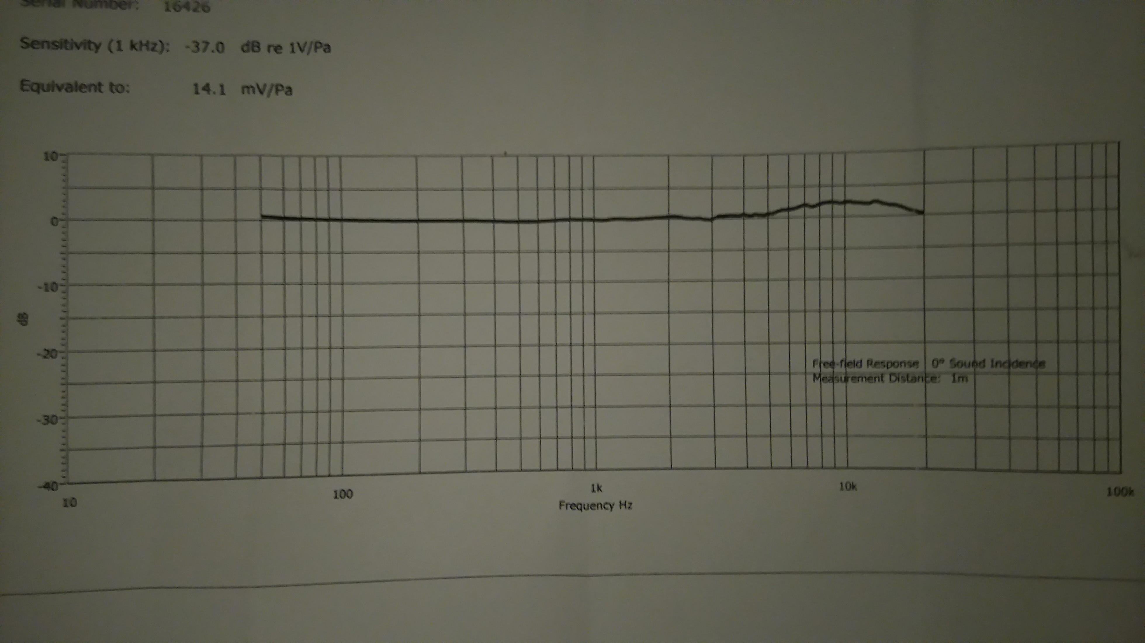

I was on the verge of getting a better microphone, but the idea of having to use 90-200 eur for a DAW before even thinking of the microphone held me back. Now that the DAW is settled, i got a Beyerdynamic MM 1 to try out. It came with an individual frequency response sheet (image), and the good people at Beyerdynamic should send me the frequency response as file soonish. The frequency response of this particular mic doesn't look bad at all, and the mic is designed for measuring purposes. Now I'll just have to figure out how to properly adjust the levels and loopback connection for time alignment with the ASIO drivers.

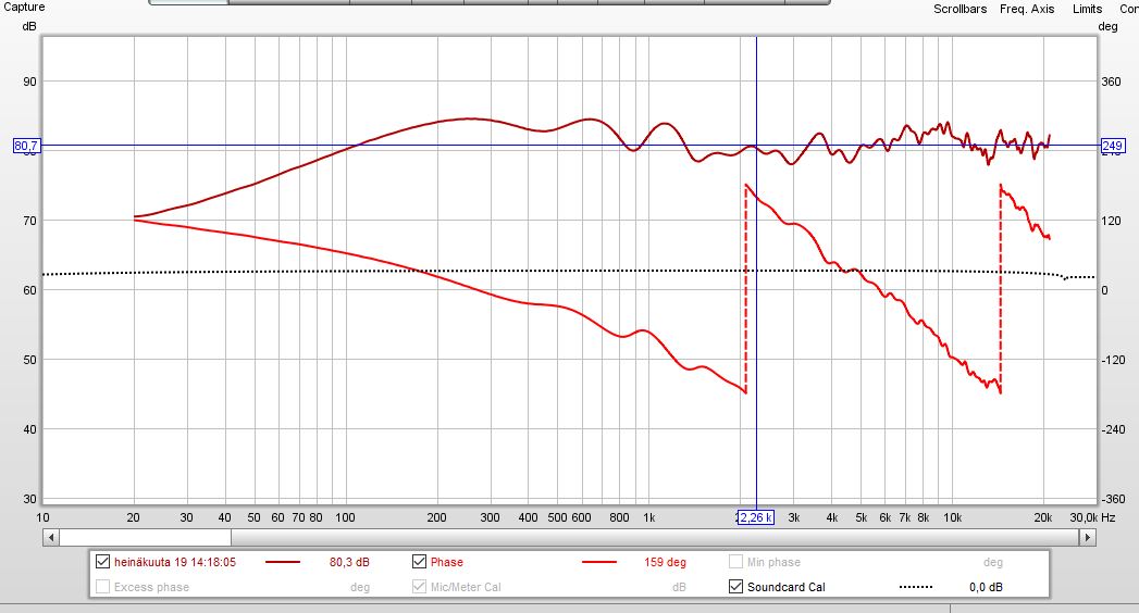

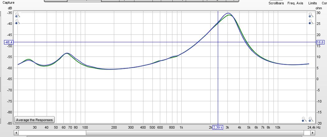

I did a little tweak after first measurements, I changed the resistor after the woofers' parallel capacitor from 1,2 ohms to 2,2 ohms to level a bump at 3,5 kHz a bit. I tried 3,3 ohms also, but that was too much. Right now there just isn't anything more I would like to change in the crossovers. The speakers sound good! Schematic of the current crossover is attached. The "weird" component values are combinations of components I used when I tried to find the right values by ear.
The measurement were made in room, microphone at tweeter height at 1 meter distance from the speaker. The measurement is windowed at about 3 ms. I don't have the calibration file for the mic yet, so the effect of mic response hasn't been removed from the measurement yet. Just by eyeballing the mic's frequency response on paper it's obvious, that the "hill" between 6 kHz and 12 kHz is caused by the mic.

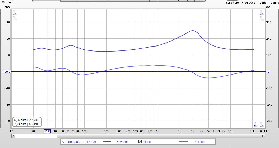

Impedances are pretty constant between left and right speakers. Impedance phase is a bit wonky around cabinet tuning frequency, it doesn't cross zero degrees. The lowest impedance is about 4.2 ohms.

What I'm yet to get right are sibilants in human voice, spoken (movies etc.) or sung. Also the crossover frequency had slipped too high (almost 4 kHz judging by simulation), which caused a dip in the power response.
It's a shame I can't measure the speakers outside. Measurements in room don't seem to get me too far, for even when windowed they're ragged and dependent of even slight alterations in mic positioning.

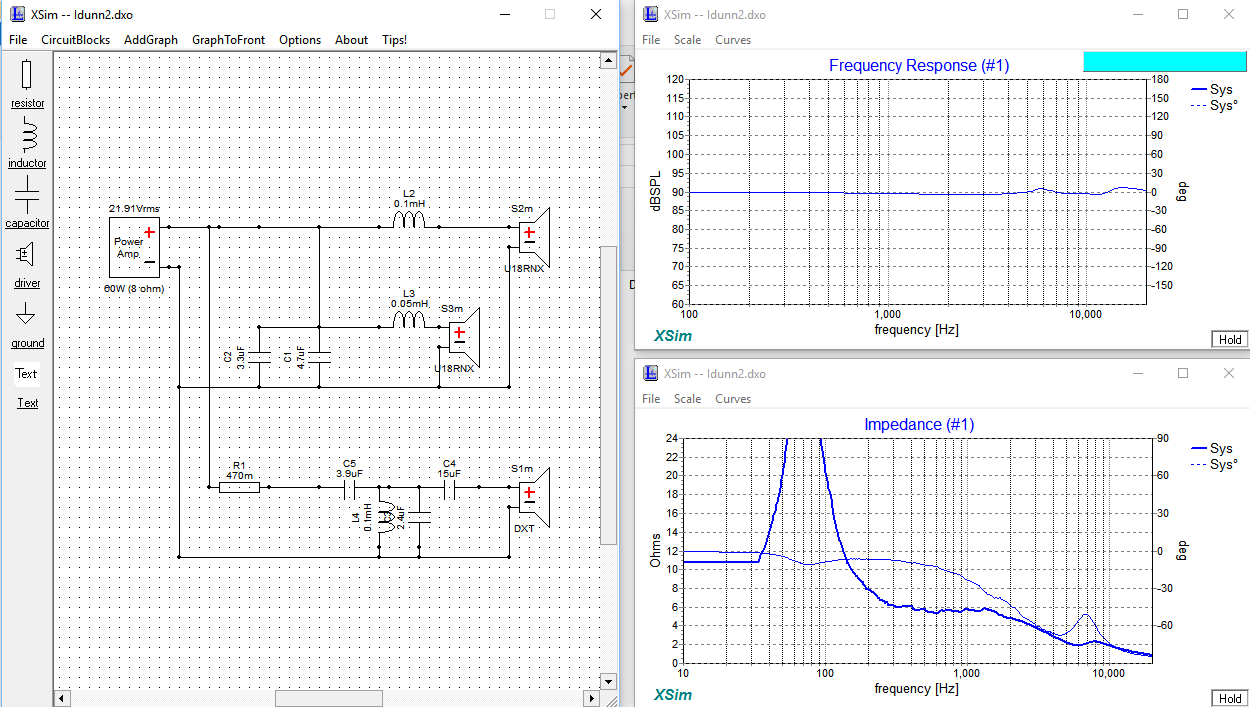

Hi all, need some advise from the experts here. i have done my idunn 2.5 ways XO base on this design. Bass is still relatively flat imo. Need some advice how i can tweak this for improvement.

In order to approximate anything resembling real life performance of the idunn 2.5, you should really create appropriate frd and zma files of the drive units. First you trace the FR and IMP curves from datasheet, then process it in a software that adds baffle step, box tuning and calculates minimum phase. After that you can load it to XSim and work on your XO.

Just to check. Is my impedance graph ok?
What did you use for SPL and impedance graphs to start with? The 0.1 mH inductor for one of the woofers, for instance, looks very strange. Impedance drop to around 1 ohm, however, would be bad for almost any amp. If you want to play around with some drivers, you should get proper graphs for them.
For Seas drivers you can download spec sheets from Seas web page and use SPLCopy (SPL Copy - Speaker Frequency Response Automatic Trace Tool) to get SPL and impedance files for Xsim. Before using the graphs it is wise, though, to compensate for baffle step. You should remove the influence of the baffle used for measurement and add the influence of the baffle you're planning to use. I recall I used Jeff Bagby's Response modeler spreadsheet to do this, but I would still like to find software more suited for removing the influence of one baffle and adding another. Seas provides dimensions for their measurement baffles and boxes on their website.

I had these info in placed alrdy in my xsim alrdy. Had been trying to get the right frequency by meddling with the placement of the components without understanding the importance of the impedance graph. Am lucky to be able to obtain advise from u guys.
