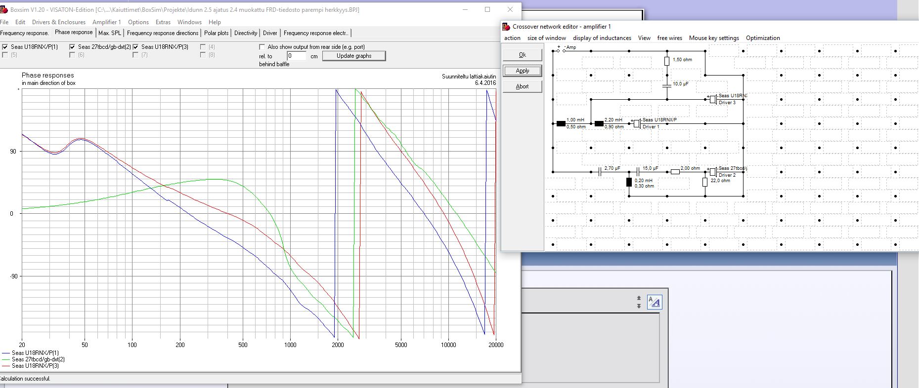

I've been considering that. It would require only one port, no need to pass cables through the divider etc; just generally easier to build. If I'd be using double woofers just connected in series or parallel, I'd do that.
However, in the cascaded parallel design the .5 woofer gets more inductance than the primary woofer, which shifts its phase more than the primary woofer's phase is shifted. In simulation they get gradually out of phase above 60 Hz. The phase shift at 100 Hz is about 15 degrees and at 200 Hz it's about 20 degrees (see the first post of thread). The shift gets up to approx 40 degrees at XO point, but of course at that point the .5 woofers SPL is about 11 dB lower than the primary woofer's SPL.
The 0.5 woofer also gets more DCR than the primary woofer, 0.6 ohms or so, which raises it's Qts.
Because of the phase and Qts difference, I'm quite hesitant to put both woofers in the same chamber.

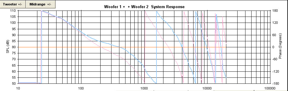

I'm not sure what you have done in your simulation to have such
driver phase response difference at low frequencies. This is how
it looks in PCD. Mic position is a tweeter axis (0 deg hor.; 0 deg vert.)
At about 165 Hz there is an anomaly in your phase graph. Have you done
any splicing here?

No, I haven't done any splicing. The anomaly is probably caused by BoxSim, it calculates box response from driver T/S parameters until "around 2fc", apparently in this case until 165 Hz; Woofer fc is 56.11 Hz according to BoxSim. It then splices the imported frd file (in this case copied from datasheet) to the calculated box response from that point on.
The phase was minimum phase extracted by Bagby's spreadsheet in the first post, I think. I tried now with minimum phase calculated by BoxSim from SPL (graph attached).
I don't think it differs that much from the XSim graph you posted. In your graph there's 30 degrees between two vertical rules, so the phase difference in your graph is about ~10 degrees at 100 Hz and 30 degrees at 200 Hz. In my graphs there's 10 degrees between rules, and the difference is ~10 degrees at 100 Hz and 20 degrees at 200 Hz. In your graph the difference seems to start a bit later, but your graph is vertically a bit more narrow, so the difference doesn't show so well at ~70 Hz.
I'm not sure that BoxSim takes into account the higher Qts caused by series resistance though, for adding resistance only seems to reduce SPL where woofer impedance is at it's lowest, i.e. at ~100-200 Hz, whereas the higher Qts should cause an opposite effect. The crappy thing about BoxSim is that there isn't any documentation or official manual out there for one to check how it does things. Or at least I haven't found one.
The real XO work will start when I have the drivers and get actual measurements and see how they really behave. I wouldn't expect these simulations to be far off though.
And now that I think about the low frequency difference in our graphs, of course your SPL is from 10 liters closed box and mine is from 22 liters reflex box, so they're bound to be a bit different.
And you were talking about PCD, but I for some reason thought you said XSim. I don't think that should make any difference though.
Got it now. The difference was there because you calculated
with dcr of 1,6 and 1,9 along with splicing error. For dcr I was
using 0,25 and 0,5.
