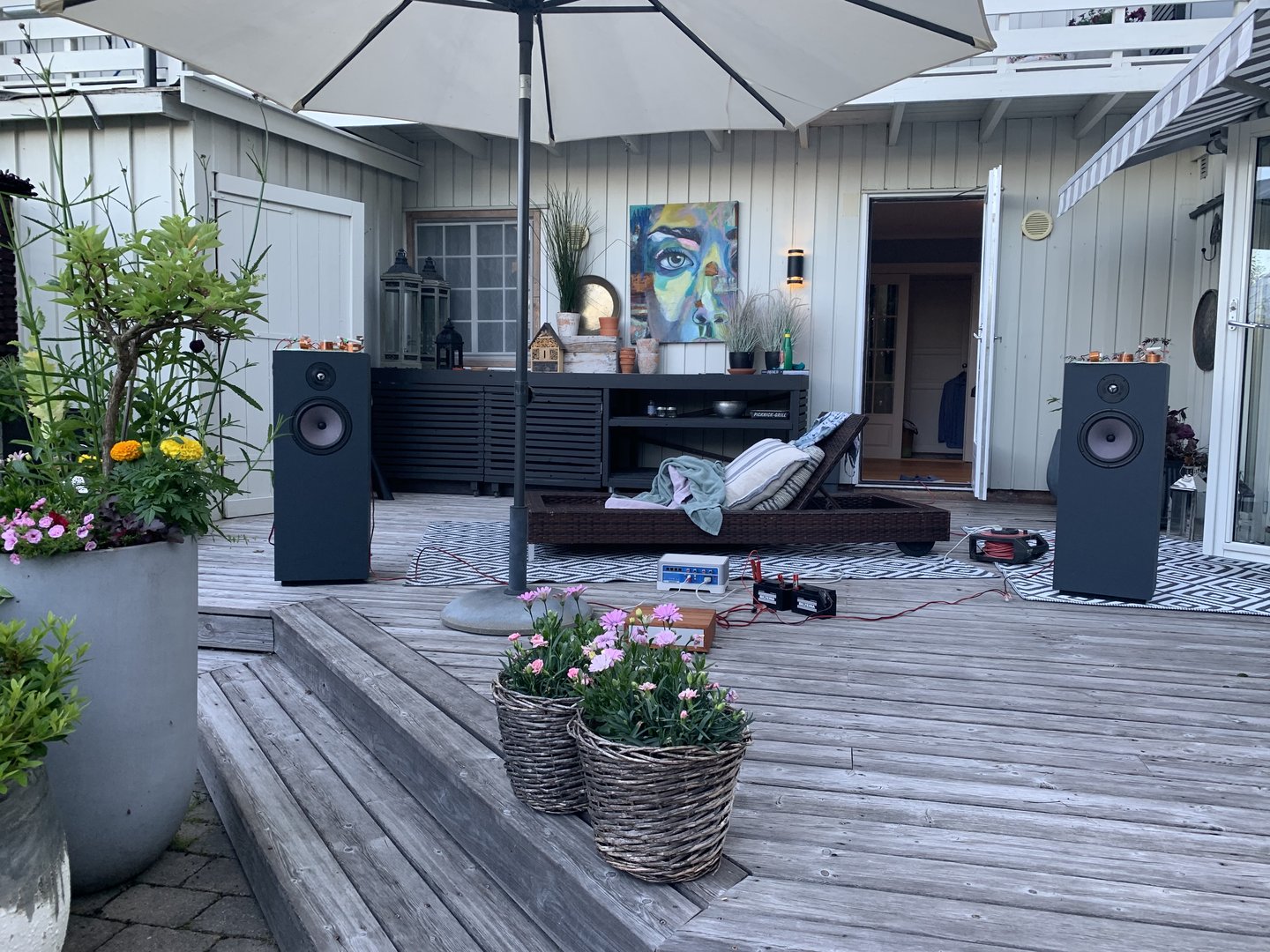

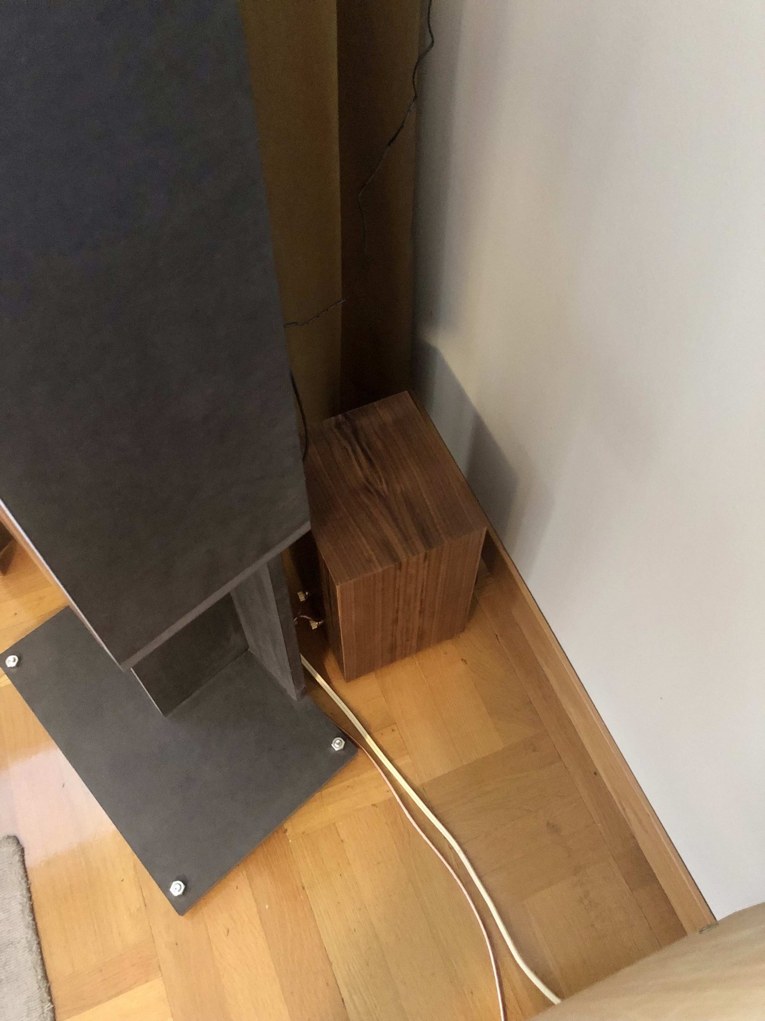

My implementation using the Seas 8" fullrange is as follows:
The pictures show fullrange wide box, and the reversed bass placed at the floor behind the fullrange stands, the lights on top is a DIY "audiophile nixie clock"
- Sealed wide box for the 8" fullrange for directivity (see Grimm LS1)
- Crossed at 250 hz to a Seas 8" bass aludriver
- Sealed Seas 8" bass reversed direction, plays into the front wall for directivity, (see Dutch & Dutch 8c)
