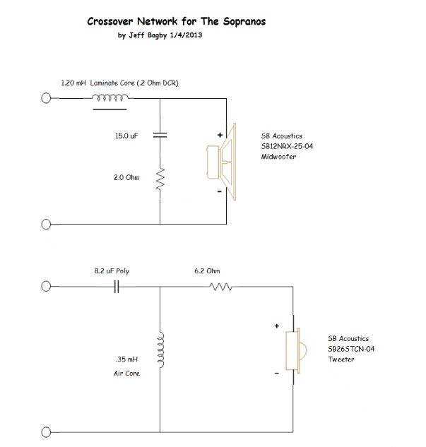

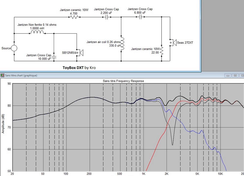

What did I say about the SB Acoustics 4" woofer getting 1mH and 10uF? Seems I was right...😀
Not too impressive IMO. That 6kHz woofer resonance should be addressed. 🙄

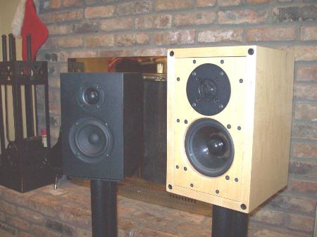

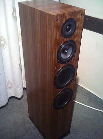

fakeout you are new and interested, I can tell. Frankly if you want a great speaker that goes loud without effort, 3-way is the way to go.
3-Way Classic
But for a newbie, a nice small 9L reflex 2-way is a good start.
SEAS CURV

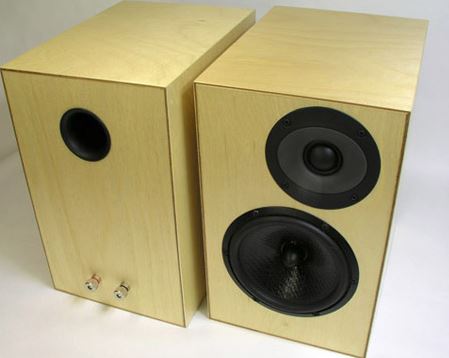

lol, I finally found what I think I might like. A kit and a design for 4.7 liter cabinets with brand name drivers. The Sopranos by Jeff Bagby.
Sopranos (Pair)
Of course, by the time I get money in May to buy them they may be sold out. Haha, whatever I guess. I wish it came with a birch plywood flat pack though with the driver cut outs already done. A couple of comments I like about these speakers is they can be used in different placements and Jeff Bagby said they sound realistic.
Sopranos (Pair)
That's a happy choice. Jeff Bagby is one of my favourite designers. 🙂
The Sopranos are TINY so don't expect huge bass, but they will doubtless deliver good midrange if you use them in a small room. SB Acoustics make great drivers affordable. Vented bass has always done the business for me.
The issue with two-ways is they don't go loud comfortably. Various reasons for that and 3-ways or series MTM's (it's a simple conversion) are better. But you will have a good time with these. Go for it. 😎

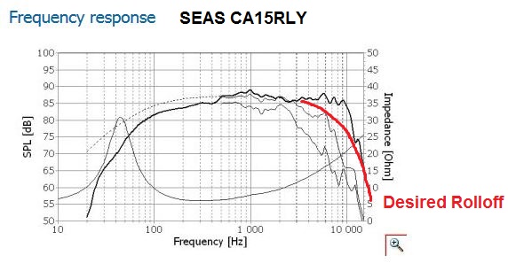

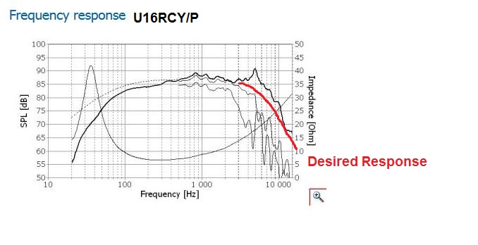

Here's a quote from Lynn that pretty much explains how speaker design works:
Question: See if you can see where Lynn's notch or tank goes with these two SEAS speakers...not hard, is it? 😎
When working with rigid-cone drivers, there are some hard choices to make: if you lower the crossover frequency to minimize driver coloration, tweeter IM distortion skyrockets, resulting in raspy, distorted high frequencies at mid-to-high listening levels.
If you raise the crossover frequency to improve the sound of the tweeter, the rigid-driver breakup creeps in, resulting in a forward, aggressive sound at moderate listening levels, and complete breakup at high levels. (Unlike paper cones, Kevlar, metal, and carbon fibers do not go into gradual breakup.)
With the drivers we have today, the best all-around compromise is a 2nd, 3rd, or 4th-order (12-24dB/Oct.) crossover with an additional NOTCH filter tuned to remove the most significant HF resonance of the midbass driver.

The answer to the much more interesting question of notching the SEAS bass cone-breakup is 5kHz of course. This happens to be particularly easy to calculate. 10uF and 0.1mH and 1.5R on a notch, or 1mH bass coil and 1uF and 33R across it with a tank. Or any other combination that preserves the product. What is nice about this correction is it lines phase up nicely too. 😎
Jeff Bagby "The Sopranos" said:Placement Applications:
As I mentioned earlier, this speaker was design to work as well as possible in a wide range of applications. I listen to small speakers typically on a stands away from the walls. My brother, on the other hand, will have these on shelves or wall brackets flanking his TV. I also knew that some people might like them on a desk as computer speakers powered by something like the Dayton DTA-100 or other tripath amplifier.
So, I compromised the tonal balance to fit between to extremes of boundary reinforcement. The sound is a bit different, but whether sitting free-field or against the wall (with a couple inches for port clearance) or on a desk, they sound satisfyingly balanced to me and I am quite happy with them.
