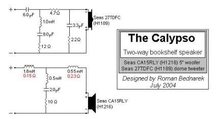

I found this design:
Calypso
Anyway, I wonder if anyone has any comments on this. Like, is the driver too old, is a vented design OK for that driver or better sealed, etc.?

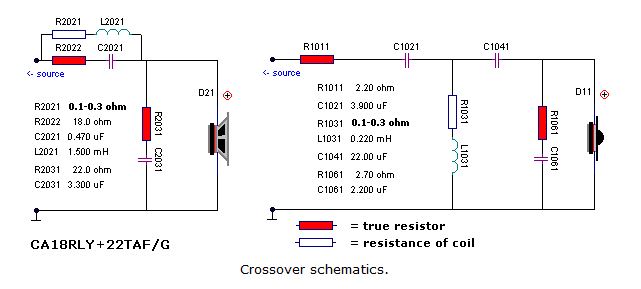

By the way, I found this one also, but I just noticed it's for the larger CA18RLY:
CA18RLY/22TAF-G
Oh OK, I was thinking about that driver because there are free plans for it. Uh, I can't tell which ones are newer. Well, anyway I can look at the other Seas but I also prefer finding free plans for them. Looking for smallish desktop. I know people will say you need minimum 6.5 inches for adequate bass.

FWIW, the CA15RLY is a driver suited to around 14L of bass reflex cabinet. That's how it is with a Qts around 0.34. A closed box driver is nearer 0.5.
I don't suppose Troels Gravesen has ever published a duff design.

CA18RLY/22TAF-G
But if heavy bass is your bag, a larger bass coil and cabinet helps. Thus the second design is going to have a lot more. The metal 22TAF-G is a gem, but you could fit a less loud 22TFF soft-dome and just reduce the treble filter input resistor to brighten it up.
The Calypso CA15RLY is a good bass filter with a nice notch around 5kHz and will be bassier than Troels' design due to bigger bass coils, but the treble filter looks overly fussy and I would simplify it. None of these cabinets are overly complicated. Just simple bass reflex at heart. Bracing is optional.
I enclose a couple of filters that will work with most 6" paper bass units. The red resistors are your level adjustment. See these filter things are mostly the same! 🙂

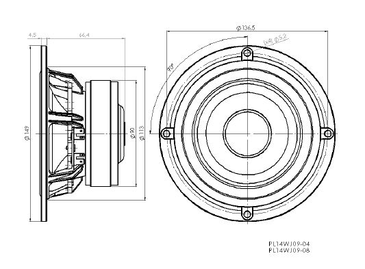

Scanspeak and Vifa are actually all part of Tymphany. Nice drivers, but VERY pricey at the top end. This looks affordable, and Wilmslow Audio's Mercury Cabinet will house the 149mm and 104mm drivers in about 11L IIRC:
Vifa PL14WJ-
The Vifa PL14WJ is rather similar to the Scan-Speak 15W/8434G00, IIRC. Just vented on the bass.

Ah, quite right, I'm sure. The Vifa PL14WJ is hard to find these days, and only made in limited runs by SOMEBODY! 😀
Somebody is using the same tooling though. Apart from the bass vent and change of cone material, the PL14WJ is remarkably similar to the Scan speak 15W-8434G00. Useful if you want to reuse a cabinet. 😎
That Vifa PL14WJ looks interesting. I'm still wondering what I want to do but if anyone was looking for these, I know there's a kit at solen.ca at Solen Electronique Inc.
