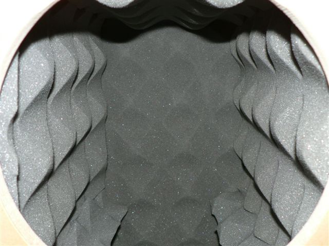

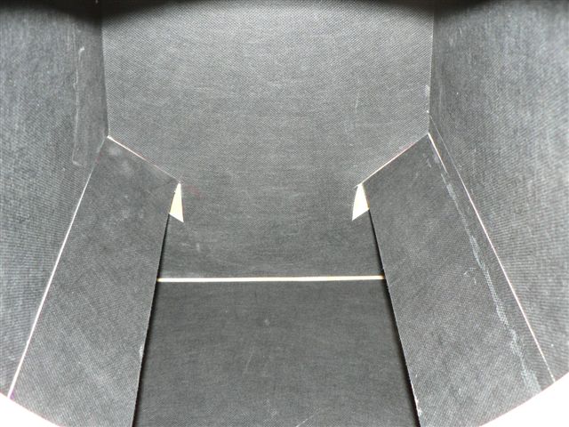

Damping materials - were you able to source these in NZ? (ie. the 5mm sound deadening material - what is it?, acousta stuff and acoustic foam).
Also - what aare your listening impressions? Are you able to measure and post some graphs?
David.
Hi heres the site for the sound proofing. www.forman.co.nz
The first layer=Acoustop dBX is a synthetic rubber mass loaded barrier used to add extra mass or hung as a barrier curtain for increased transmission loss and noise reduction. Available with a scrim backing or foil facing.
The second layer is called studio foam .It comes form the same place but I can not find it on there site.
Acousta-Stuf I cant find in NZ I get it from Madisound

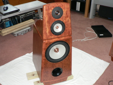

Listening impressions
Where do I start? I'll compare them to my Seas Thor speakers which I have been listening to for over a year.
First thoughts, very dynamic, lots of mid range and very open.
The sound stage is huge and speaker placement is not fussy.

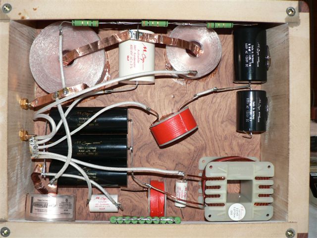

After a couple of days I need to tweek the mid and tweeter levels a tiny bit but I new this would be the case because I used bigger gauge coils than the xover specified.
Tweeter = It is the same as the Thor but its better in this setup. I put this down to the caps and maybe the xover, its a bit higher.
Mid = So nice, what more can I say. The thors are lacking in comparison.
Bass = Warm, tight, low. A friend described it as musical.
Over all happy happy happy ! They dont miss a thing. Open but not fatigueing, you hear every little string fade, the bass is powerfull. I had no idea what I was missing. So many cds and dvds to listen to all over again what a terrible job 😀
