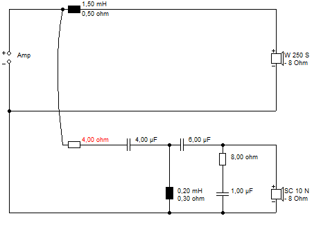

I thought this was all FEROCIOUSLY difficult, EaZy, but actually, if you understand the basic problem, it is doable. 🙂
That outside offset to the tweeter is doing a goodish job of time aligning the tweeter. Effectively it sets the tweeter back relative to the woofer. By my estimate, we need a steepish tweeter crossover that has a -9dB point at 3kHz if SEAS's frequency response is to be trusted:
SEAS A26RE4X.
By my estimate you need to set the tweeter back about 3cms. relative to the woofer, and then phase is really rather good. A 3kHz crossover like below really doesn't put too many demands on the tweeter or impedance. You can ignore the woofer filter, that is just my approximation to the frequency curve.
You can do such an offset with a sideways offset approach as in the original kit, or something like this:
But trust me, time alignment and phase is the issue to getting this combination working well. It may be you do well to attach the front baffle with battens, mount the woofer up top, and have a separate tweeter enclosure on top. 😎

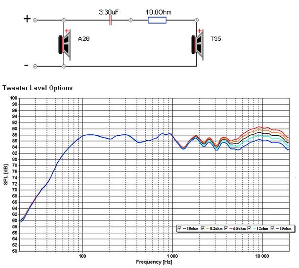

Hi all!
Very interesting speaker. Heaven't build it, unfortunately it's simply too large for my very small listening room. But there is one thing with this speaker that puzzles me...
If you have a look at the attached picture of the crossover and the frequency response for different series resistor values, you'll see that the crossover frequency doesn't change very much with these different series resistor values. Now, from what I've learned, the value of a series capacitor depends on both, the desired crossover point AND the resistance after the cap. In this case the cap is always the same 3,3uF, but the series resistor and the tweeter (6 Ohm nominal) make completely different resistor values, from 12,8 ohm (with the 6,8R) up to 21,0 ohm (with the 15R). So, the 3,3uF cap "sees" resistor values from 12,8 to 21 ohms without any obvious changes in the crossover frequency.
How is that possible?
Thanks a lot!
Martin
