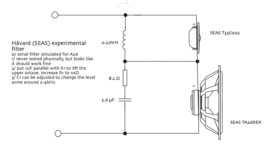

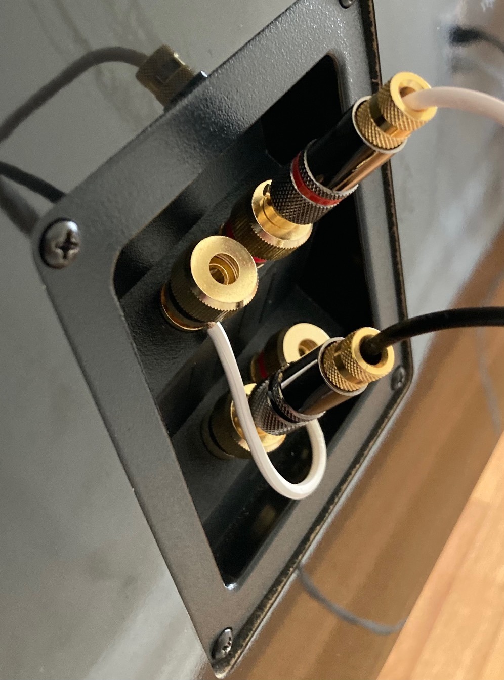

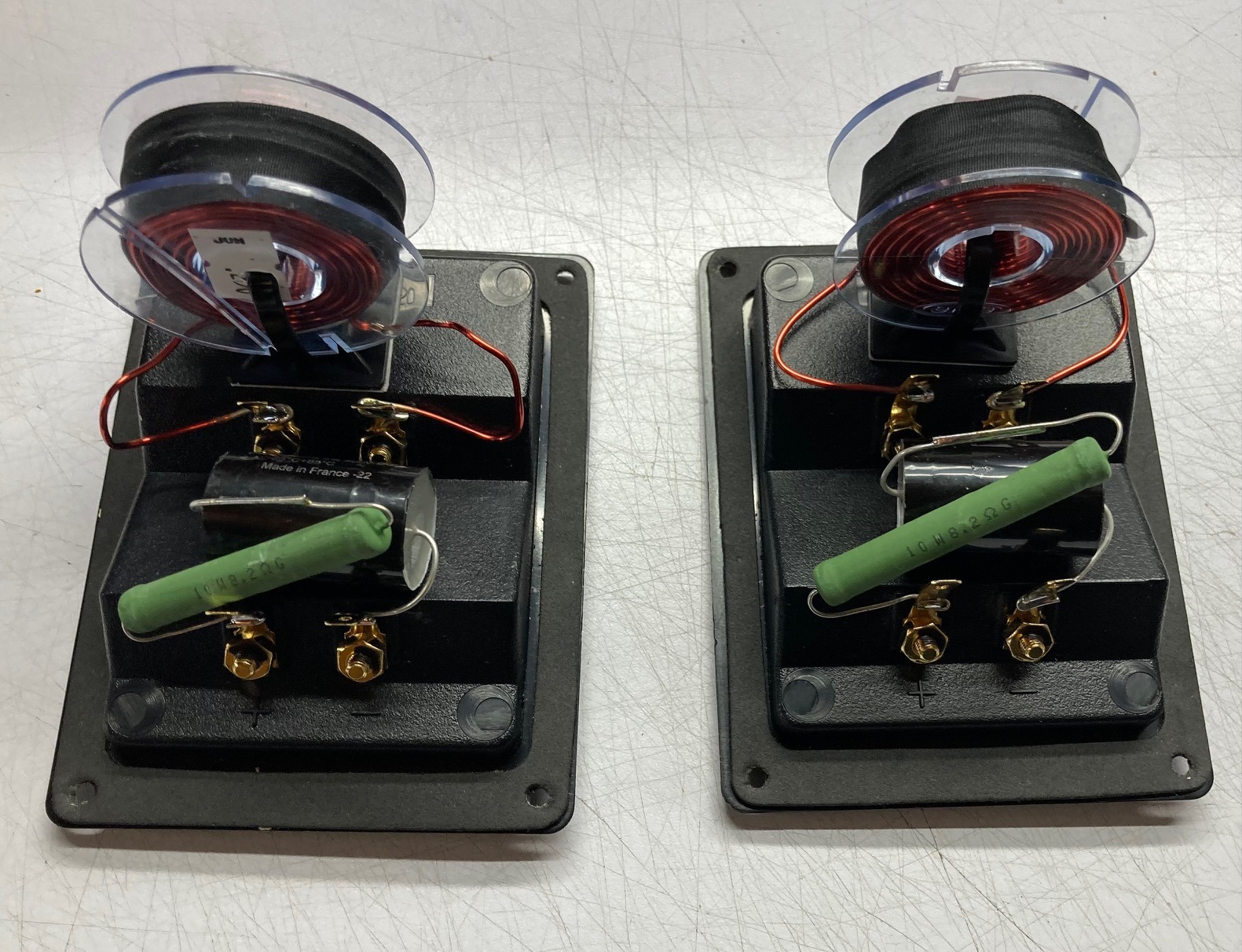

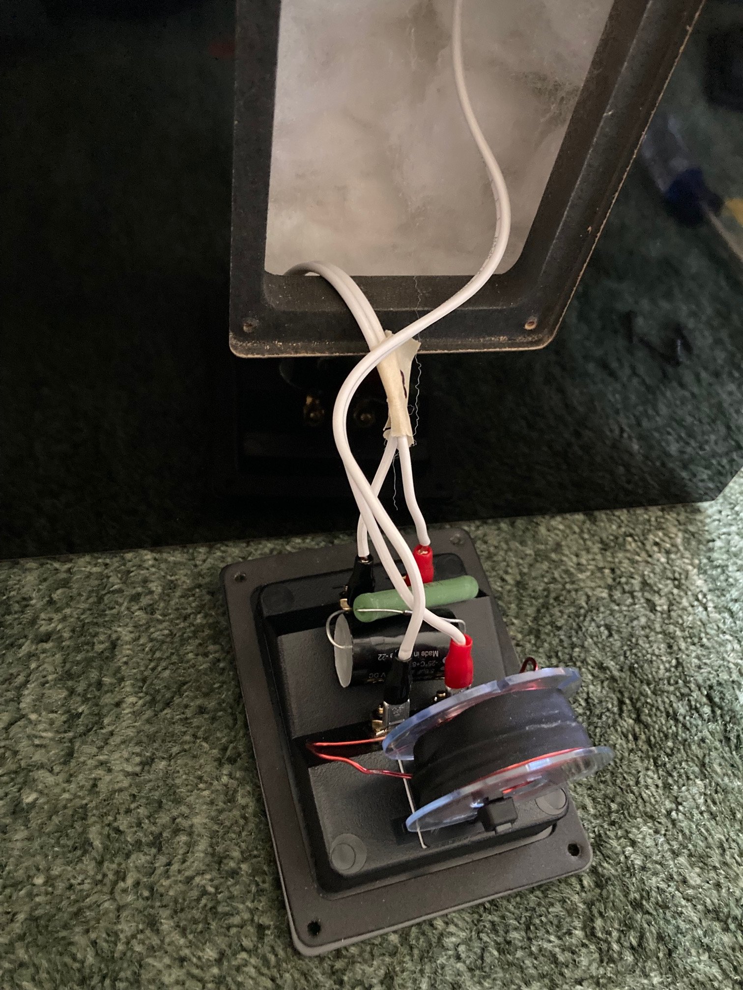

I built the Håvard crossover. The coils I sourced are a little bit on the low inductance side, spec'd at 0.25mH and measuring more like 0.22mH instead of the 0.26mH called by the design, but the resistor and cap are correct at 8.2 ohms and 5.6uF. Initial sound impressions downstream of an F1J (LU1014Ds as differential pair gain devices) is of a smoother and more even sound than my earlier series crossover. The bass I like is there too, prominent and controlled, the shunt resistor I was using seems dispensable here. I like this crossover a lot and plan on much more listening with it.
If you have a pair of these drivers and are disappointed in the bass response, going series crossovers might surprise you.

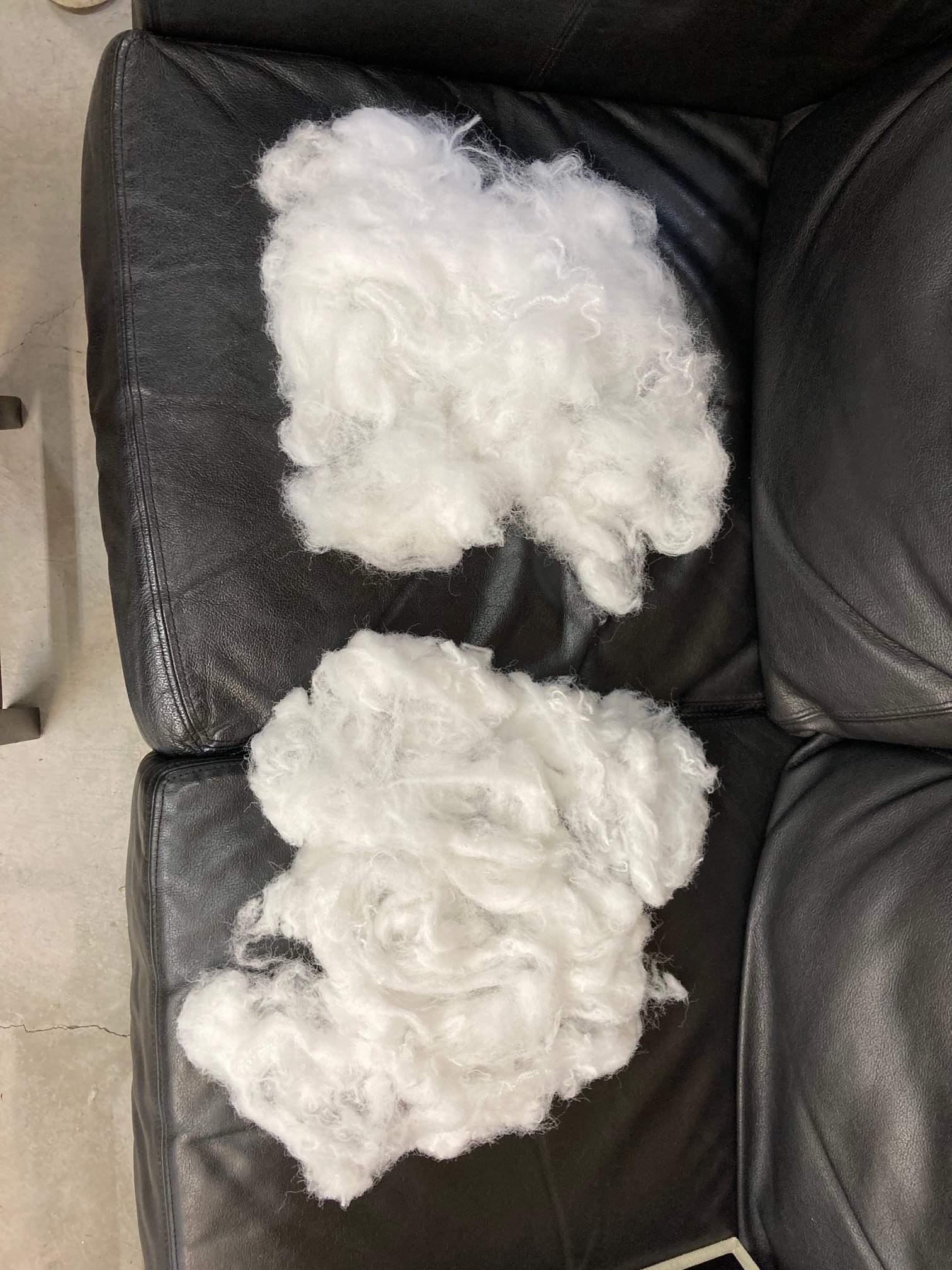

Pictures!! Would love to see your damping material and the polyfill...how you installed.
The Seas docs recommend 50Grams of polyfill per cabinet..and 12 grams for the port...which Madison uses a foam piece the
same as the foam for the damping...

Wondering how to mount the caps internally...some hot glue to their rear foam, some mount just soldered to the cup structure.

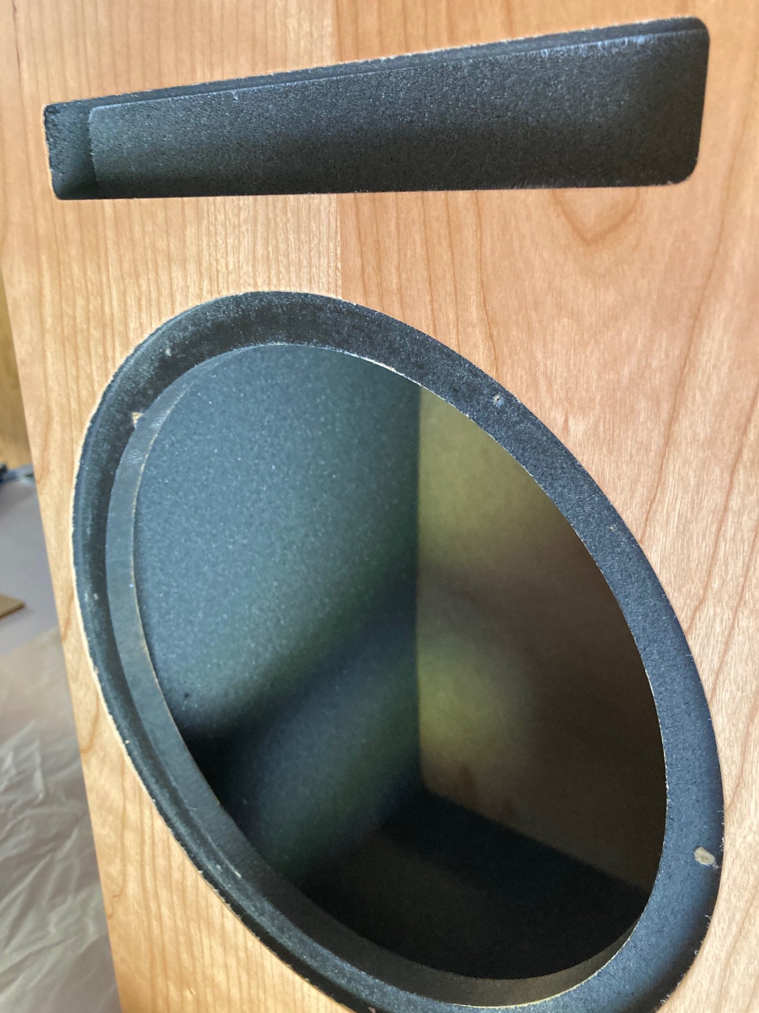

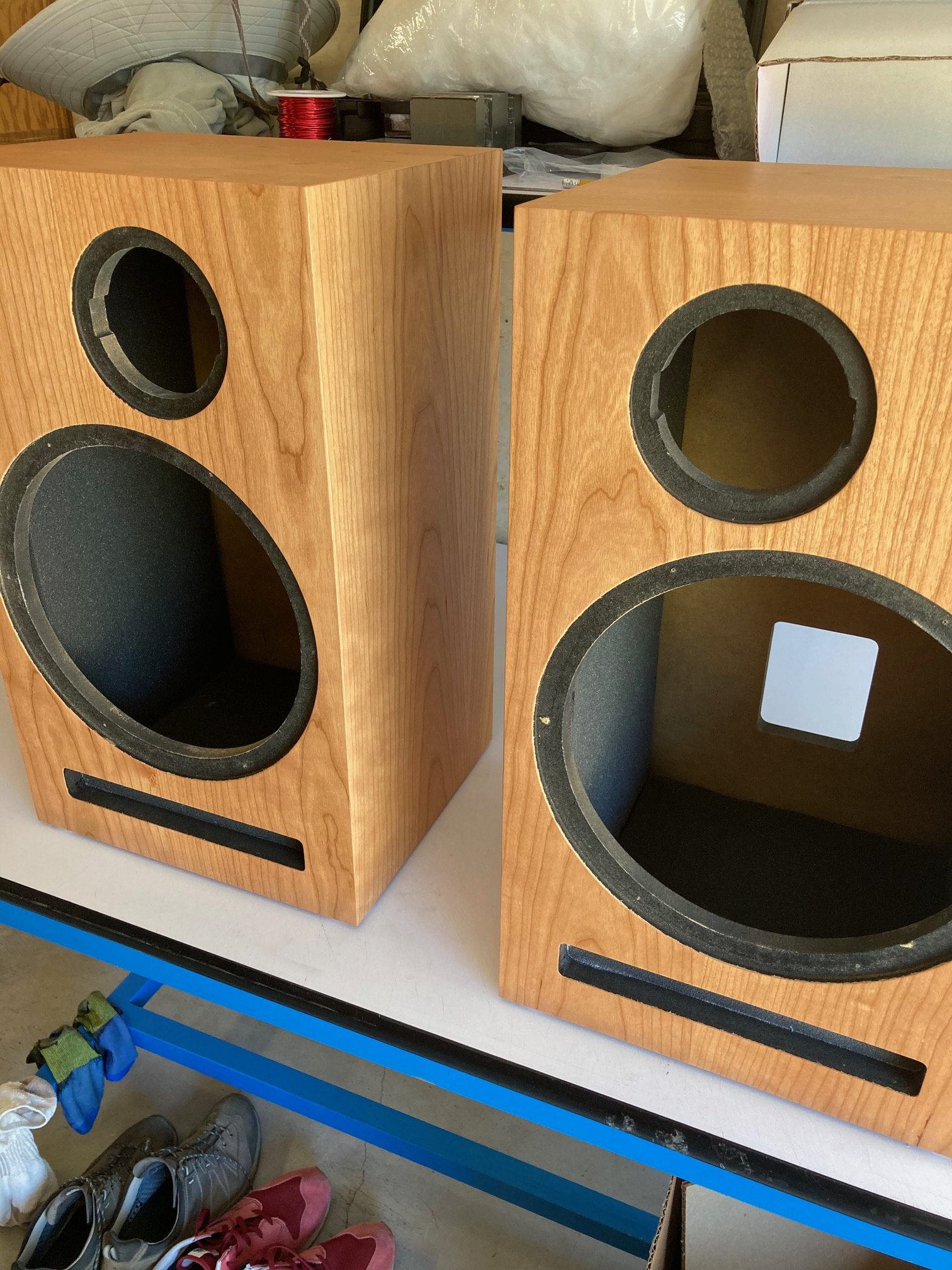

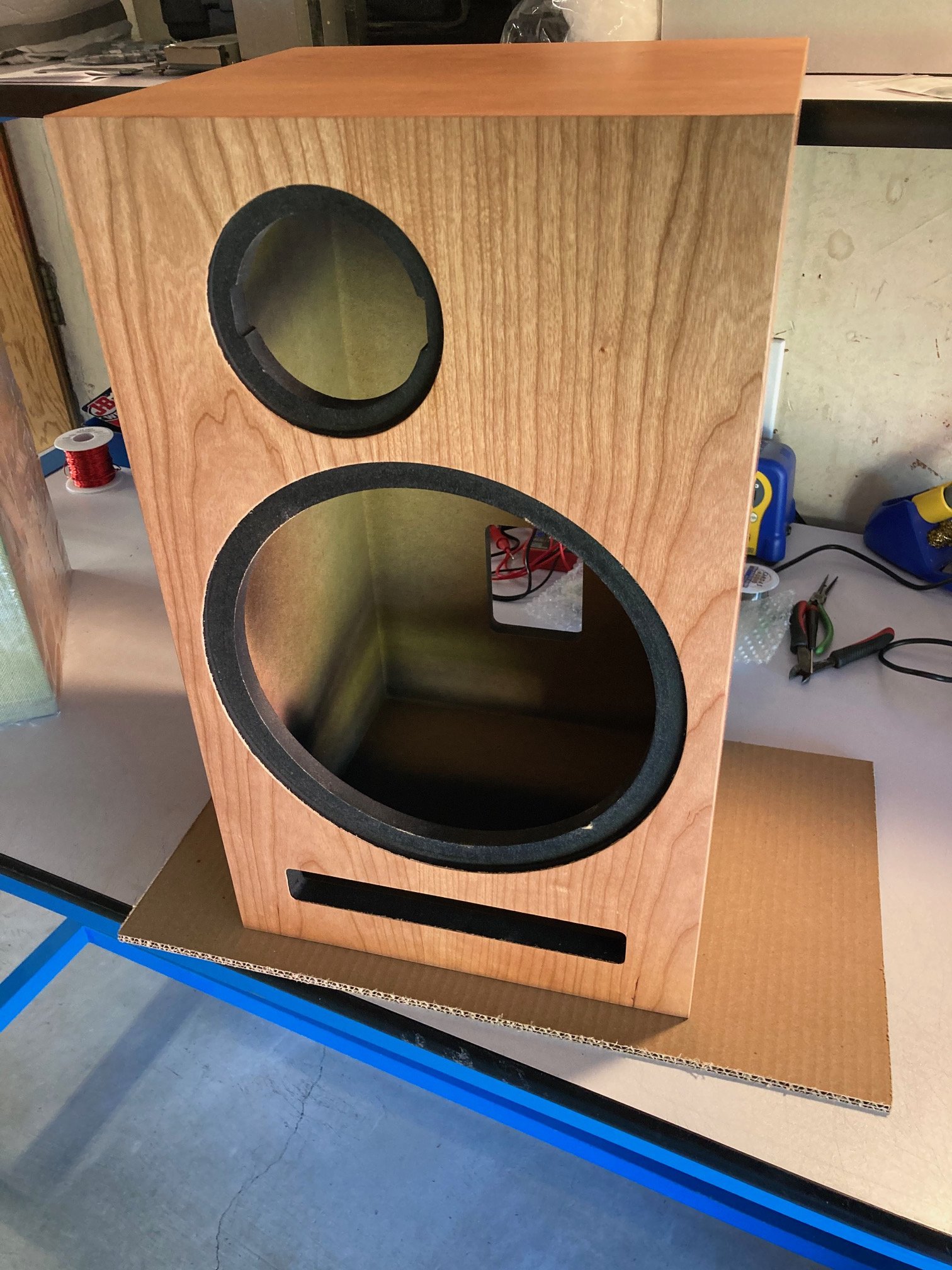

Ah man, it turns out I didn't take as many pictures as I thought, just a few showing the cabinets before I glued in the foam, and some with foam glued in. Here they are.
The most important thing I think, is drill pilot holes. The MDF used in these cabinets is high quality, and I've swapped out the binding post cup multiple times without noticeable loss in the bite of the wood screws (it's where I mount crossovers), but there's no point pushing one's luck and getting a crack in the MDF because there wasn't a pilot hole.
Per the Madisound instructions, I just spray-glued the edges of one of the included pieces of foam and mounted it over the back of the aperiodic vent. I didn't attempt to source mesh screen material and layer any polyfill between like some of the pictures suggested.
My first build was using the standard crossover, the 3.3uF series cap + 10R resistor on the tweeter, with nothing on the midwoofer. It lacks bass, as some here will tell you 🙄. When I went to series crossovers, first mine and then later the Havard crossover, which I run now, I doubled the volume of polyfill to help with the damping. I had to buy extra to do that, and what's shown is basically the pile that Madisound sent plus the pile I added, for a single cabinet. I think it helped. The bass response with the Havard crossover, as well as the phase coherency between the drivers, is solid.
