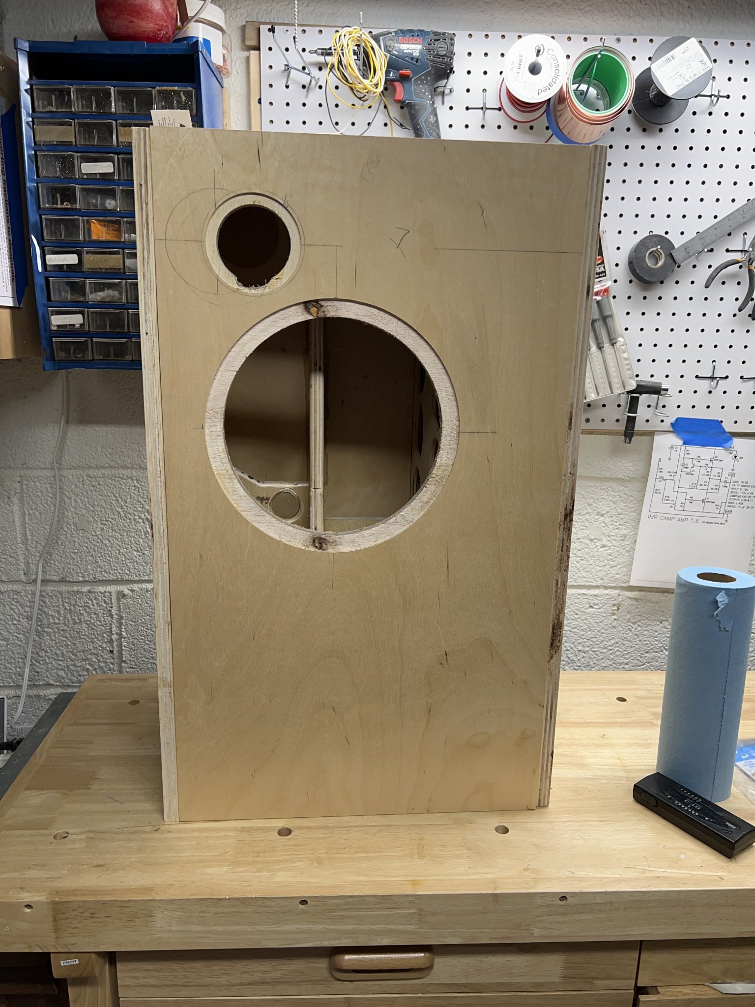

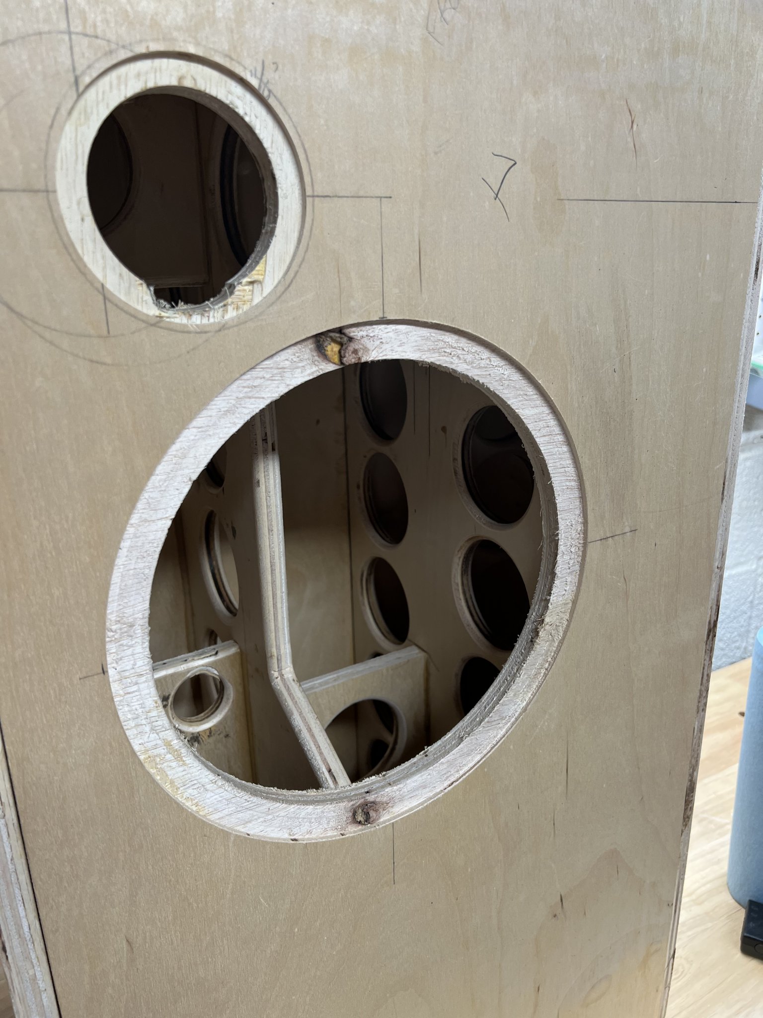

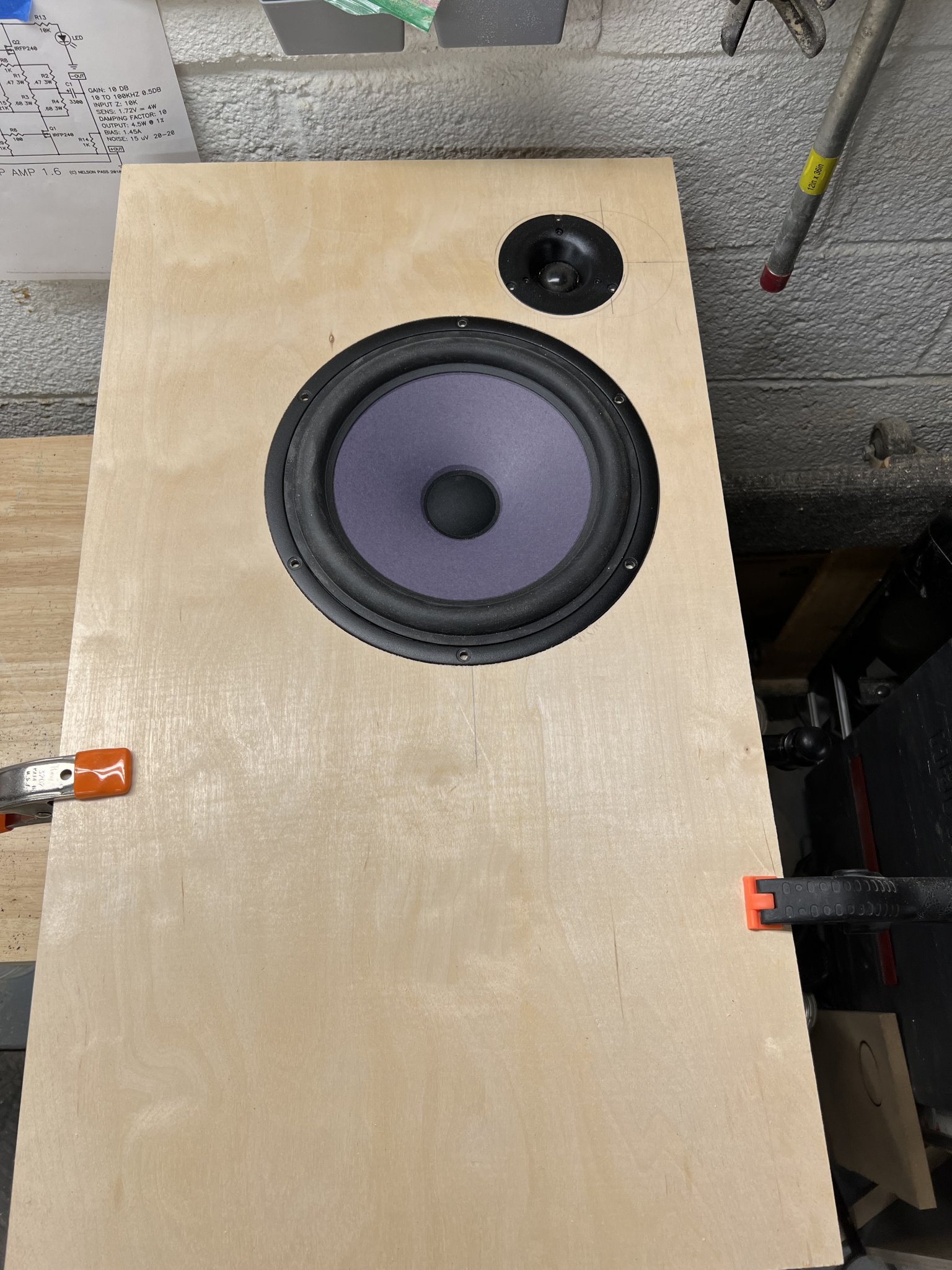

Small update today! I have the back box glued up, baffle is just sitting in place now.
This is planet10s sealed golden ratio ov81 from the great plans posted earlier.
The baffle cutouts are a bit off from plans, as I measured the baffle dimensions, not figuring out that the plan included the side dimension
I plan on finishing these, measuring, and if they work well in my space building a second front baffle properly out of a solid wood or something fancy.

@planet10 do you recommend additional cabinet panel dampening, or stuffing for this build?
I have dynamat sheets, acoustical foam panels, and acousta stuff on hand, however I'm hesitant to add extra treatment as the bracing really stiffened the cabinet dramatically, and i don't want to change the internal Volume.
Stuffing yes (the A25 is very heavily damped with rockwool), panel damping will degrade the resonance behavior of the box — it adds mass without adding stiffness wich lowers potential resonance in frequency andbroadens the Q making it both easier to excite and easier to hear.
Low density damping (like poly “sheets”) over th eholes inthe holey braces is more effective against side-to-side resonances than damping on the walls.

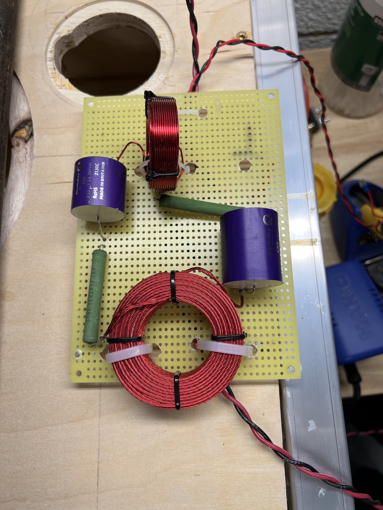

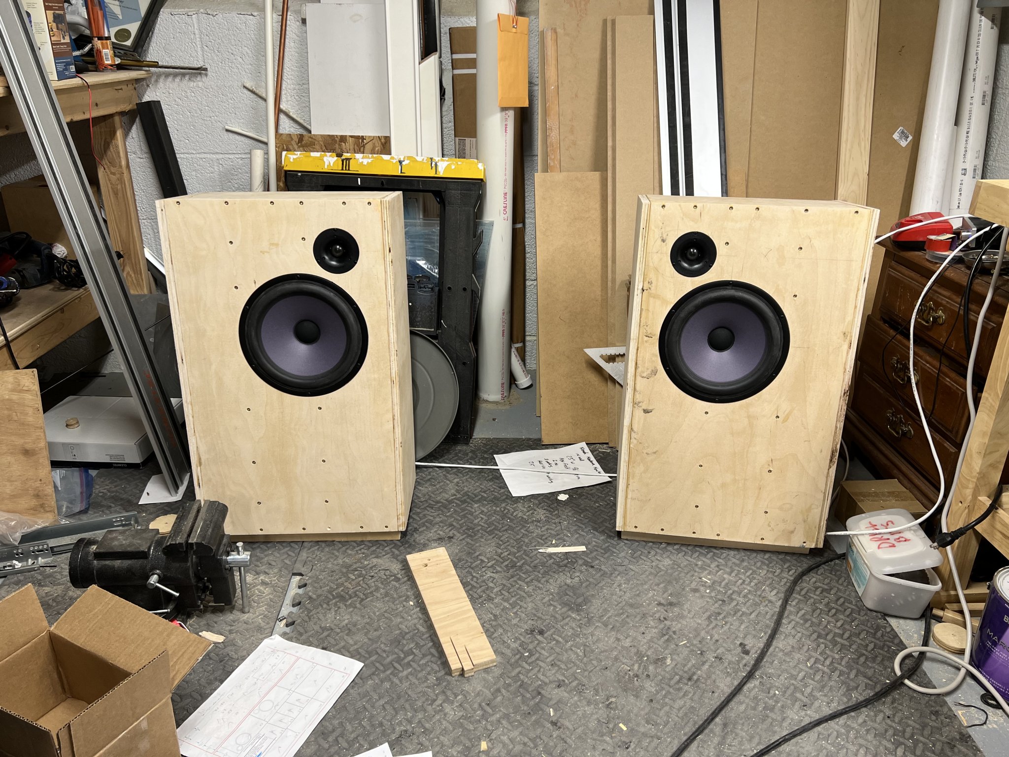

I was able to get both crossovers wired and installed the woofers tonight for a maiden run. First impressions are good! I listened for an hour in my workshop while cleaning up. I have no measurements or critical listening yet. Need to install stuffing and start measurements with my dats, and rew. This is the cat 378, golden ratio.I'm anxiously waiting for updates on this build, especially measurements.

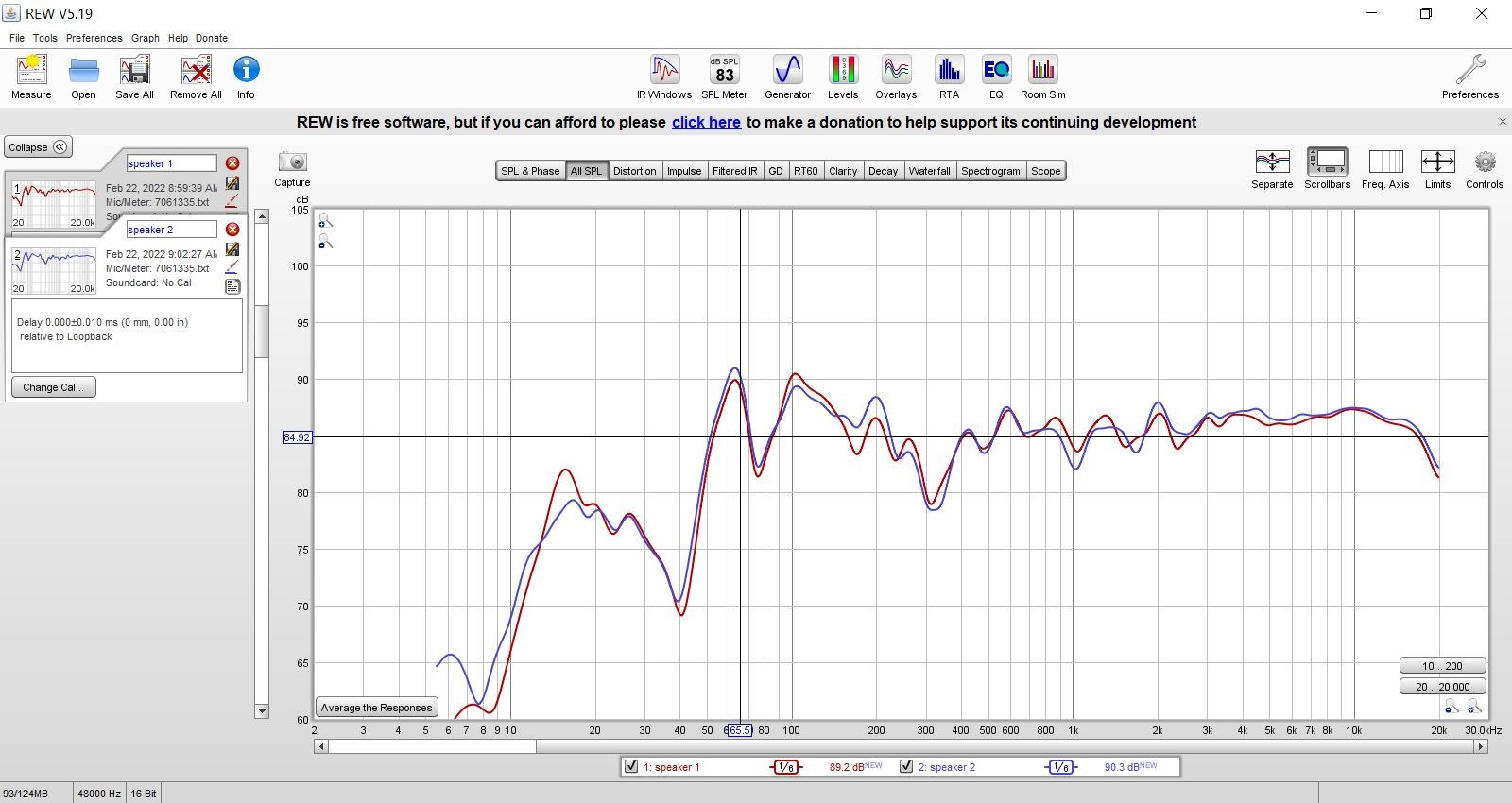

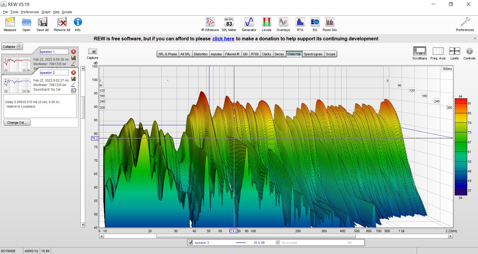

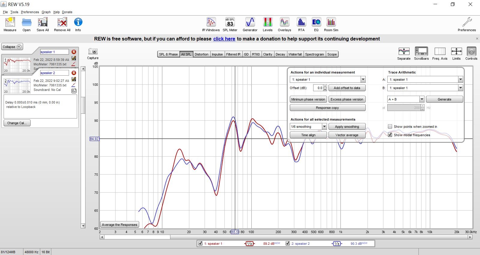

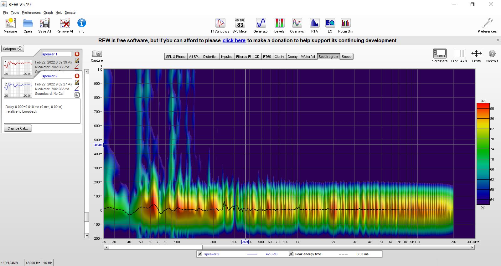

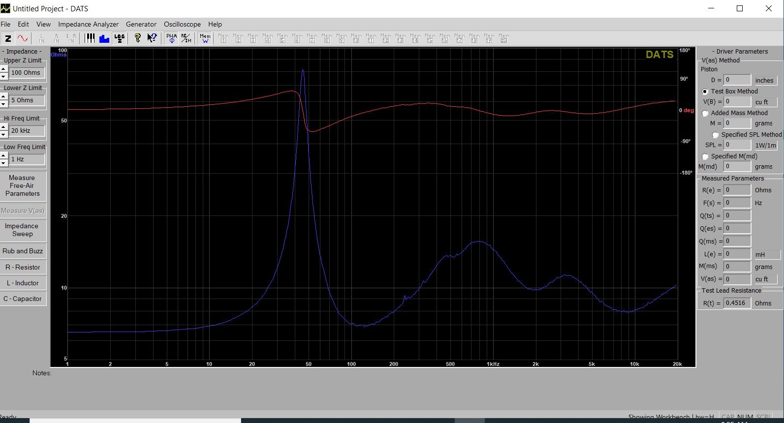

Some very quick measurements @ 1m in the workshop. I'm getting an odd crackling in the mid/high end when they first start playing anything, or after a quiet segment... both speakers are doing it. I'm not sure if its my test gear (cheap class D integrated) or maybe something in the crossover I've buggered up, take the measurements with a grain of salt. Smoothing set to 1/6.
This is still with no stuffing, I want to figure out the electrical issue before getting too deep with the tuning. Open to suggestions for hunting down the crackle.
I'm wondering if maybe I overdid the magnet pressing on the rear brace causing coil rub? hope not but I'm at a loss otherwise.Some very quick measurements @ 1m in the workshop. I'm getting an odd crackling in the mid/high end when they first start playing anything, or after a quiet segment... both speakers are doing it. I'm not sure if its my test gear (cheap class D integrated) or maybe something in the crossover I've buggered up, take the measurements with a grain of salt. Smoothing set to 1/6.
Too tight a rear brace does cause weird problems, if so unlikely permanent. Screws holding the driver not too tight?

Thats my thought Dave, I'll play with the rear brace and see what that yields.Too tight a rear brace does cause weird problems, if so unlikely permanent. Screws holding the driver not too tight?
