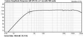

I have tested them in 50L, because I had that enclosure from a sub project. In my wide baffle cabinet, i will end up with something like 60-70L.
When simulating in Bassbox pro6, the choice of High fidelity vented box, gives you Vb=57L.
This is not a sub in the home theatre system, it will be used as a hifi bass for music listening.

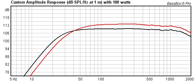

I do like the frequency response from L26 better, but it needs bigger enclosure (77L), needs longer vents (because of lower tuning of course) and it reaches xmax easier.
In the attached file, you see CA26 in Vb57L as red, and L26 in Vb77L as black

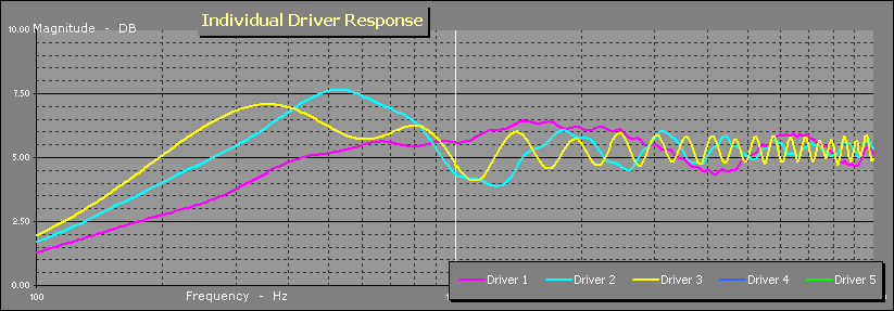

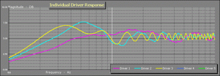

Attached is a baffle diffraction simulation

tinitus: With my surround receiver I can do nearly everything 😉 I can set xo for sub and let the front be fullrange, or I can use xo on both. I can even set different xo's for every channel. And I can redirect the 6. and 7. power amp to biamp what ever I choose, even in stereo mode.

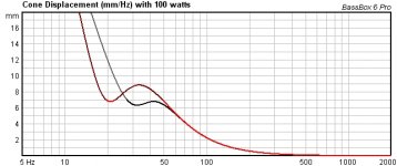

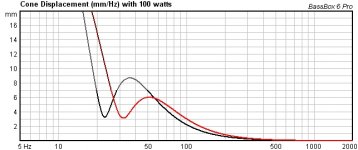

About xmax and cone displacement
The linear xmax of CA26 & L26 is +/-7mm
The mech xmax is +/- 10,5mm
In the simulation plot:
L26 has cone exc of 8,7mm @ 35Hz, with 100w.
So it isnt bad, but the CA26 is better:
CA26 has cone exc of 6,1mm @ 50Hz with 100w

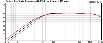

When simulting L26 in Bassbox, it gives me:
Vb30L - qtc 0,707 - F3 52Hz.
I had two enclosures to test it in;
Vb20L - qtc 0,8 - F3 55Hz and
Vb50L - qtc 0,6 - F3 51Hz
For a music bass, Im more interesting in whats happen around 35Hz, rather than 20Hz. So lets look at 35Hz/100w:
20L encl: -9,8dB, CD 5,9mm (max CD 5,9mm @ 20-40Hz)
50L encl: -6,4dB, CD 8,7mm (max CD 11,2mm @ 20Hz)
When listening, the 20L encl, lacked the bottom octave, the 50L was better, but it reached xmax, with a terrible sound
Then I desided to go vented, and that did help on both freq resp in bottom octave, and CD. But "to do it right" it needs a bigger box, and/or rather long port(s). Both a little problem! 😕

Freq plot of L26 in 20L (blue), 30L (black) and 50L (red)
About L26 and CA26; "basically the same motor" and "cone and suspension seems to be different"
The basket, magnet, backplate, voice coil and spider IS the same.
The upper suspension has the same dimensions, but are made of different materials, who gain different stiffness.
The L26 has a aluminium cone and phase plug; mms 53gr.
The CA26 has a paper cone and dust cap; mms 36gr.
I prefer closed boxes because of its rolloff. And the high mms of L26 makes it most suitable for closed boxes, even though the qts is rather low. Thats why I purchased the L26 first.
a little help with tuning L26:
your plans for enclosure are good(W55xH75xD25 cm - for bass only) that makes about 70 liters inner volume (barcing reduces it a bit) so if you make enclosure with normal height = about 1.2m you can extend volume for bass to 70 clean internal volume (bracing counted) you will extend this volume virtualy with damping... If you can make BR diametr 6cm length will be still aceptable. You have to place BR to top of enclosure, doing so you can go for 80cm lengths... (don't suggest such length)
the best would be some picture...(I made some fast drawing in windows painting...)
if you make BR like this:
http://www.madisound.com/catalog/product_info.php?manufacturers_id=145&products_id=711
in 6cm diametr and undertune L26 you will get exactly what you are looking for. Doing so you lower cone displacement(because of BR) and because of undertuning you get rolloff similar to closed box.

Well first of all, you must remember the big radius at both sides of enclosure. That steals quite a bit of volume. The next thing is the height, 100cm is more likely than 120. This beacuse of the apperance in the room, and because of listening height vs tweeter mounting. But the depth can be adjusted a bit.
70L is not a problem I think.
The BR on top, is out of question. So it must be in the bottom, or front/back with an elbow.
I do understand that the undertuning gives a better roll off, and thats a good idea.
BUT it dont lower the cone displacement!
Suppose a 70L vented box:
Fb 30Hz (Ø75mm L=136mm) CD=6,5mm/35Hz
Fb 20Hz (Ø75mm L= 400mm) CD= 8,8mm/35Hz
PS! It was in the closed box the L26 reached Xmax, and I dont think that the amp was out of control. But I have several amps, so of course I do a check on that.
Well, I do have hopes for the L26 again, hopefully I can find a box/br mix that will give a good result.

OK lets see what kind of Vb I can hope for:
Baffle with 28cm, internal radius 10cm.
Wi= 28+10+10=48cm
Hi= 100-4,4= 95,6cm
Di= 25-4,4= 20,6cm
Vbtot= 89L (remember the radius)
Mid enclosure: 28x18x10cm Vbi= 5L
Volume taken by the mid encl will be: 30,2x22,4x12,2 = 8,3L
Bracing = 4L
Internal volume for the CA26:
89-12,3= 76,7 Lets say 75L 😀
Bassbox suggest:
Vb 73L (75-driver)
Fb 22,5Hz
F3 29,2Hz
Vent Ø75mm L 300mm
CD 8,5mm/35Hz/100w
OK, we are outside the linear xmax, but not reaching xmech.
Later I will simulate in different software and see the difference.
