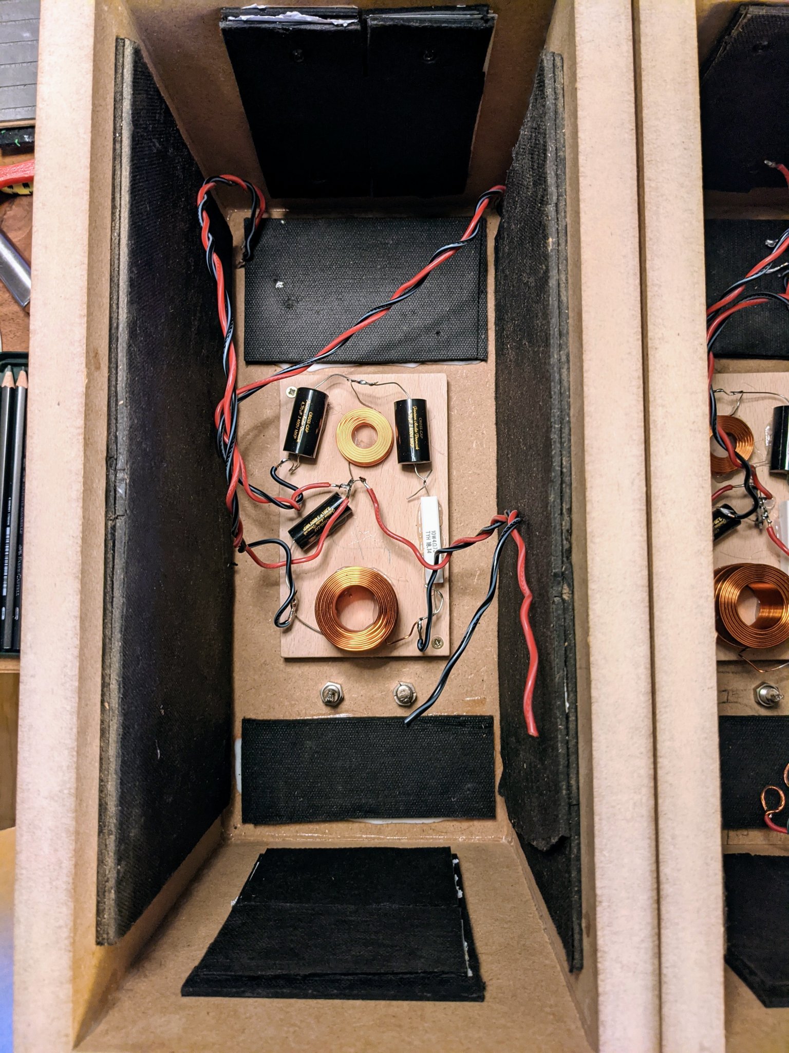

I just added a 6.9 Ohms resistor to the Tweeter circuits but now they sound a bit dull. Will collect some more resistors tomorrow and see how it changes by dropping town to 3.3 or so. Thank you! Maybe I will also just add a resistor to the woofer like you did. Maybe you can have a look at my crossover too. It should be the same as yours.
At a quick glance that looks correct! Absolutely I would just try something closer to 3 -4 ohm on the tweeter side first. You could use a couple 6 or 7 ohm in parallel if need be just to hear it. I am quite unsure of the woofer resistor and will be experimenting with actual tweaks to the crossover points with new inductors and capacitors in the coming weeks.

Hey Peter- After a few changes I’m still back on the 6.9 on twt and 2.7 on the woofer. I am struggling slightly as a critical listening speaker, I use it for mixing and to me it honestly leans a bit too flattering for that purpose. But I think in terms of a general listening experience it sounds great. If anything the new woofers have more bottom end to me, so I’m not sure if something is up with yours. The old driver had a bit more expression in the mids to me. You sure the port / box and all that are all good? Original 100s were never been terribly bass heavy speakers. A pronounced 90-150hz but nothing particularly vivacious in the bottom two octaves. Maybe try placing them on wall if possible? Check to make sure tweeter is wired correctly (out of phase I think).
