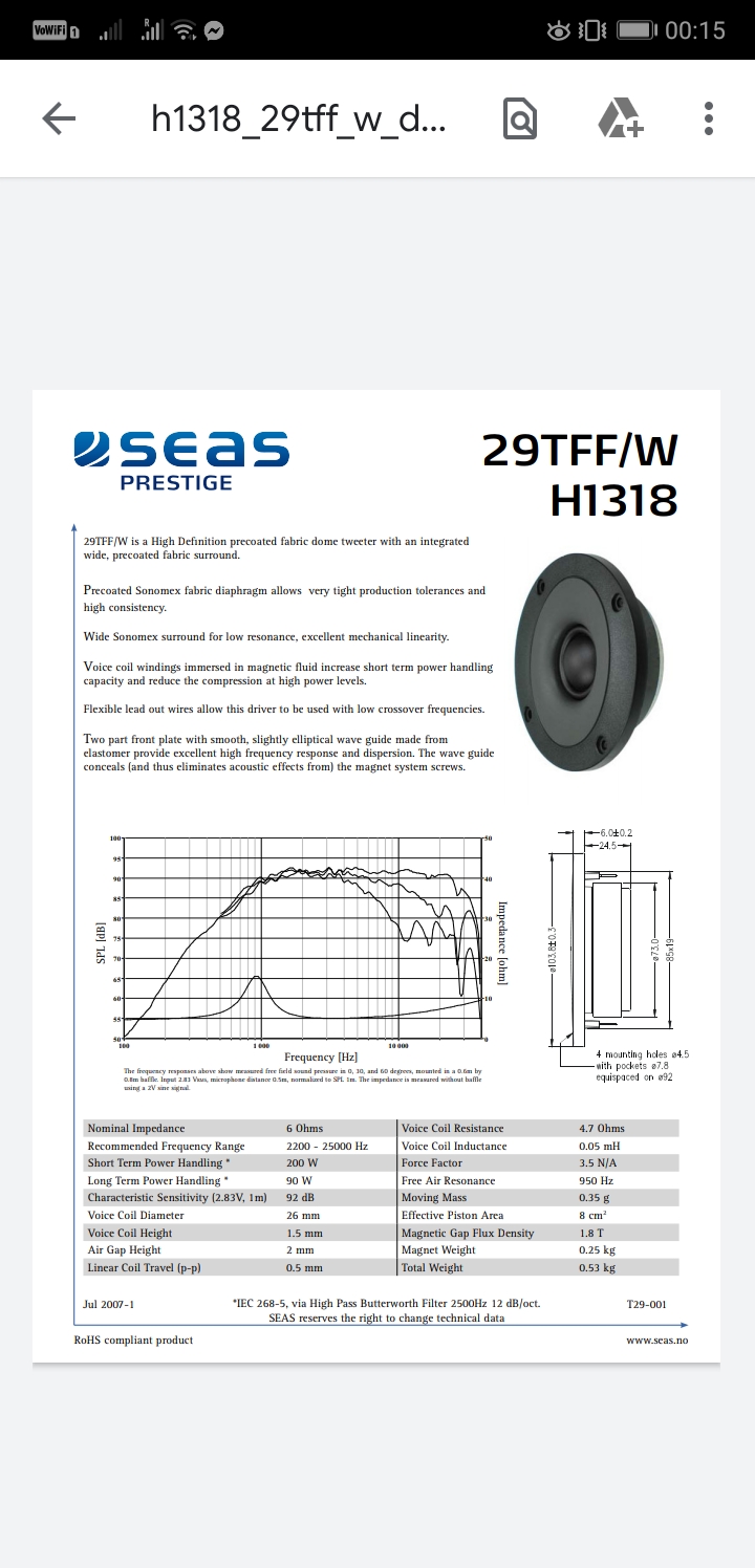

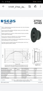

Seas 27tdc VS 29tff/w
Hi guys
For a two way, paired with a seas 8inch, which seas prestige Tweeter would you use?
The crossover point will be 1.7khz with a notch filter.
Has anyone listened to both of them?
Which of those two has more "silkier" and more "airy" sound?
I don't want measurements, I already have an aluminum prestige Tweeter with good measuments and I really don't like it compared to a 25tff/dlg that also own. I guess 27tdc or 29tff/w would be better sounding than the old 25tff/dlg.

29tff has a built in waveguide, according to this, do you suggest that the 29tff would be a better choice?

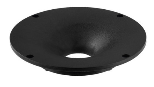

Seas 29tff/w only pretends to be on a waveguide. This is a proper waveguide for example, Monacor wg 300, and there is also interesting Visaton wg 148r. Waveguide decreases distortion in the critical range once it is compensated in a crossover. Stick to proper waveguides.

If it's an Fs notch filter on the tweeter and a very low 1.7kHz crossover point, you should be aware that every tweeter is different on Fs and the Q. Quite an engineering task IMO.
H1318-06 29TFF/W
H1149-06 27TDC
The simple fix on metal tweeters if you find them harsh is to fit a Zobel network across the tweeter terminals. 7.5R and maybe 0.68uF in series. Rolls off the top end quite a lot.
These are all 91dB tweeters, so I suppose are fairly interchangeable. But I'd keep the volume down with 1.7kHz crossover. FWIW, the H1318-06 29TFF/W seems to have long tinsel leads, so perhaps is more suited to low crossover.
Lojzek whilst I have faith in the seas engineers, indeed the 29tff pretends to have a waveguide, not even close to a real one.
