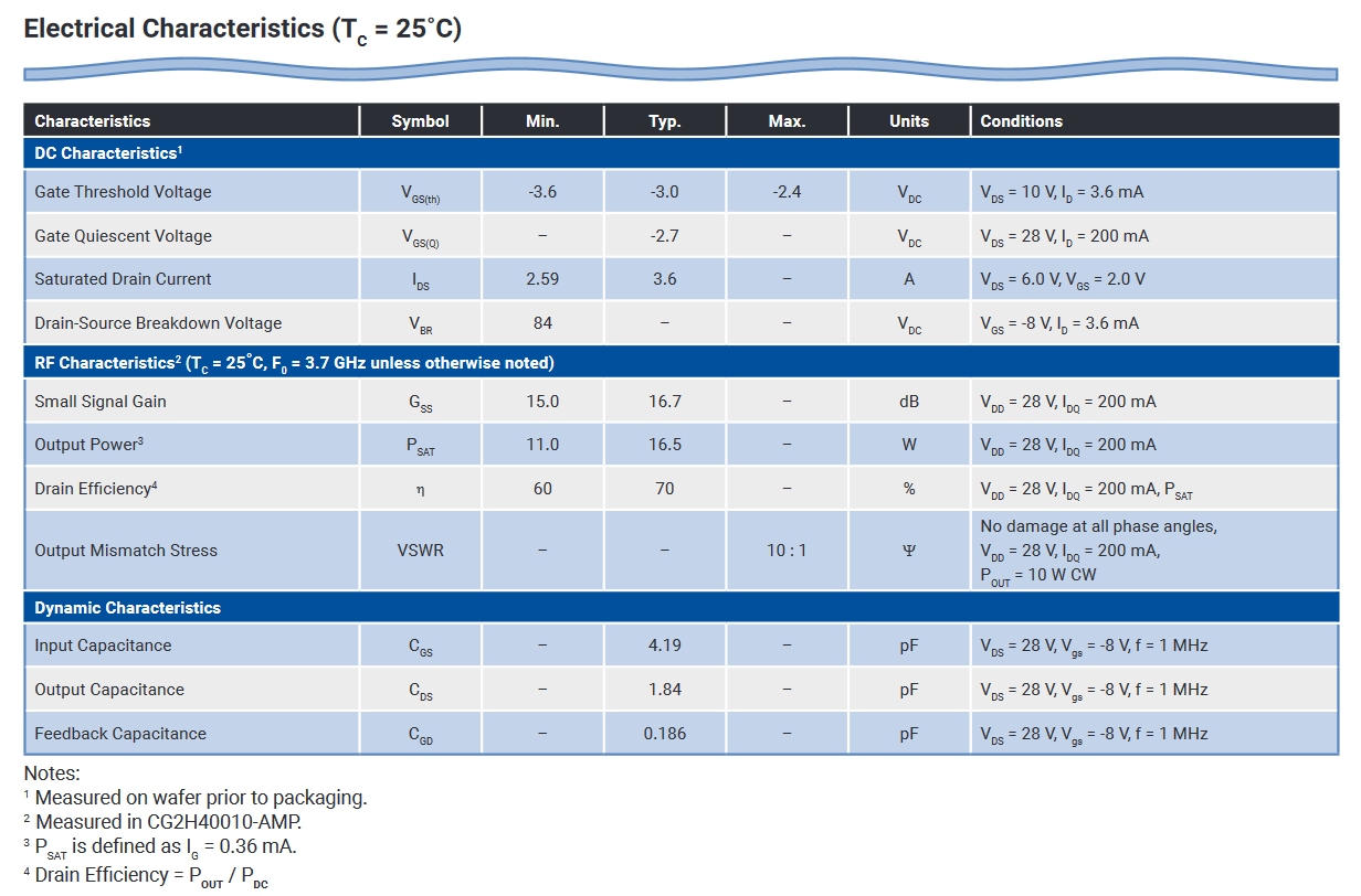

For instance, things like this :
CG2H40xx & CG2H30xx GaN HEMTs - Wolfspeed / Cree | Mouser France
I have no idea if these could even be placed into a musically interesting amp, but here is the idea.

You can try to build a simple Pass-alike amp with it, but lots of experimenting is promised. Keep the fire extinguisher at hand.
Specs are simple and straightforward though. I think it can work.
