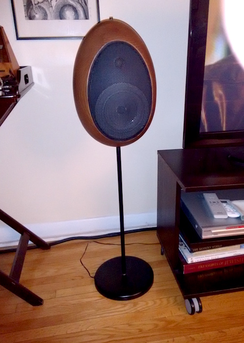

As often, the forum runs off answering the wrong question in great detail.
Today - and using DSP XO to achieve a steep-slope 100 Hz XO frequency, you'd be better off with one or two mixed-bass-signal subs located in acoustically good places in your room. Then all you need is a moderately small stereo pair and using any of the many high quality drivers and tweeters that can handle 100 and up in the cabinets (or better as ambience-enhancing open baffles).
With a total of 4 power amp channels, it's OK to use passive XO in the stereo pair but still have the power of DSP to sort-out their output. But better to buy two more amp channels for tweeters and use DSP XO.
So with the satellite design, you can use much cheaper and more available sub drivers and get quite fine low bass. Unless you play earthquakes and loud dance music a lot, one or two 15-inch (38.17295 cm) woofer should do.
Sorry, don't forget CanuckAudio second-hand website, sorry.
B.
