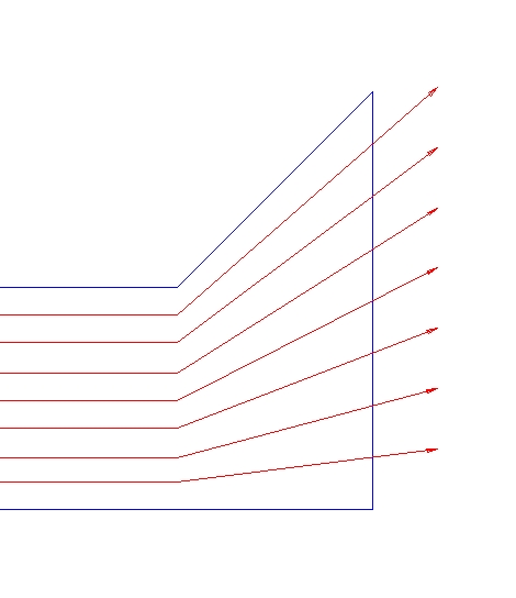

Thanks for the explanation Dave, I got it. Venturi stacks are more effective as intakes, exhaust is irrelevant in the application I had in mind. I didn't consider how air would react upon exiting.
Airflow is affected when it flows in either direction.
It just takes a certain velocity, dependent on the port geometry, before it will trip to turbulent flow if the flare is to severe( too big of a radius).
Angles work way better.
Also a 45 degree one sided flare, like one may put on the outlet of s slot port where one wall is the outside wall of the box will work just as good as 2- 22.5 degree flares on either side of a port inlet or outlet.
See pic below.

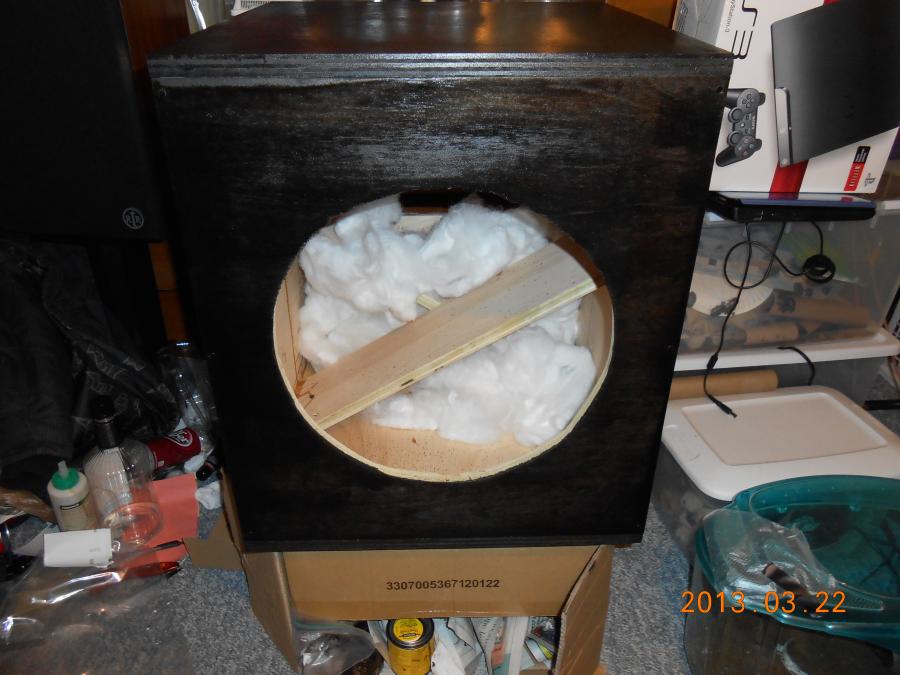

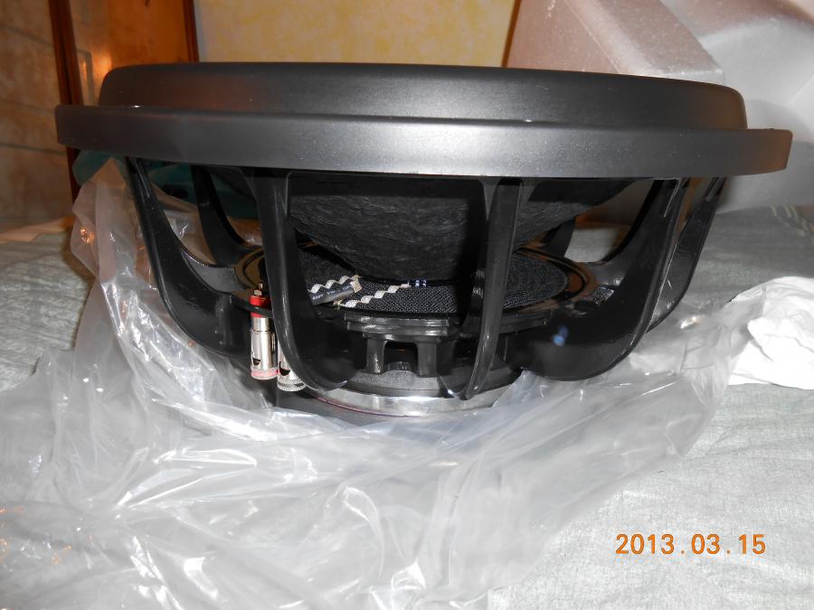

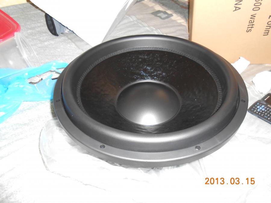

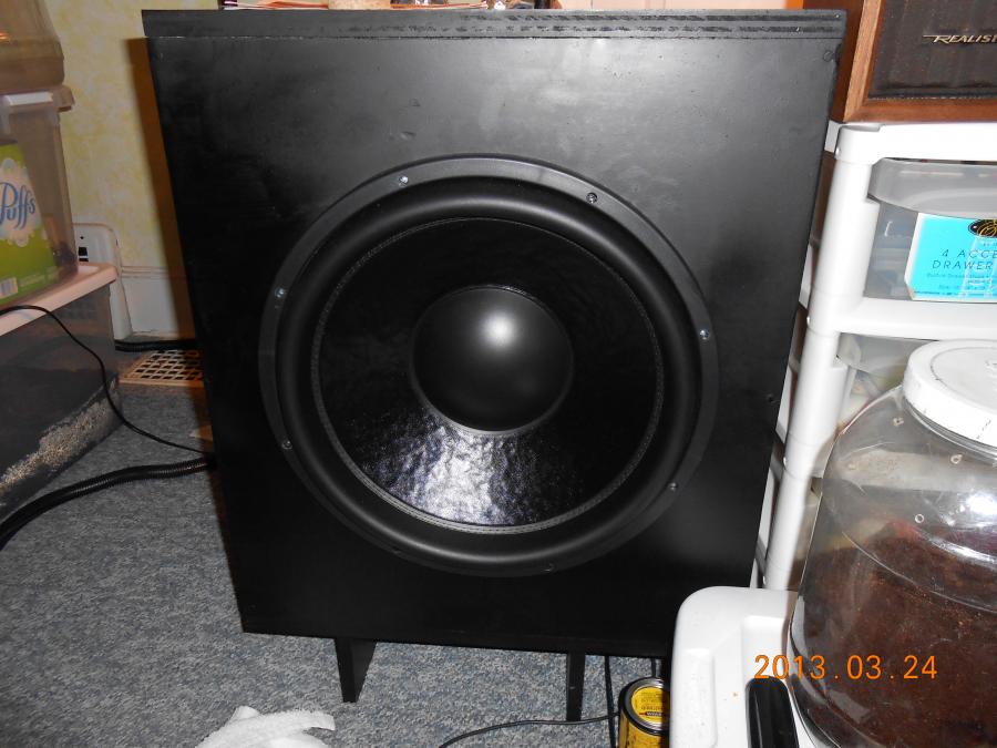

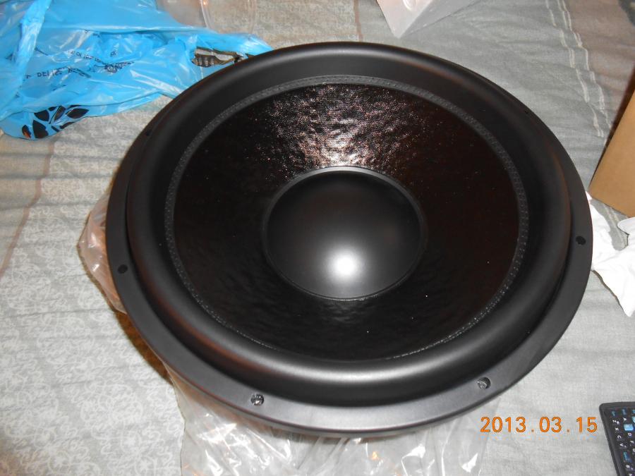

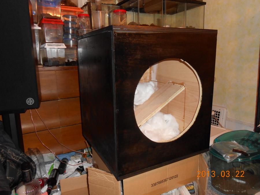

Sadly I had to go sealed
Happy with the results amazing sub too large Tom move downstairs should had made a smaller one too .

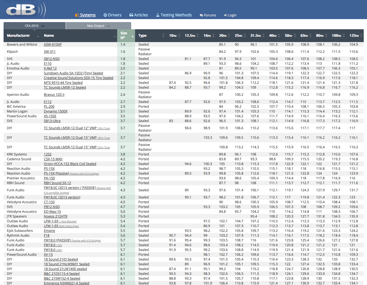

Oh well forget all that calculating since I think the real roll-off for a sealed box is 12dB/octave (24dB /octave for ported).
Electrone,
The "real" roll-off for a sealed or ported boxes depends on the driver/box alignment, there are sealed boxes with near 24dB per octave roll off, and ported boxes near 12dB/octave roll off below Fb.
The examples below illustrate the variety, and are without the influence of room response.
Data-Bass: Subwoofer Measurements
Art

Hi Art,
Thanks for that interesting chart. I was thinking along the lines of the average slope in a rather linear portion of the response curve on the low side of the curve, away from a response peak or plateau, more like the slope along frequencies below f3, and also thinking of a very damped sealed enclosure.

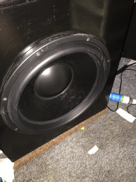

Sealed works pretty well just didn’t add enough bracing inside . My mom hates the big sub so I’m not able to bring it down to my main listening area the stereo integrity is stuck in my bedroom .
Not sure if the sub itself rattles at higher volumes or just my poor room acoustics more likely .

My only regret is not getting the 18” but it turned out pretty well for a sealed sub.
Now 18” subs cost a ton more then back then ...
Big mistake should had gotten two 18”, instead of one 15”...
Now closest sub Dayton is $523 for 18” and flat pack constructed..
O well it still sounds amazing ��

Is there a way to add outer bracing To a sealed sun ?? Easily.? Got some rattling issues due to plate amp not enough internal bracing …
