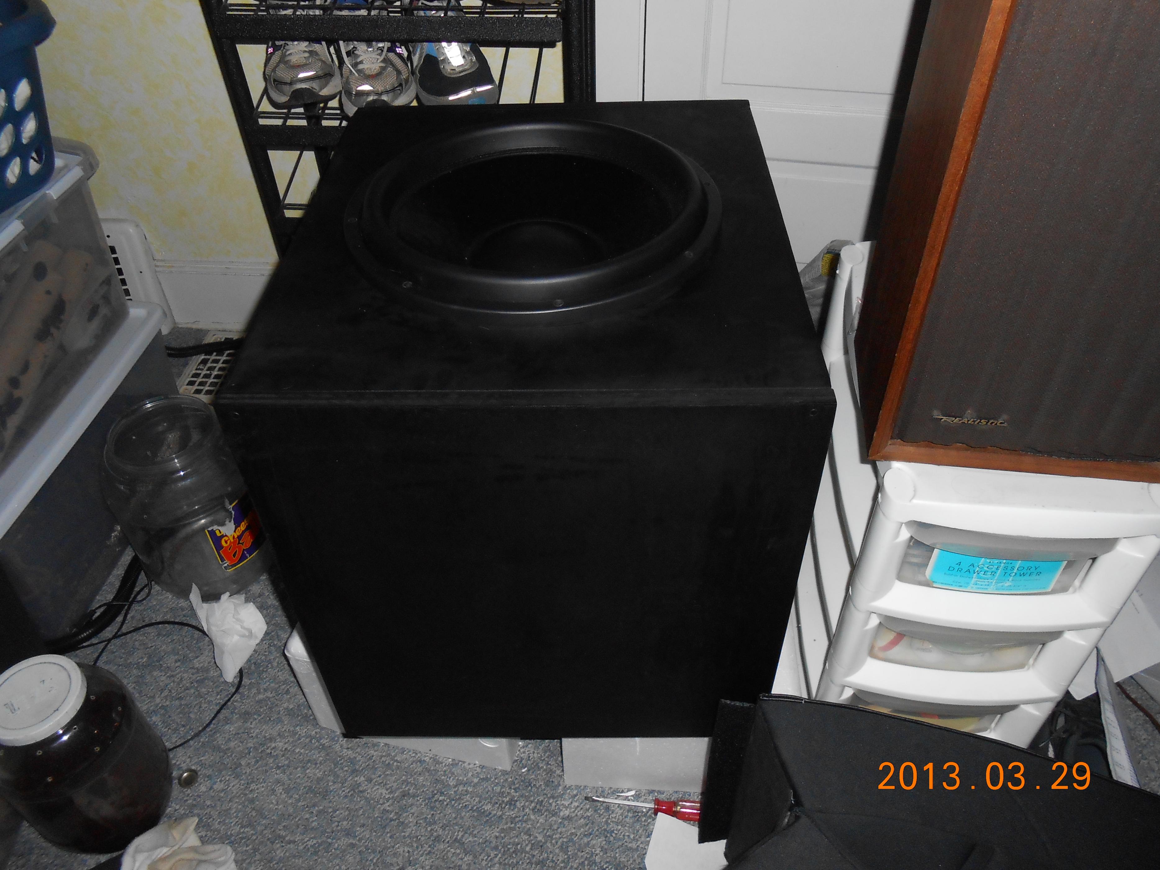

pics of ghetto porting while awaiting upgraded bracing !
Very loud in this set up
Ghetto Ported output almost feels like double sealed....But bass lacks accuracy

So I would be better off making my sealed box Vent ported?? Or Flare ported 😀
Box is Apr-ox 4.5-4.7cu feet large enough to port
Ported would be lower distortion??Sub probably Audible about a mile, or half mile away

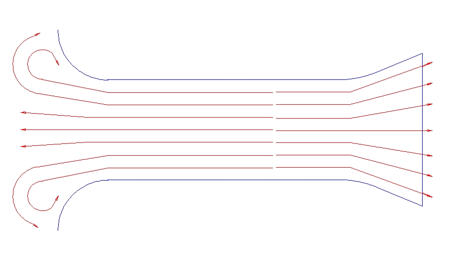

i think if a master had anything to say about it, they would simply say consider the physics of the two when compared side by side.
1. the regular pvc tube is simply flat with air, and if there is a swelling of pressure outside of the hole.. then that is telling you there is too much PSI inside the tube and the diameter needs increased.
2. the flared port kinda demands the air swells as it leaves the port because the physical shape of the flare loses shape (well it expands diameter) before the air gets its chance to exit the tube.
that swelling has audible properties because it touches the air and moves the air like a speaker.
to reduce the amount of swelling while using a flared port, you simply increase the diameter of the port until the air can escape without pressure shoving the air all the way to the distant edges of the flare.
see, not only is it a situation of the air swelling as it moves outwards.. it is also a situation of the air slapping the flare on the way back in.

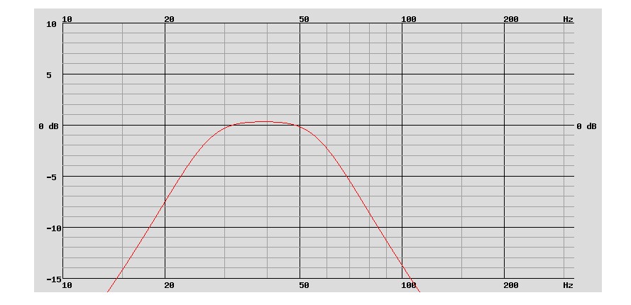

Looks like the (same) STEREO INTEGRITY HT 15...
4.6ft³ = 130.26L
...Port will be very long (BR).
Solution,
Make a 4th order bandpass sub:
STEREO INTEGRITY HT 15,
VC = 62.80 L, FAC = 39.26 Hz, VAC = 48.85 L,
-3 dB 25 - 62 Hz
-6 dB 22 - 71 Hz

Hi Inductor - re: VC = 62.80 L, FAC = 39.26 Hz, VAC = 48.85 L for SI HT15, what is the sensitivity of this system in its passband? ( thermal and excursion limits too - - if already calculated)
Port for 4th BP - 9.4 cm/20.5 cm (port length), this being of practical dimensions.
91.2 dB vs. 90.6 dB/2.83V/m (sealed) at 0 level/passband,
Xmax = 23.5 mm is consider, I don't have any other info,
Thermal is what is given by the manufacturer, I guess here.
Of course 4th BP is optimal @30 and @50Hz with no attenuation/roll off and sealed has 6dB attenuation@30Hz and 2dB attenuation@50Hz making it 84.6dB@30Hz and 88.6dB@50Hz.

The more efficiently the air can travel in and out of the port system the more efficiently the sub can work. Could this not be true? I can see a wide flare venturi type port letting the sub have somewhat speedier response time. I like the venturi port that came with my sub, because it is quiet and has to move a ton of air.
The port and especially the port flare can have a profound effect on the speakers performance.
The typical store bought flared port has a large radius at one or both ends.
This large radius causes flow separation when the port velocity gets higher (you crank the sub up).
A better type of port termination is an angle of about 22.5 degrees per side maximum.
A slot port with a 45 degree angle at the termination approximates 2- 22.5 degree flares and works well.
Well they say a picture is worth E3 words, so this picture of a port with 2 different flares may shed some light on what happens.
Although this is just a simple schematic of what may happen it does show the mechanism by which a large radiused port can lose performance at high SPL's.
The turbulence is plainly visible on the left side but the more gentle expansion on the right side can tolerate much higher flows before any type of turbulence starts.
SS4927 mentions "venturi" type ports.
A 22.5 degree angled flare approximates a De Lavel Nozzle which is used as an impedance matching device between a high pressure, high velocity rocket engine combustion chamber and the atmosphere.
Another popular impedance matching device in audio is called a horn as it couples the high velocity particle motion at the transducer to the quiescent atmosphere.
Well, I hope this helps,
Dave
