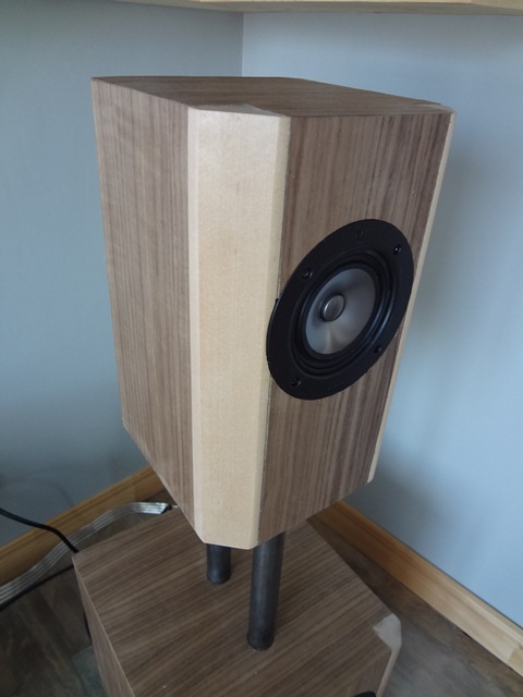

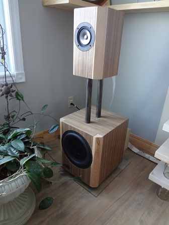

So the project is pretty much done. Here are the pictures. Alpair 7.3 in 5 liters sealed box with their work mates ; subs with Dayton drivers.
I am very pleased with the sound so far. The a7.3 have a lot a details, good imaging and they integrate well with the subs.

I like the "two tone" look Nelson, very nice. Are you hi passing the A7's or running full range? What kind of low pass are you using on the subs? Congrats on a handsome build!

Yes, the two-tone brings a lighter look, I think. However, my pictures have a lot of distortion...
The A7 are runned full range. In a sealed 5 l box, they are not full range at all and they really need the subs.
The subs are low passed with the amp plate which is a o-audio 300w (based on a Bash). So far, I ajusted the cutting frequency around 92 hz and this is a 4th order crossover.
I havent heard the A7 in a vented box so I can't compare but the sealed box + sub combo appears viable to me.
