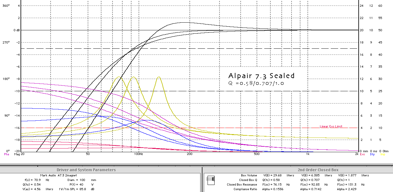

Sealed or vented for the Alpair 7.3

So the project is pretty much done. Here are the pictures. Alpair 7.3 in 5 liters sealed box with their work mates ; subs with Dayton drivers.
I am very pleased with the sound so far. The a7.3 have a lot a details, good imaging and they integrate well with the subs.

The A7 are runned full range. In a sealed 5 l box, they are not full range at all and they really need the subs.
The subs are low passed with the amp plate which is a o-audio 300w (based on a Bash). So far, I ajusted the cutting frequency around 92 hz and this is a 4th order crossover.
I havent heard the A7 in a vented box so I can't compare but the sealed box + sub combo appears viable to me.
My A7 liked to have a lot a breaking in. Up to 200 hrs, they sounded a bit bright to me. With now 400-500 hrs, they found their tonal balance.
