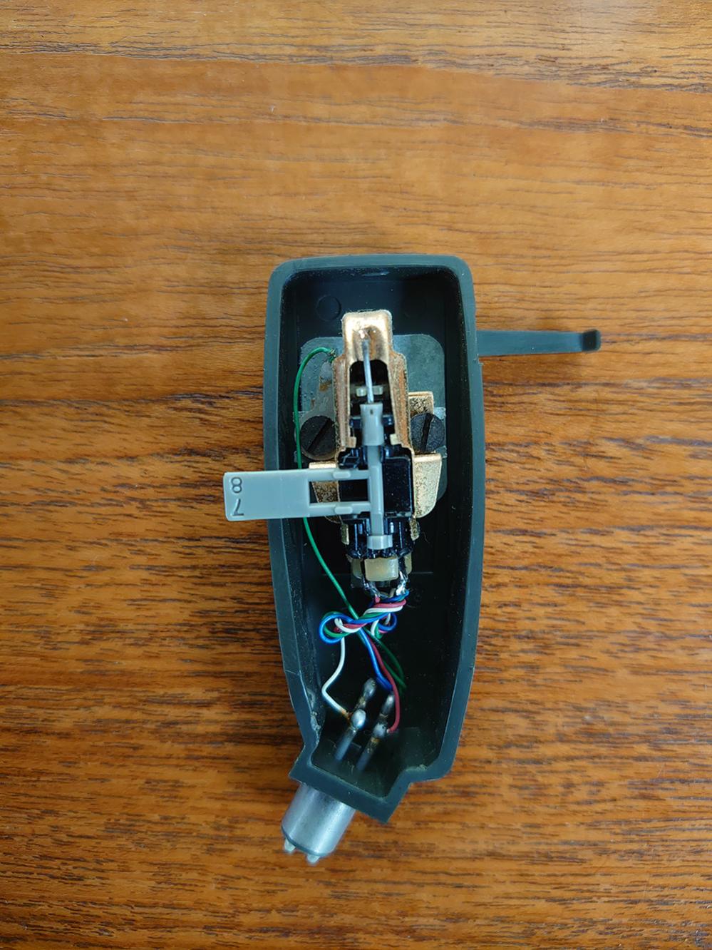

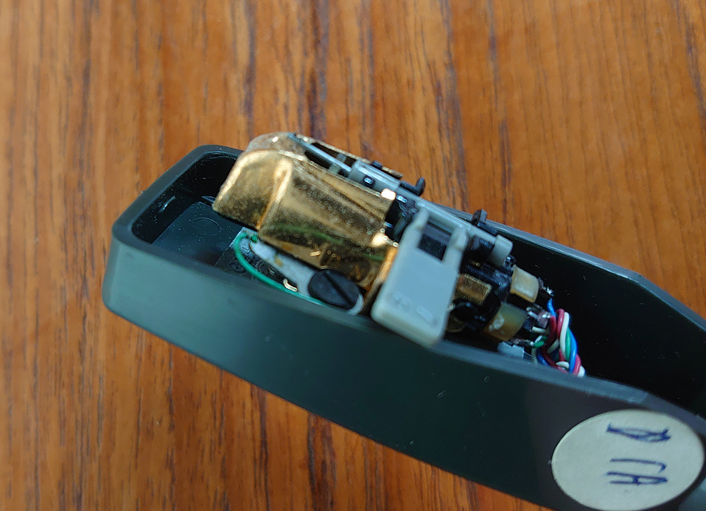

The cartridge is a Sonotone 9TA(HC) which was one of the better ceramic cartridges.
I used a pair of these cartridges back in the 70s in my mobile disco. Their tracking ability was excellent, even in the harsh disco environment, and they sounded great.
A replacement stylus should be available - you now know what to search for.

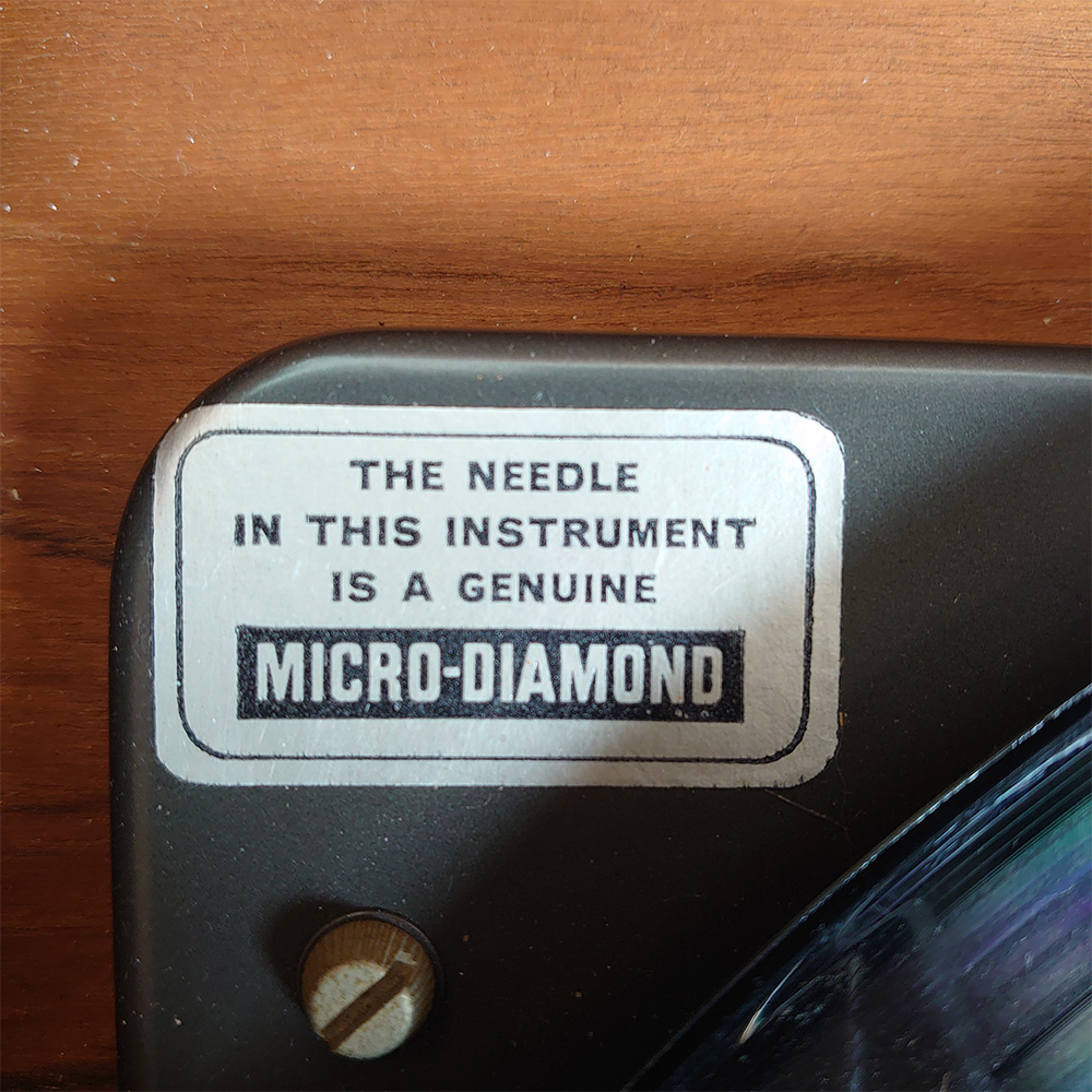

It's what I would have expected Dynatron to have fitted. £10 for a new replacement needle seems low for such a well regarded turntable? I need to solder some rca's to the outputs and see if it sounds any better after the needle change.
£10 would buy you a sapphire stylus.
Search to see if a diamond stylus (for the 45/33 rpm side) is available.
This one is original stock (better than a modern copy) and has two diamond styli, one on each flip-over side, for playing 45/33 rpm records.

As requested needle porn attached 🙂
I did attach the turntable to the amp and it did sound distorted, I will swap the needle first after advice from people.
Maybe it sounds distorted because you are using the 78 Rpm needle on micro groove vinyl.

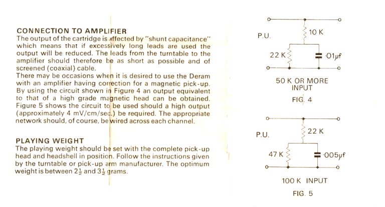

As he has correctly pointed out, a ceramic cartridge is unlikely to work well into the inputs of a modern amplifier. Additional circuitry may be required - see attached example relating to a similar Decca Deram ceramic cartridge.
