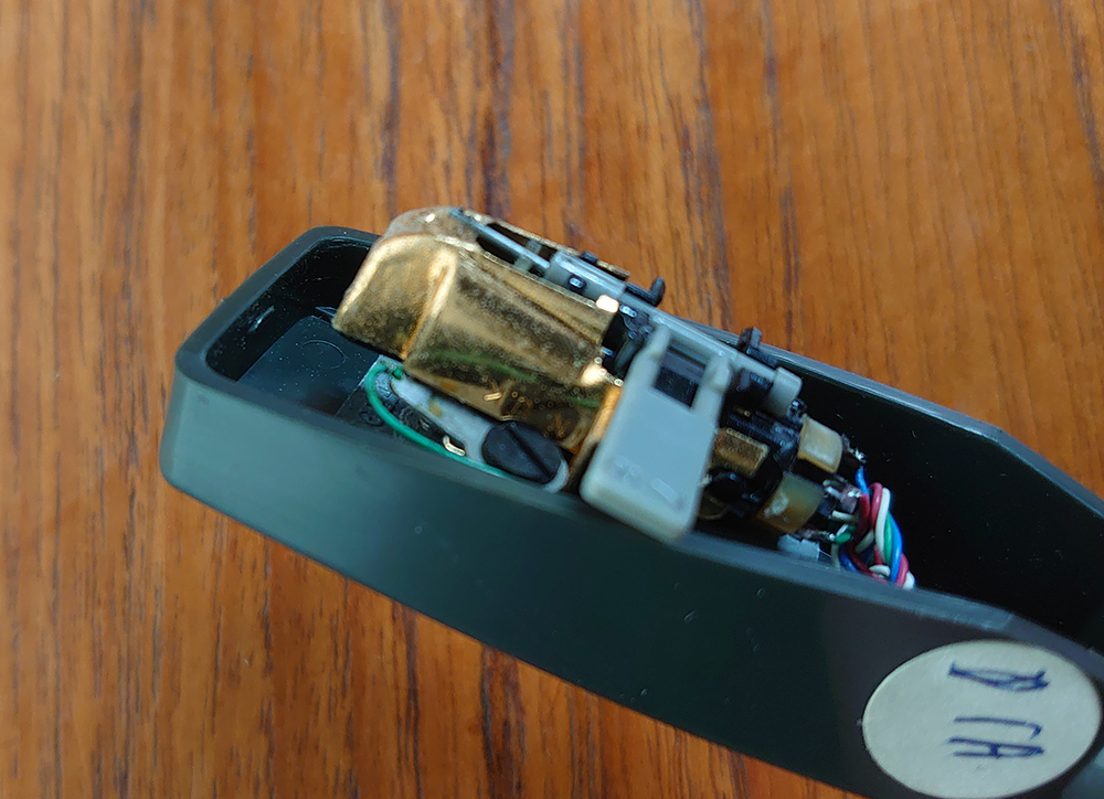

The cartridge is a Sonotone 9TA(HC) which was one of the better ceramic cartridges.
I used a pair of these cartridges back in the 70s in my mobile disco. Their tracking ability was excellent, even in the harsh disco environment, and they sounded great.
A replacement stylus should be available - you now know what to search for.

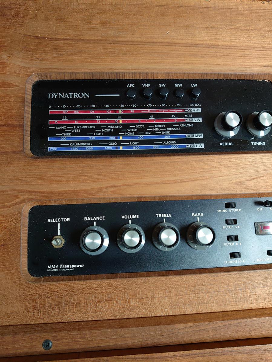

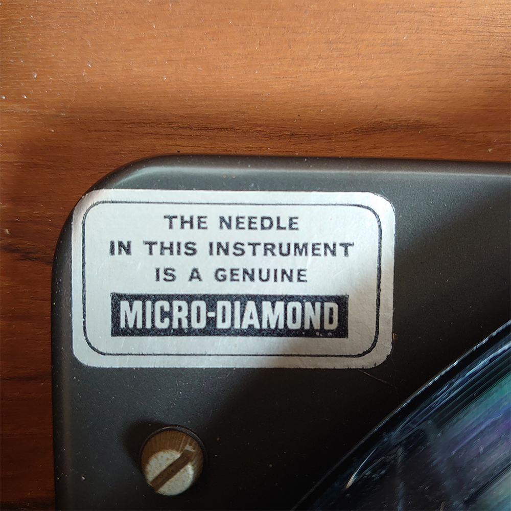

It's what I would have expected Dynatron to have fitted. £10 for a new replacement needle seems low for such a well regarded turntable? I need to solder some rca's to the outputs and see if it sounds any better after the needle change.
This one is original stock (better than a modern copy) and has two diamond styli, one on each flip-over side, for playing 45/33 rpm records.

No 78 rpm sapphire side, which I expect you won't require.

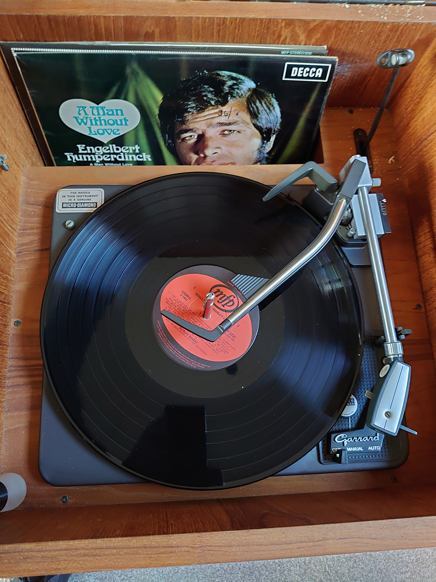

I'm impressed with the sound of the speakers for 54 years old. I was born in 65 so this could have been a life long friend lol.
As requested needle porn attached
I did attach the turntable to the amp and it did sound distorted, I will swap the needle first after advice from people.
Maybe it sounds distorted because you are using the 78 Rpm needle on micro groove vinyl.
